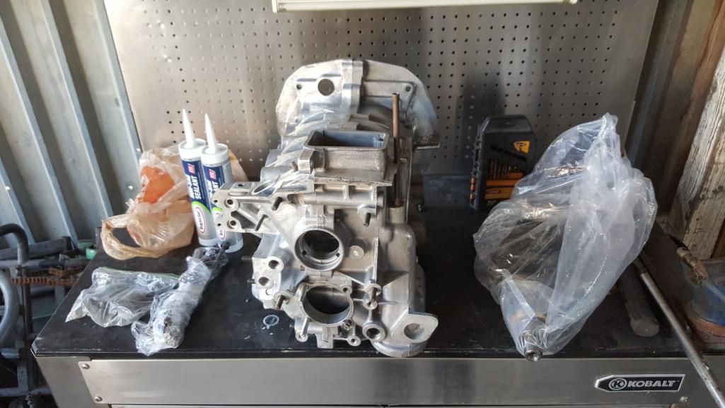

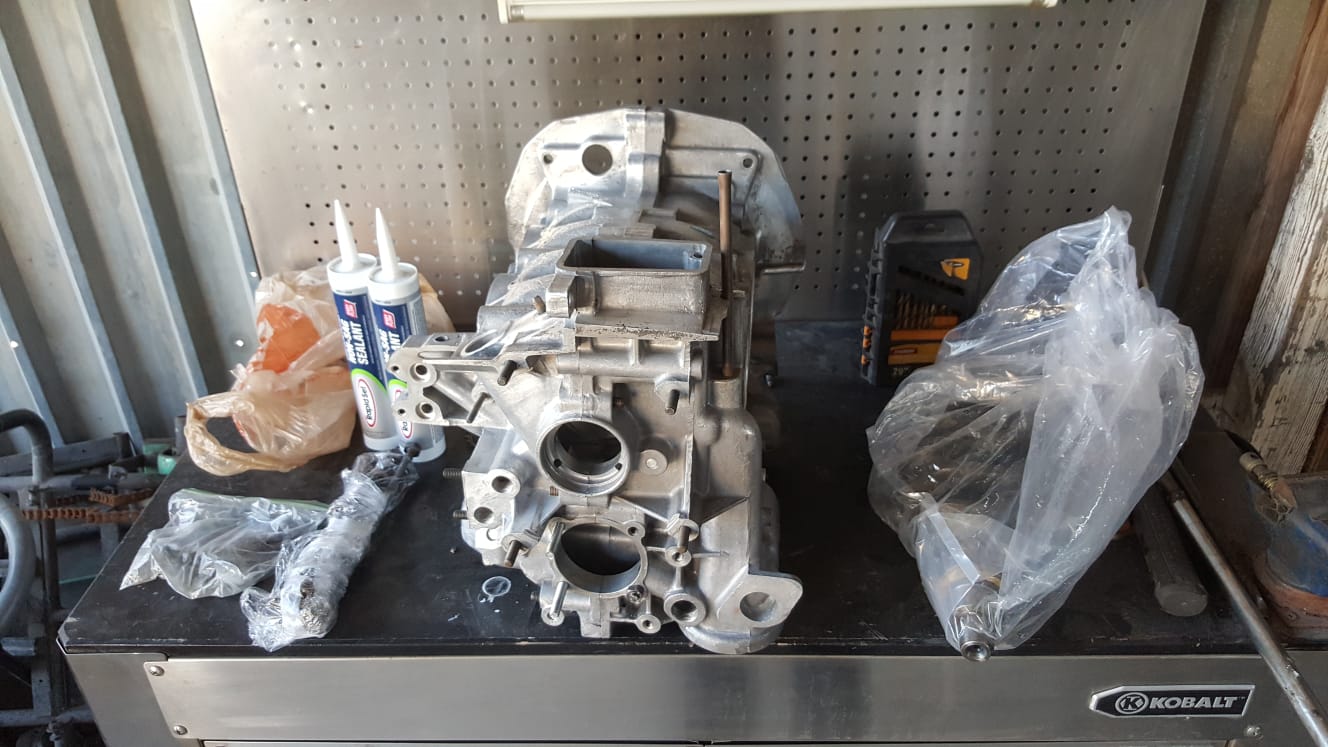

So last week I went down to European Motor Works to pick up my engine case, heads, crankshaft and all my other parts that Jorge was very kind to fix for me. I want to say thanks to Jorge and his crew, they did an awesome job. Here is a list of what they did:
Align Bore
Drill and tap the oil galley holes
Deck the Case
Regrind 2.0 Crank
Rebuild and Balance 2.0 Rods
Surface and CC'd Heads
Set it up on the bench to do a final clean and hopefully start putting it back together next week.

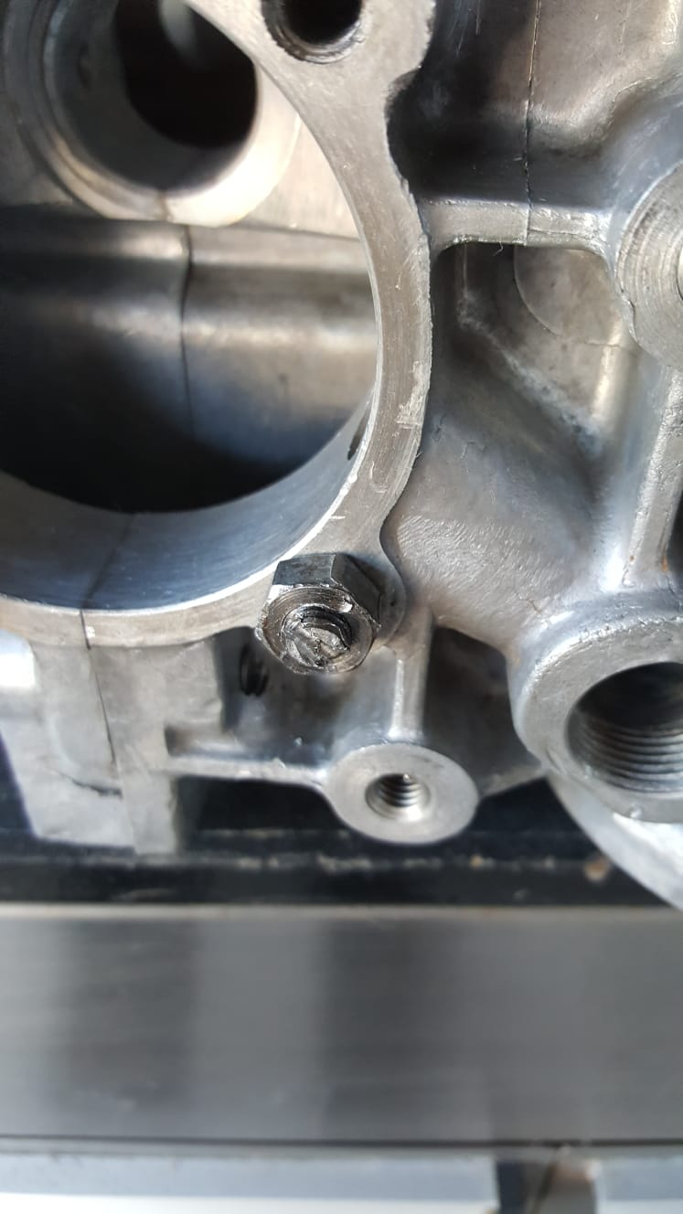

Jorge also gave me a modified type 1 oil pump but there is always that one fastener that doesn't want to cooperate (IMG:style_emoticons/default/headbang.gif)
