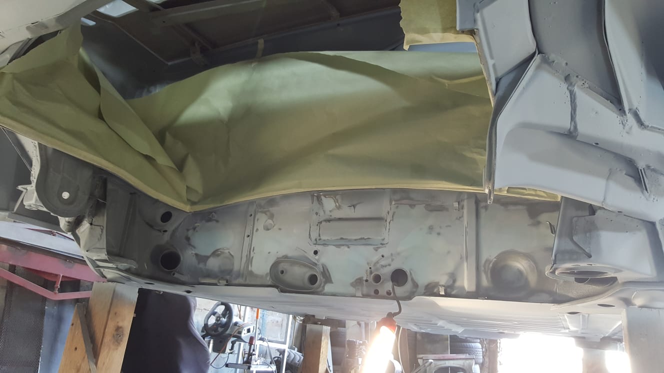

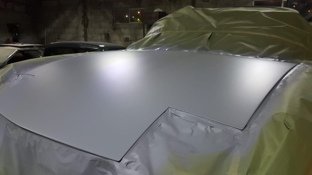

Not too much to show this week but I did get a few things done. I blocked the hood and sprayed some more primer on it. I think after this second round of blocking it should be really good. Also got a little bit of work done on the firewall, for some reason it had some small dents that were bothering me so I decided to fix them also.

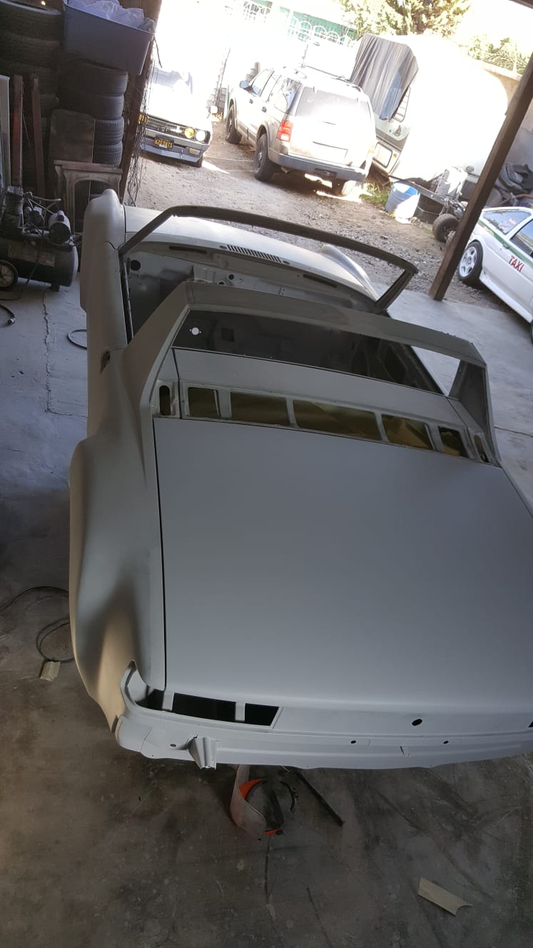

autopro   Lots of bodywork has been going on, here are some ...   Oct 20 2021, 10:19 AM
autopro   Got it back to my shop, hopefully I won't have...   Oct 20 2021, 10:43 AM
autopro   I still had to take care of some details for the f...   Oct 20 2021, 11:01 AM
autopro   Finished first round of guide coat and blocking an...   Oct 21 2021, 11:39 AM

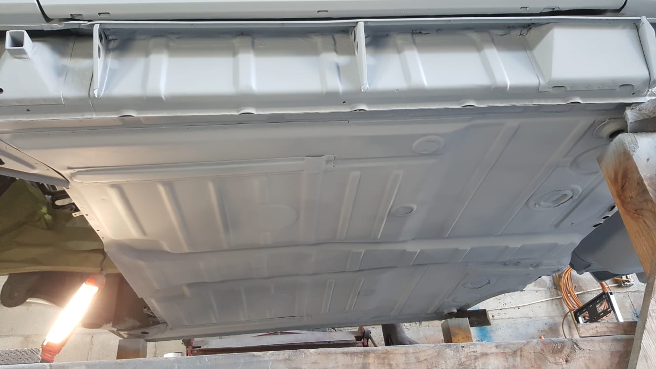

autopro   Underside of the car is now finished, just waiting...   Oct 22 2021, 12:24 PM
