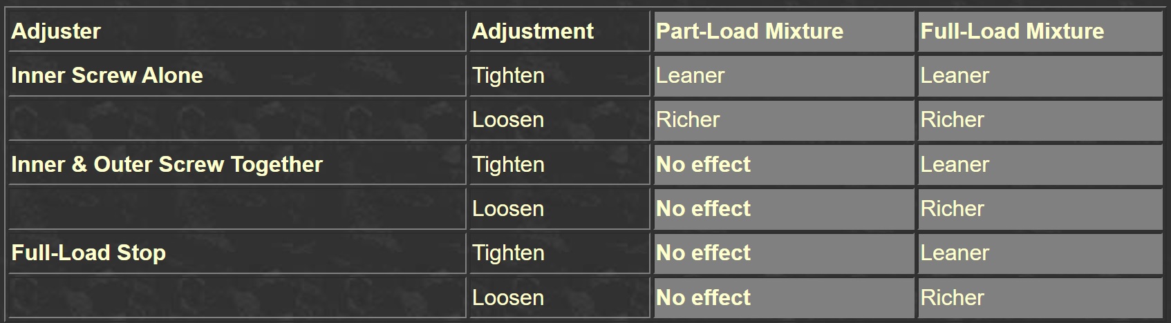

I would see if I can do all the necessary tuning without touching the outer screw.
emerygt350
post Nov 9 2021, 10:48 AM
Posts: 3,021
Joined: 20-July 21
From: Upstate, NY
Member No.: 25,740
QUOTE(ChrisFoley @ Nov 9 2021, 11:44 AM) *
Got it. Do you think pbanders table is useful?
