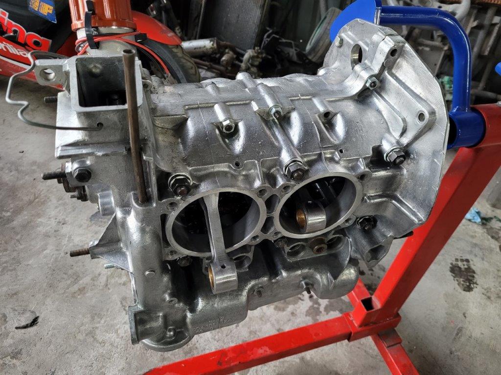

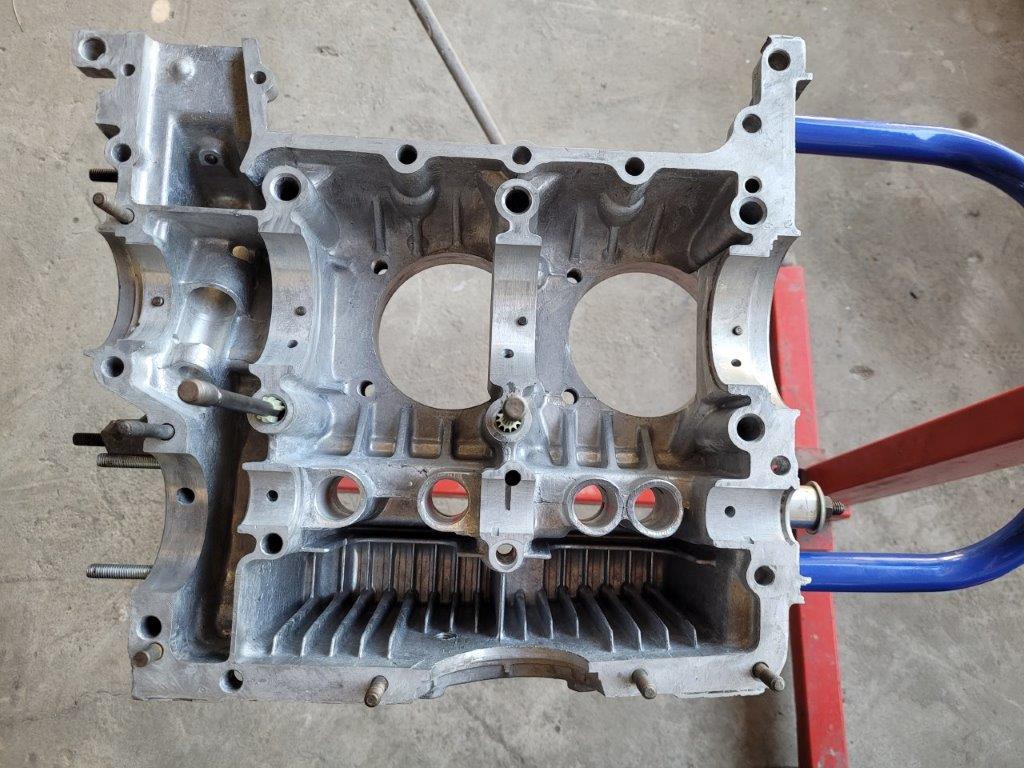

Had a productive day yesterday, I was able to get most of my engine assembly complete. Everything went smoothly thanks to the great work from European Motor Works. Assembly was made easier thanks to all the great resources here and the videos from Ian Karr, thank you for putting out such great content (IMG:style_emoticons/default/beerchug.gif)
Anyways here are some pictures of the assembly process. Frist one is the bare case half.

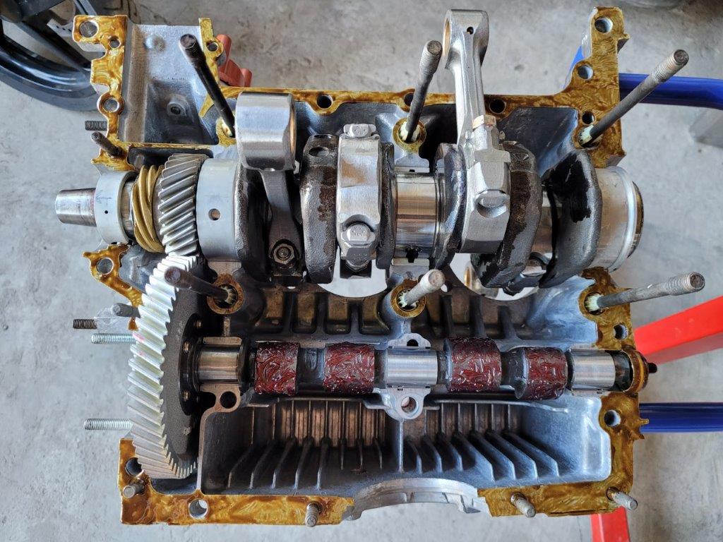

Here we have the crankshaft, crank and the permatex aviation sealant all ready for the other half of the case.

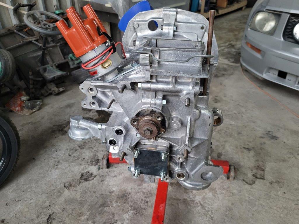

And finally the two case half's joined and torqued. I also installed a Type 1 oil pump that EMW modified.

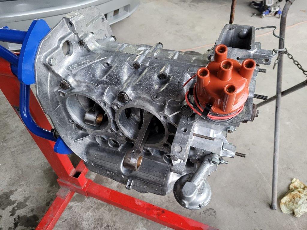

autopro   Had a productive day yesterday, I was able to get ...   Nov 12 2021, 11:49 AM
autopro   Moved on to cylinder and piston installation, I st...   Nov 12 2021, 11:59 AM
