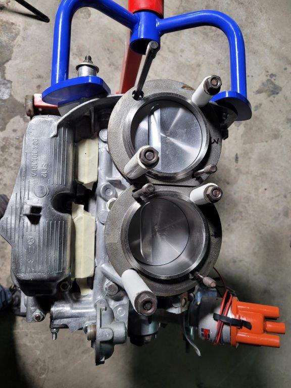

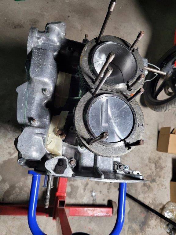

Moved on to cylinder and piston installation, I started with the #4 cylinder. Verified my deck height to be .04 in. and that the cylinders were even to have a good seal with the heads. Everything checked out ok.

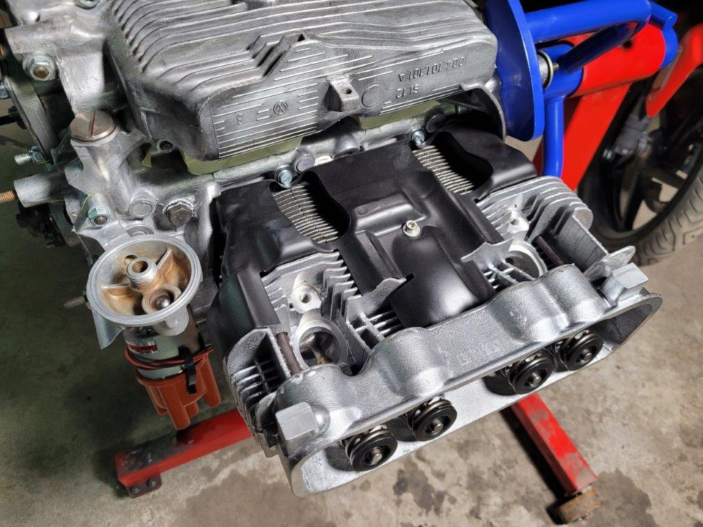

Bolted on the heads and installed my lower cooling tins.

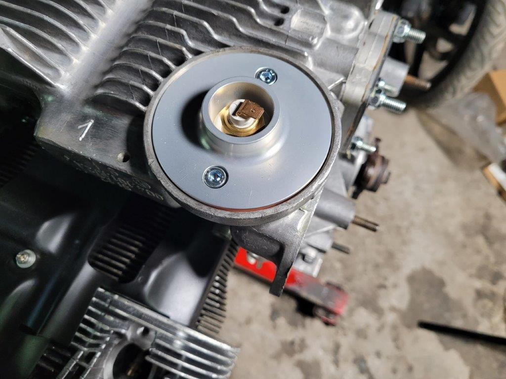

Installed the Billet Taco Plate I got from Rich at 914 Werke. I love this thing, very well made (IMG:style_emoticons/default/aktion035.gif)
