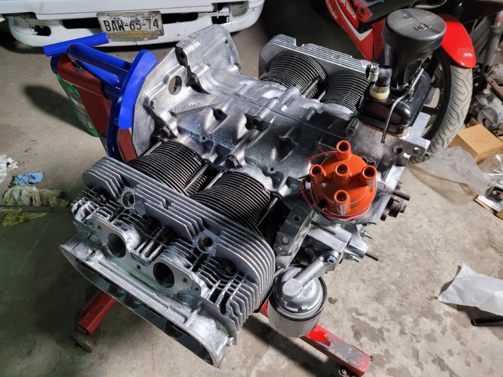

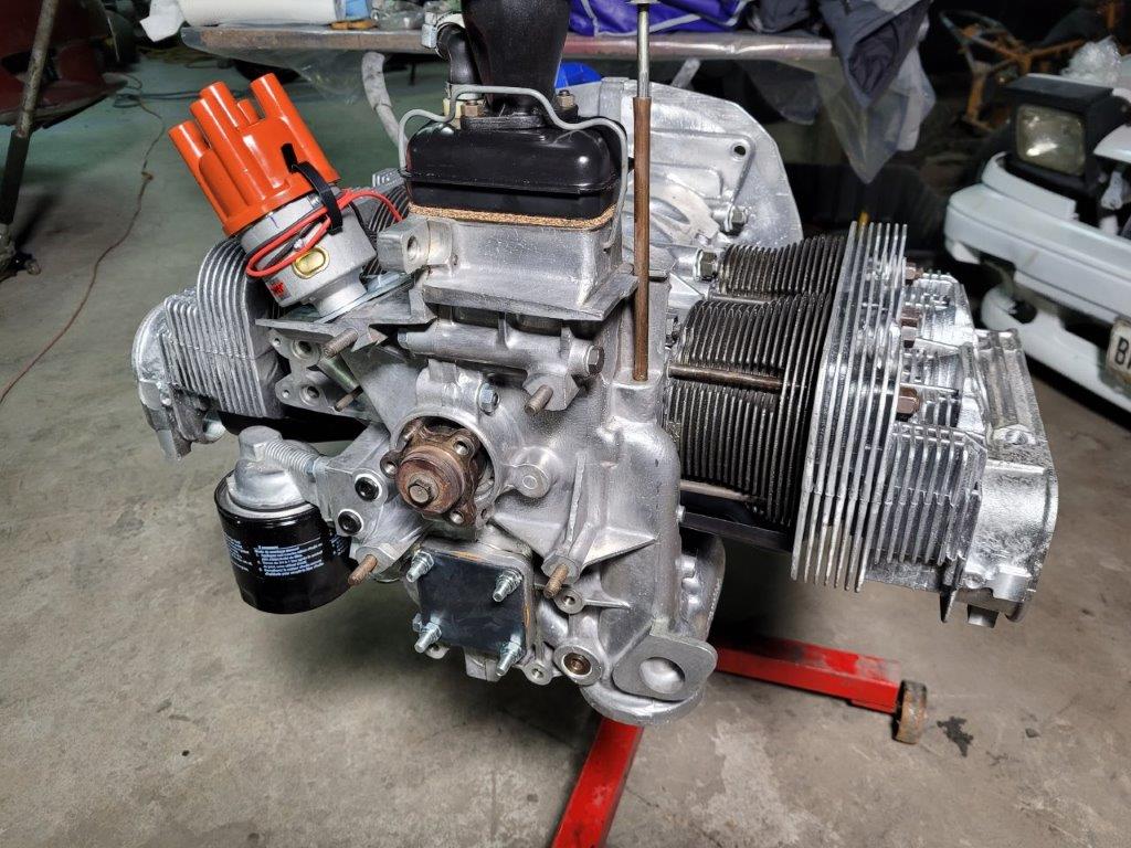

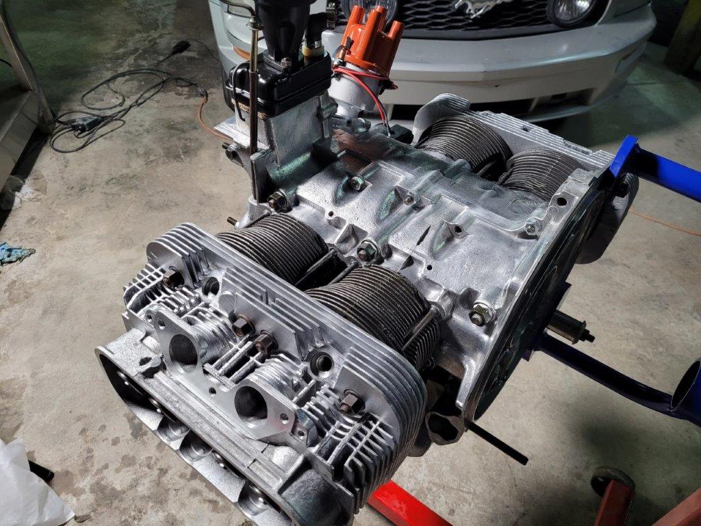

I forgot to add these pictures of where I left off that day on the engine build.
