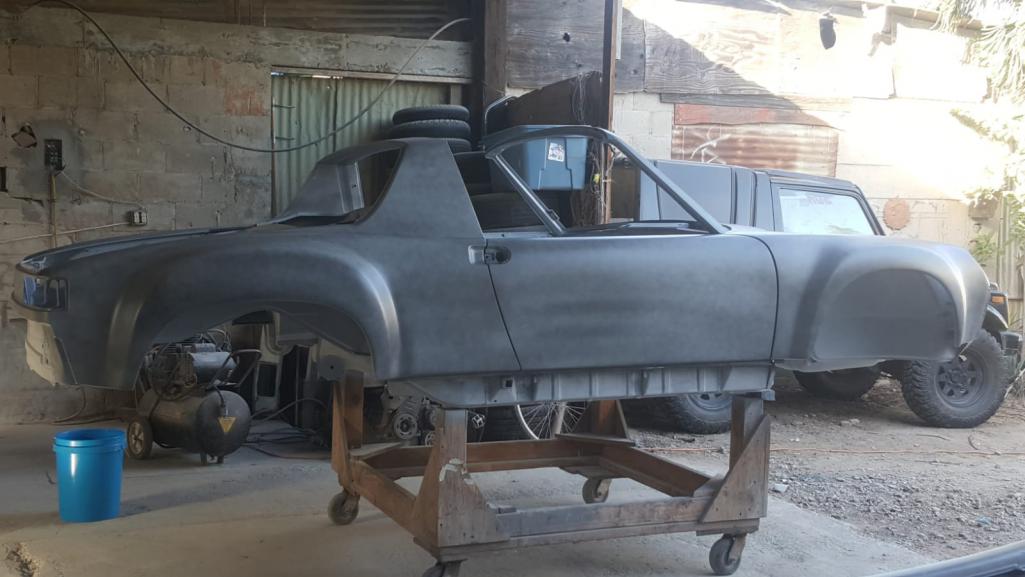

So before spraying the Raptor I wanted to finish priming the body. I finished blocking everything after the second round of primer and I only found a few spots that needed attention. Here is the 3rd primer round and the guide coat applied. From here I will be blocking with 220 and then 400 and 600 wet and it should be ready for paint.
