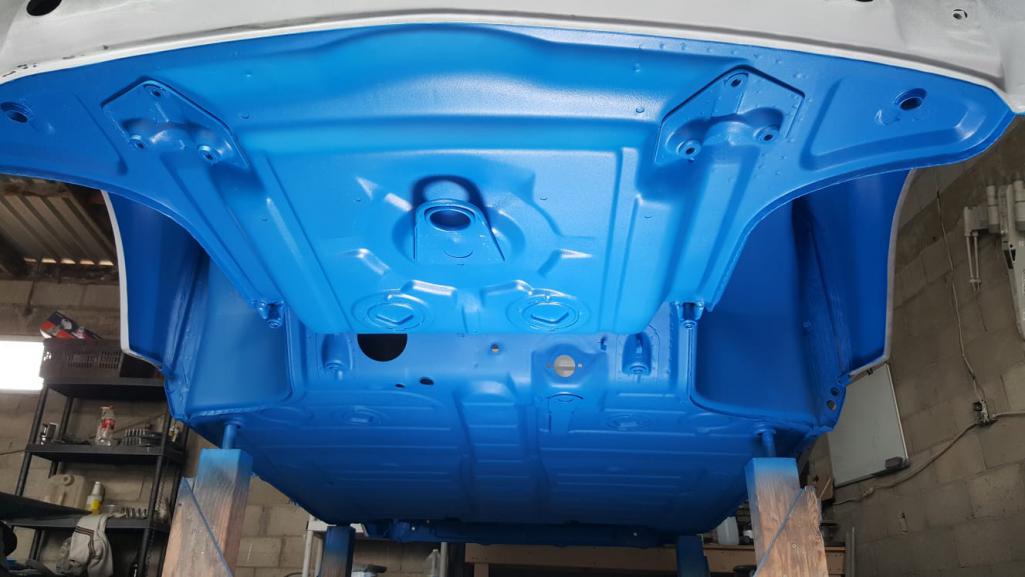

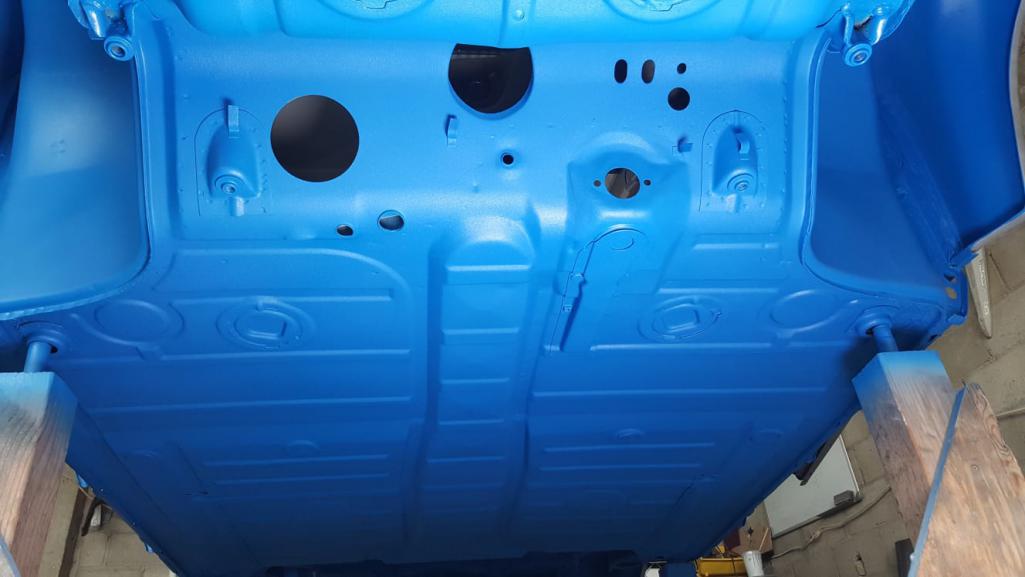

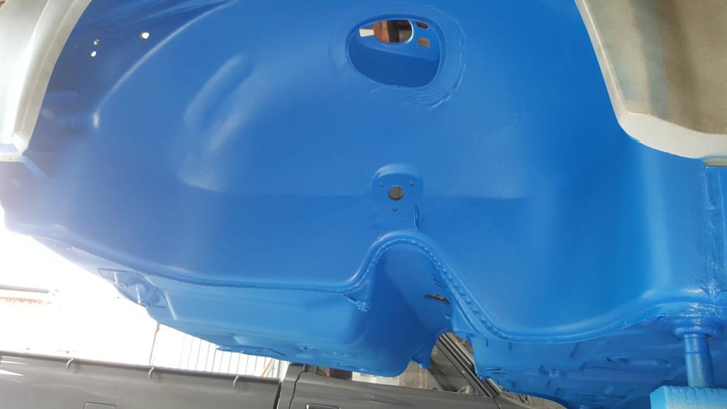

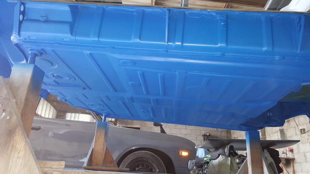

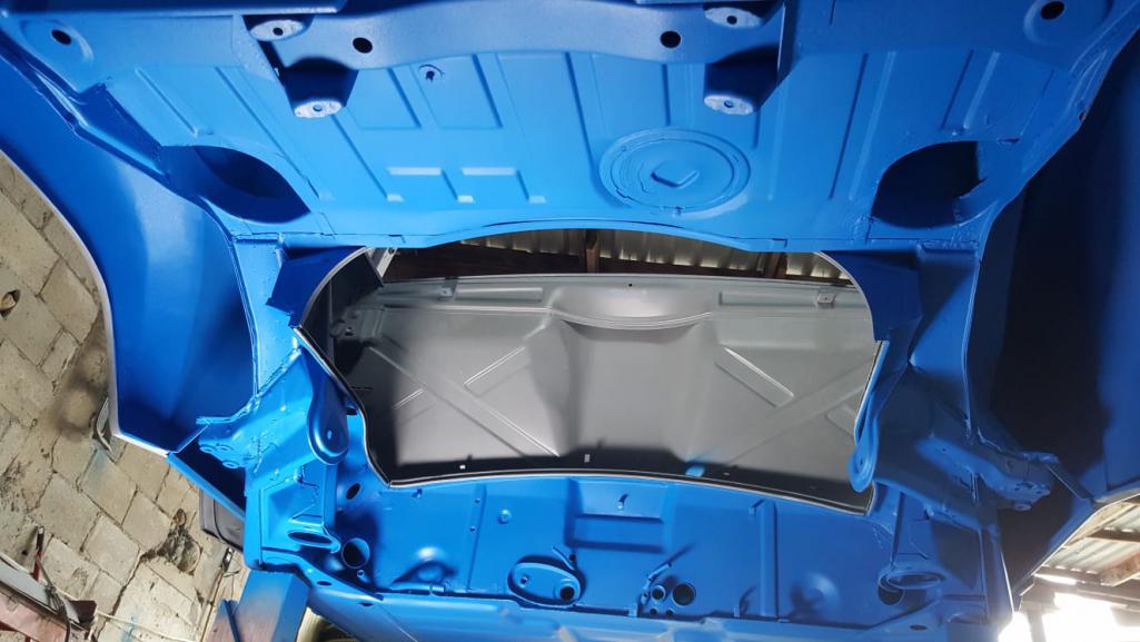

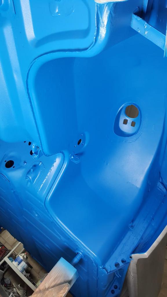

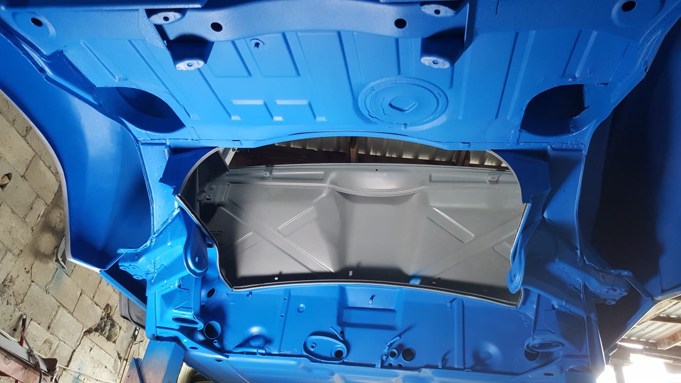

Finally we have some color and most of the hard work has been finished. This week was getting the underside done, I went to the paint store and they were able to match the Raptor to the color I will be spraying on the car. Since I wanted a smoother texture, I modified a spray gun from Harbor Freight by drilling the tip out to 2.0 I also reduced the raptor liner by about 5% and that seemed to give me the texture I was looking for. I was very surprised at how well it covered and how easy it was to spray. I bought the 4 quart kit and I still had a bit left over once I was done. I did the floor, lower engine bay and the wheel wells.
