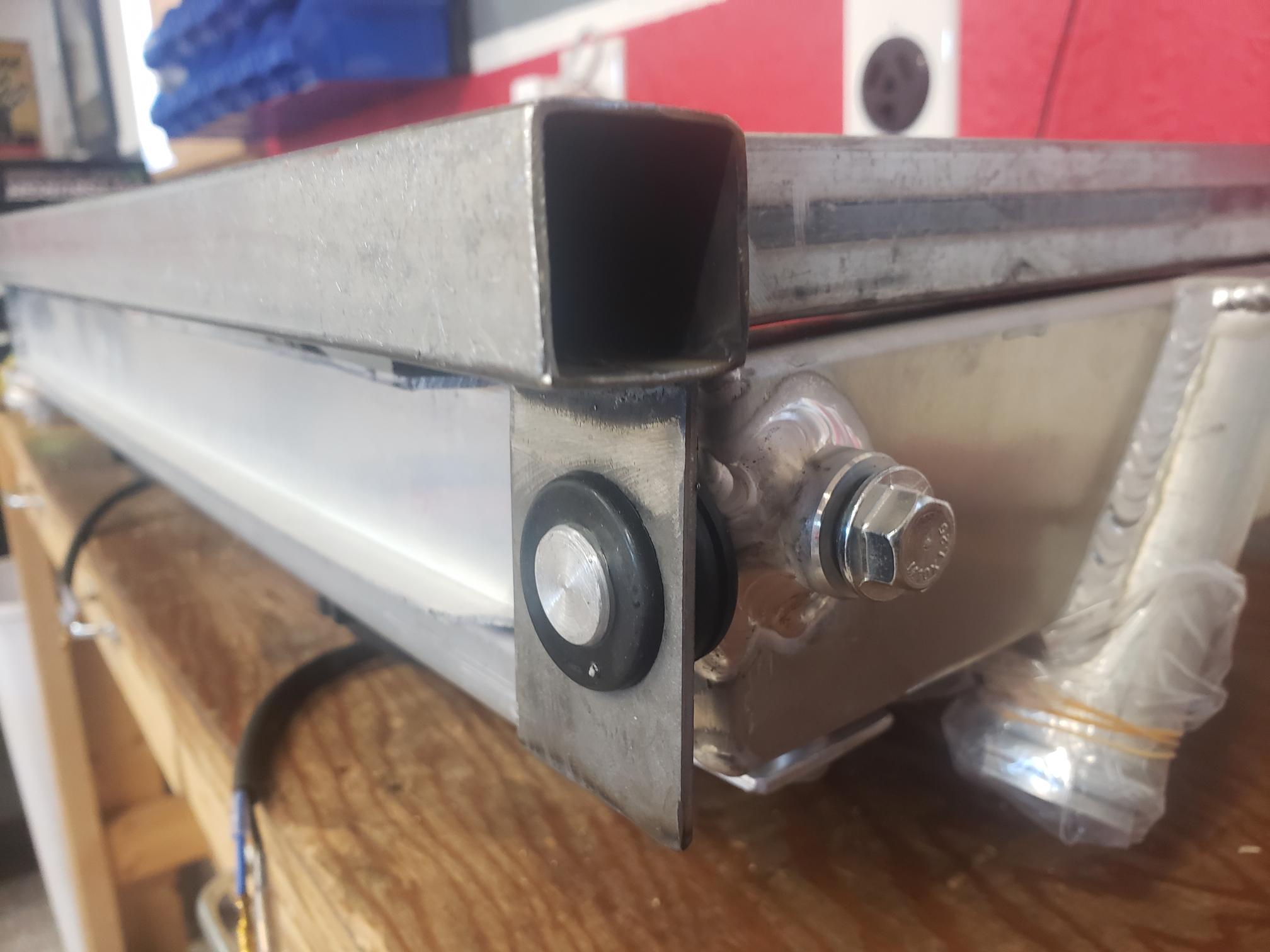

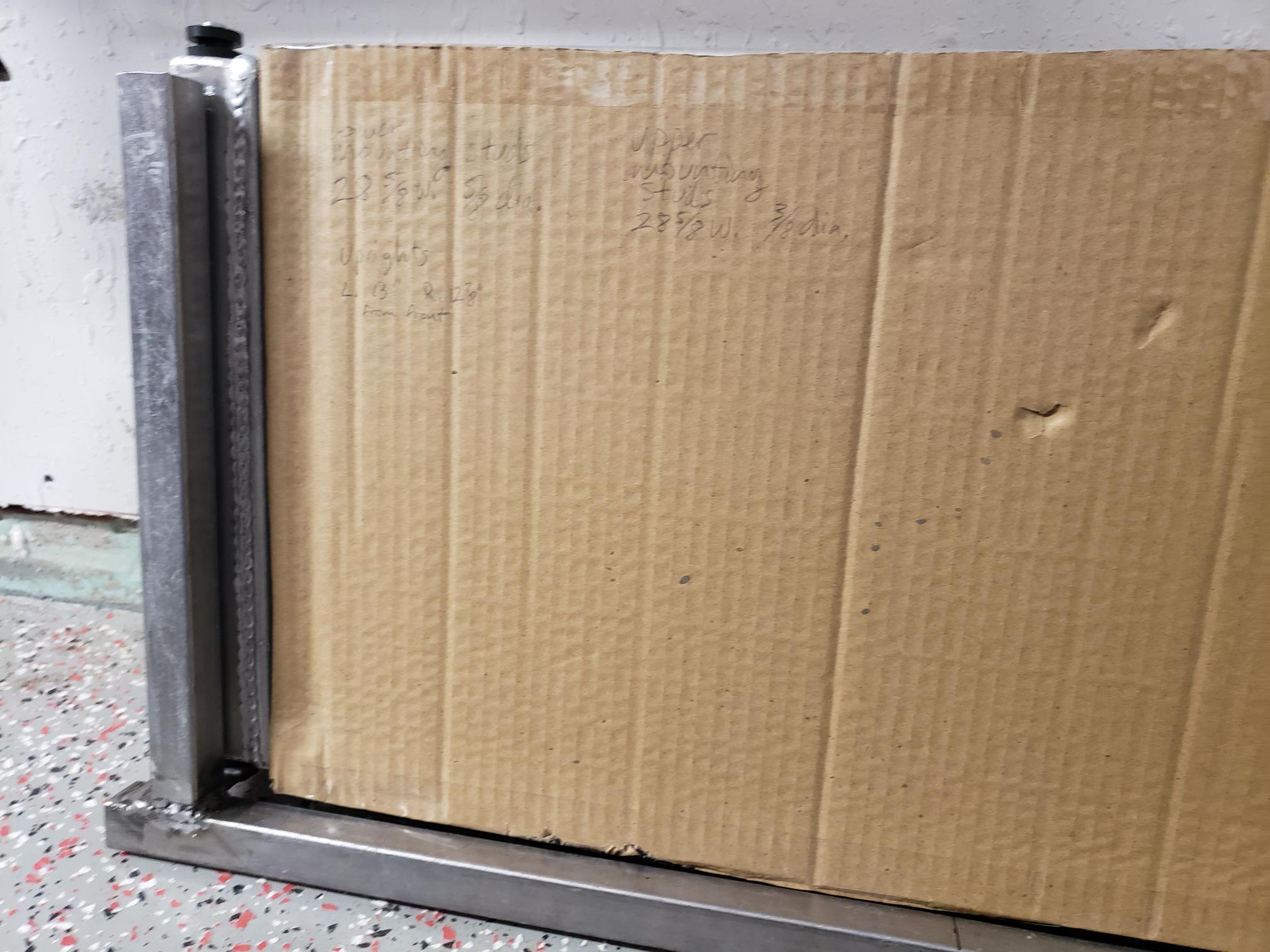

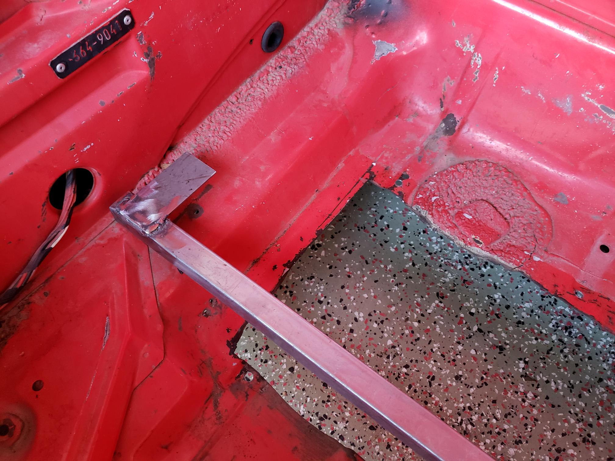

Now that I've committed to doing the Subaru EZ30 6 cylinder swap, I've been trying to make some progress. Focusing on the cooling system fabrication in the frunk, I'm making a little headway. The first thing I did was to buy a small Titanium flux core welder to replace my well-used Chicago Electric welder. Still a budget unit, but I like it fine.
My first welding job was to make the frame that will accommodate the floating radiator mounts. One inch square tubing and some flat bar make up the bottom and sides. Not pretty welds, but they'll get the job done.
The flat bar tabs were drilled and grommeted for the bottom mounting posts on the radiator.
I should note that I basically ripped off the approach from forum member rmarx (how do you tag someone in a post?). Thanks for the ideas! As he did, I will make drilled and grommeted tabs for the top posts as well, that will mount below or above the sheet metal cowling that will cover the intake side.
