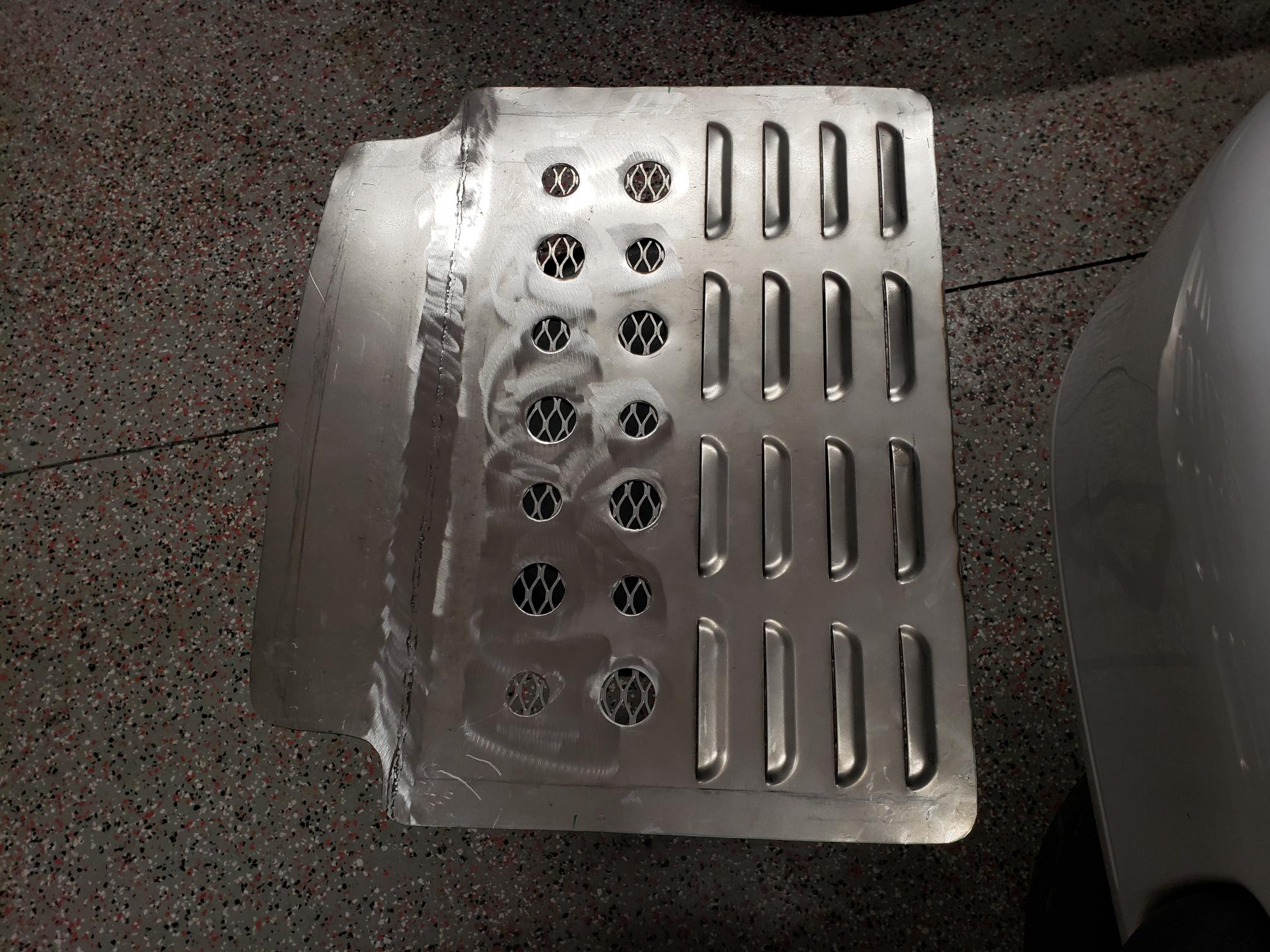

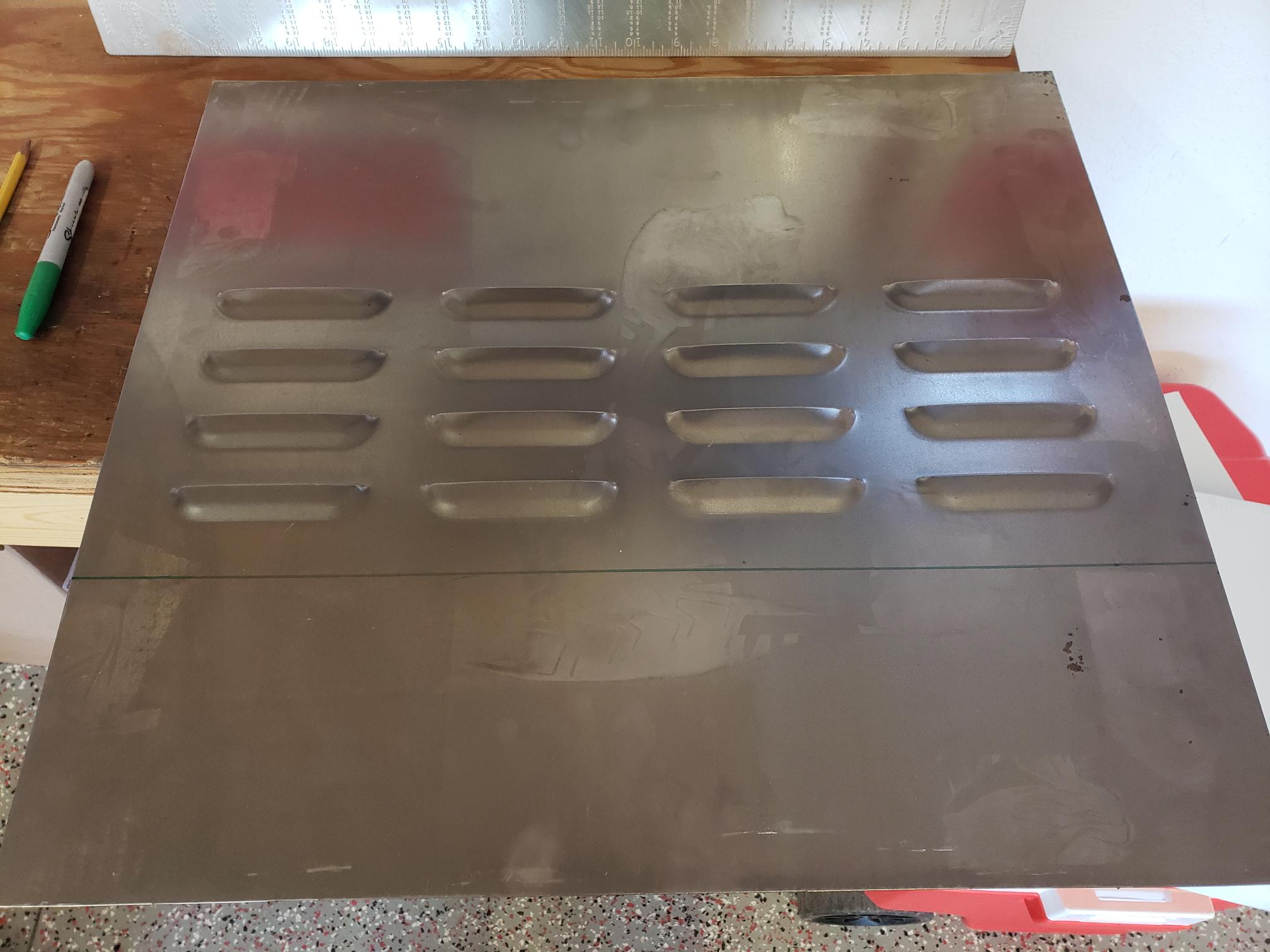

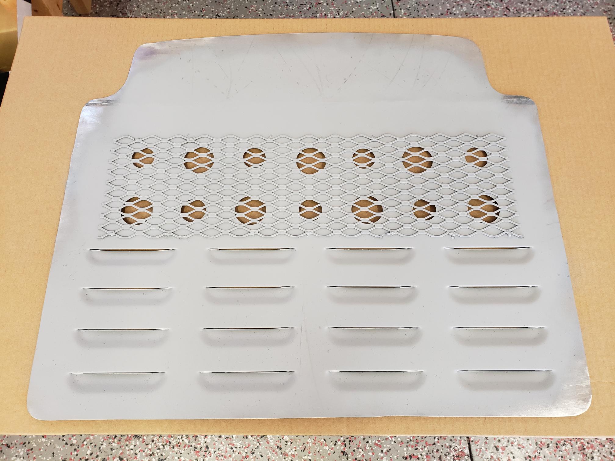

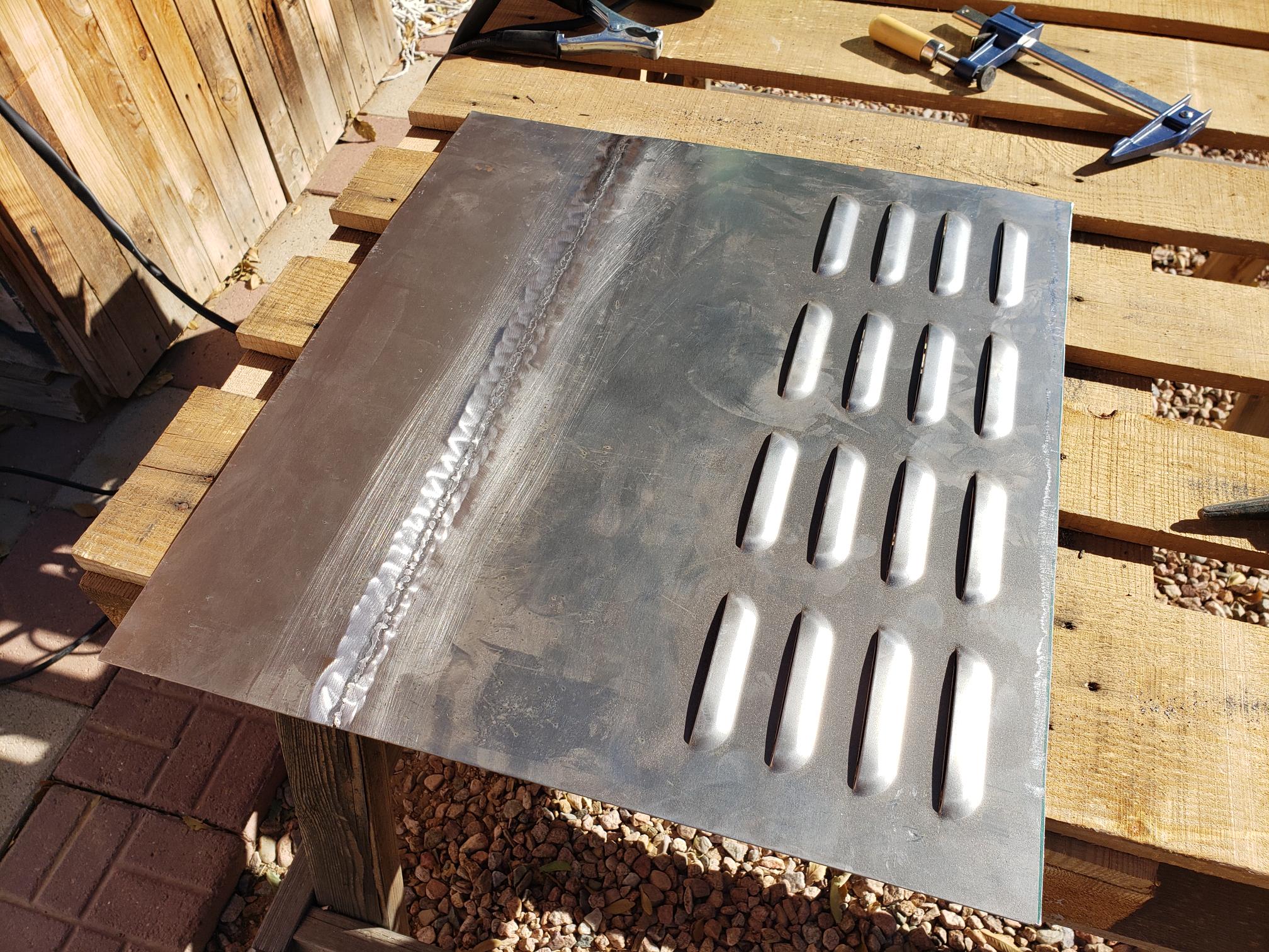

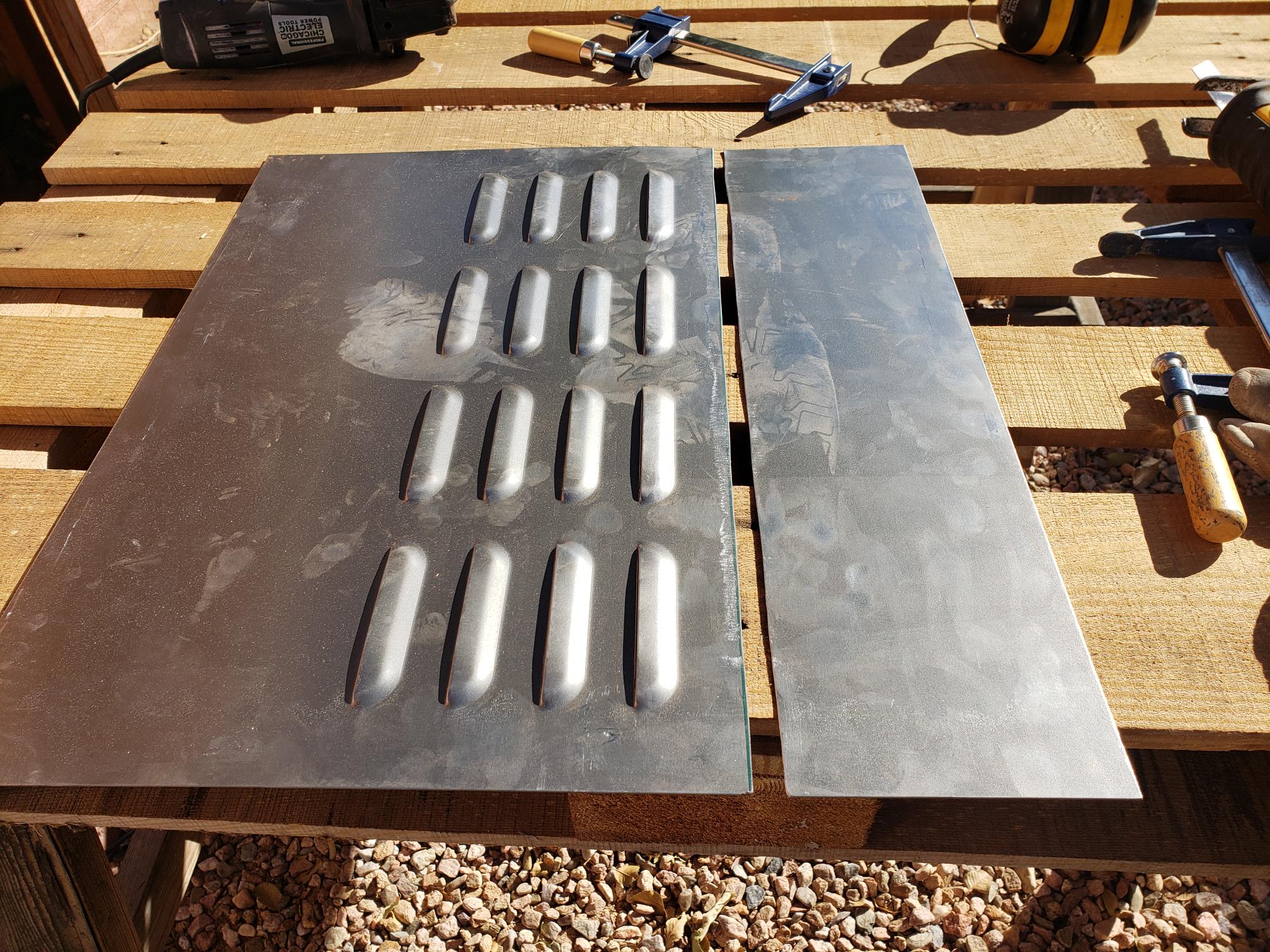

The next thing I needed to deal with was the terribly cut out floor pan, courtesy of the PO. I know some feel it's not the best way to vent air out, but I've decided to do it throught the frunk floor. I ordered the vented floor pan from Patrick Motorsports. For $65, it's fairly cheap, and it was fun to order something from them. Probably the only item ever!
It's designed for an oil cooler, so for my purposes, I needed to get the louvers back closer to the bulkhead to accommodate the radiator and fans. So I lopped of the extra material and moved it to the other side.
I cut it to the floor shape, then decided I needed more airflow. So I drilled a series of alternating 7/8" and 1 3/8" holes (trying to retain some strength), then covered them with expanded sheet metal to keep out rodents and debris. Wasn't too worried about covering the louvers.
At this point the pan is mostly seam welded in place. I'll post a few pics when I get it primed and seam sealed.
