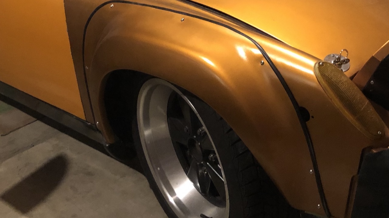

tazz9924
post Dec 1 2021, 11:44 PM
Posts: 755
Joined: 31-May 15
From: Mooresville NC
Member No.: 18,779
I used 1/4-20 rivnuts and not pictured here some 1/4 inch washers with rubber underneath. looked real good till a mercedes had something to say about it.
Rubber fender flare trim also was used around the flare.
