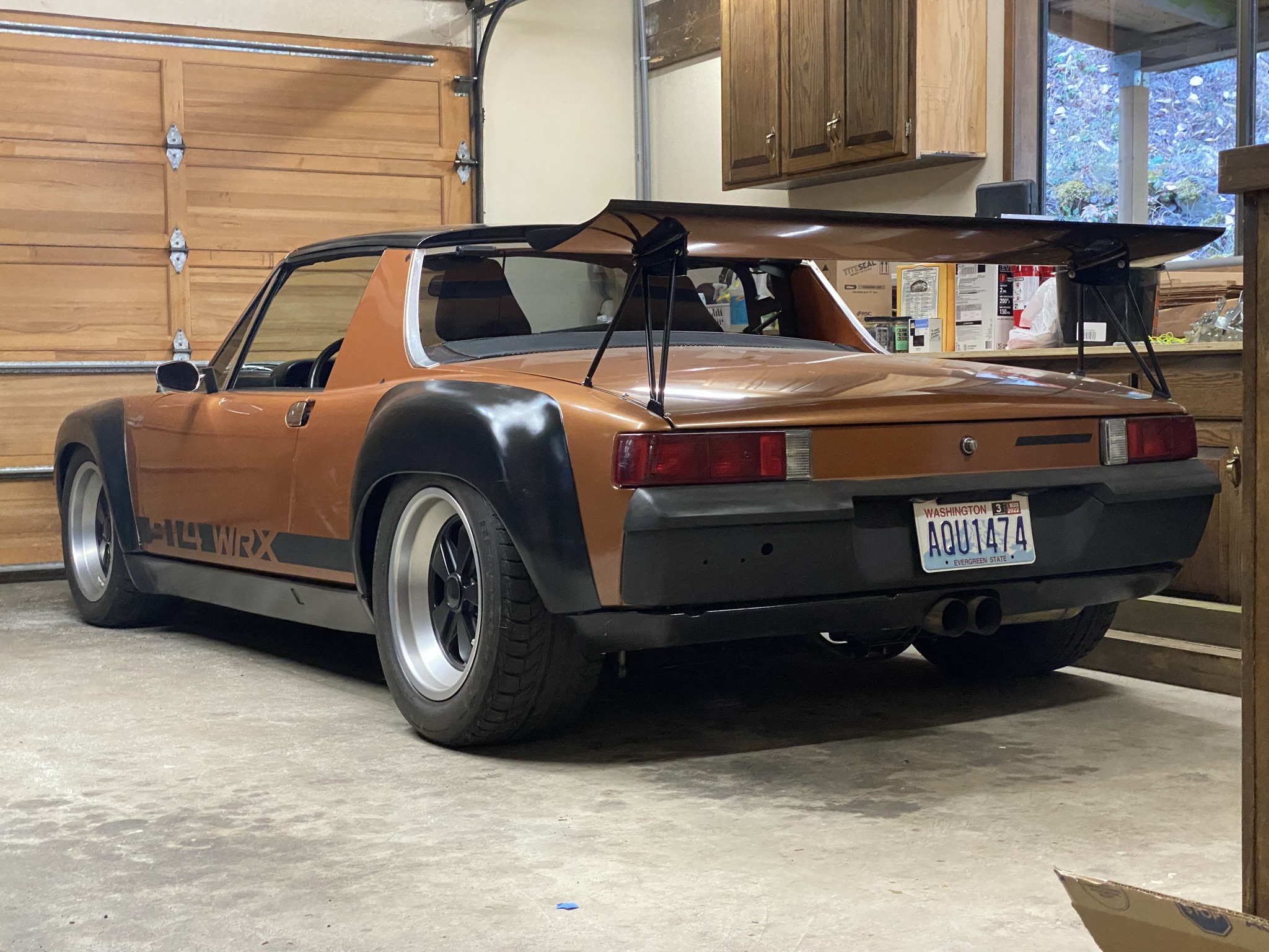

I used high strength adhesive tape and bonded studs and used fender washers on the inside to hide external fasteners.
I spent a week or two modifying and fairing all the edges of the flares. With the bolt on look the seam line where the flare attaches is a big part of the aesthetic.
This other photo also shows the winter suspension project.

High strength adhesive tape to hold the studs to the fenders. I was unaware they made such a product. Would you share the name of this product.
Below is a link to the version I think I used (3M super strength molding tape). I used a
3M product and there are a couple that use acrylic adhesives and are considered permanent.
https://www.3m.com/3M/en_US/p/d/b40069527/
Like any adhesive, surface prep is key. There in a primer/activator to be used with this as well.
Since install I have roughly 10,000 miles and a few track days on the car.
