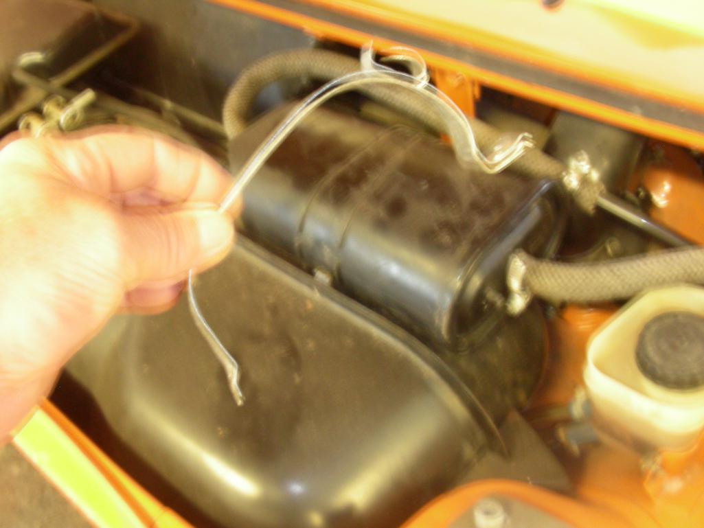

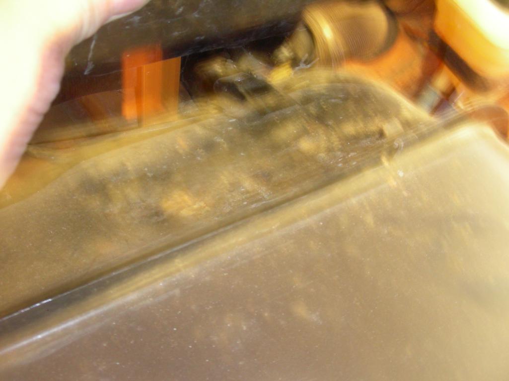

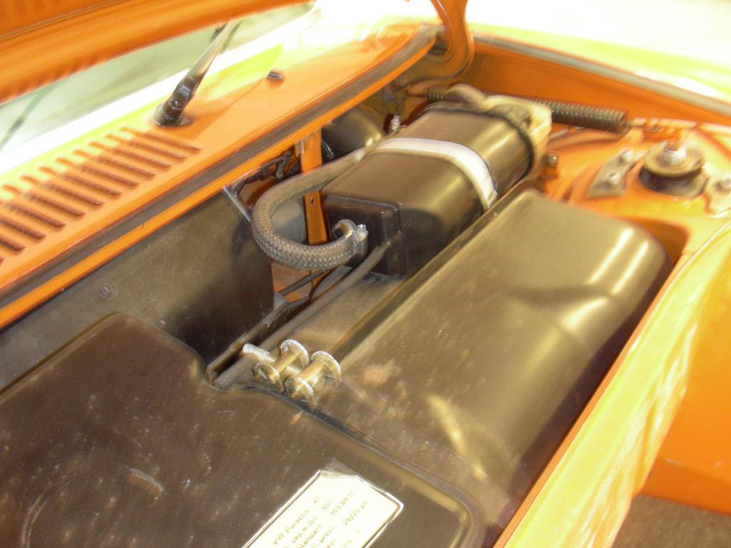

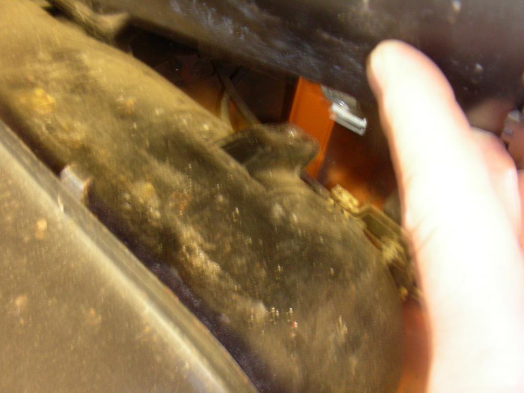

Any pictures of how the band that goes around the canister, mounts to the channel on the gas tank?

OK pics of canister mount and band
Thanks
RandyAttached Image Attached ImageAttached ImageAttached Image
