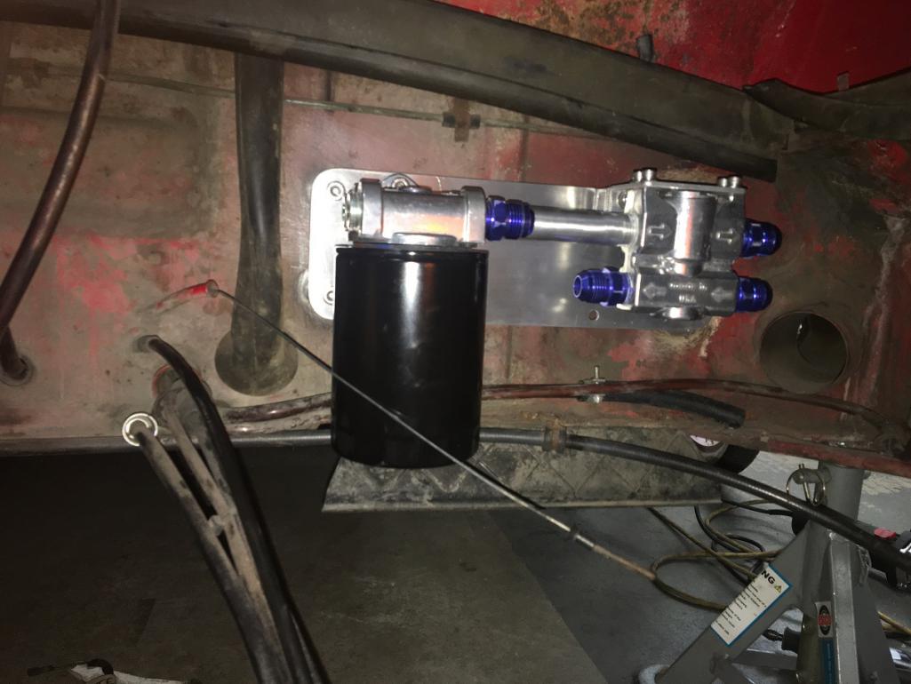

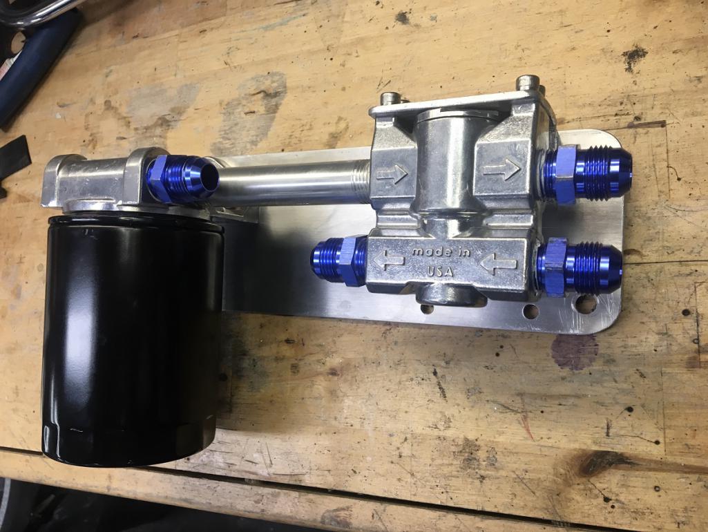

Planning ahead, I am doing modifications to the oil network. Although this is a 4 cylinder car, I intend to stroke my current 2056 to a 2258 (2270) in the future. So I already have made changes on the engine side as described in this halted (for this body work) Microsquirt thread:
Post #46 here: http://www.914world.com/bbs2/index.php?sho...42361&st=40
I made an aluminum panel for the remote oil filter and thermostat. I will be using a rabbit/jetta diesel filter which is rather large (almost 1 quart).
I welded 4 cylindrical tapped standoffs (911 part) to the lower right portion of the firewall to mount the assembly. The filter is high enough to be fully protected. The oil lines from and to the engine will connect in the middle area of the assembly, while the lines to the front cooler connect to the right side of the thermostat. This also clears the heating flexible tube between the heater valve and body heater duct.
More to come... (IMG:style_emoticons/default/stirthepot.gif)

Montreal914   Between the filter/thermostat assembly and the fro...   Dec 12 2021, 06:18 PM
Montreal914   Although I could have elected to use steel braded ...   Dec 12 2021, 07:19 PM
Montreal914   Now, that the rigid part has been completed, it is...   Dec 12 2021, 07:45 PM
bkrantz   Nice work--looks great!   Dec 12 2021, 08:05 PM
Montreal914   I am using a Mercedes Diesel oil cooler I got from...   Dec 12 2021, 08:08 PM
