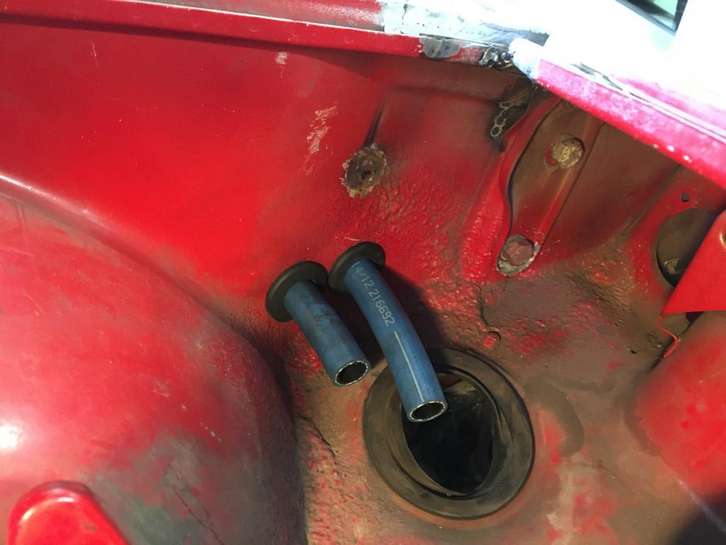

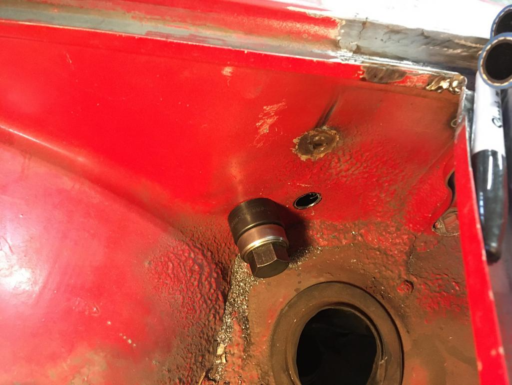

Now, that the rigid part has been completed, it is time to look into how we will get to the front oil cooler. Connecting to the rigid lines, I am using -10AN Parker push-lock hose.
After locating the right spot to make the openings in the body, I used a knock-out tool I got for $35 on Craigslist. This makes this task a breeze. (IMG:style_emoticons/default/smile.gif) This a picture of the upper left trunk area near the lid hinge (removed) and windshield washer bottle area.
And now with the grommets:

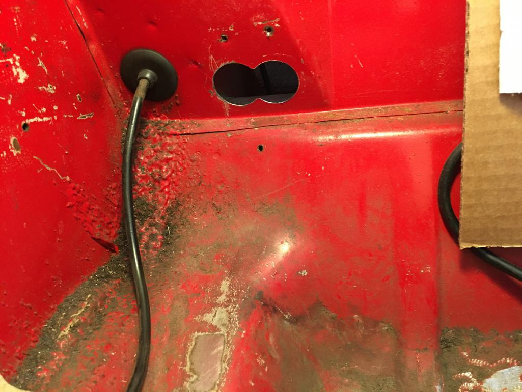

The next openings are through the lower part of the partition wall between the trunk and the fuel tank area. This being a little tighter area, I had to get the lines closer and overlap the holes. We are looking at the rear bottom left area of the front trunk. Next to the paired holes is the air pressure line from the spare to the washer bottle.

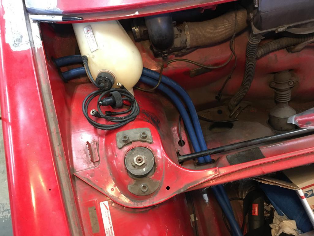

And finally, with trimmed grommets and mock up hoses (out of focus picture but you get the idea... (IMG:style_emoticons/default/biggrin.gif) :

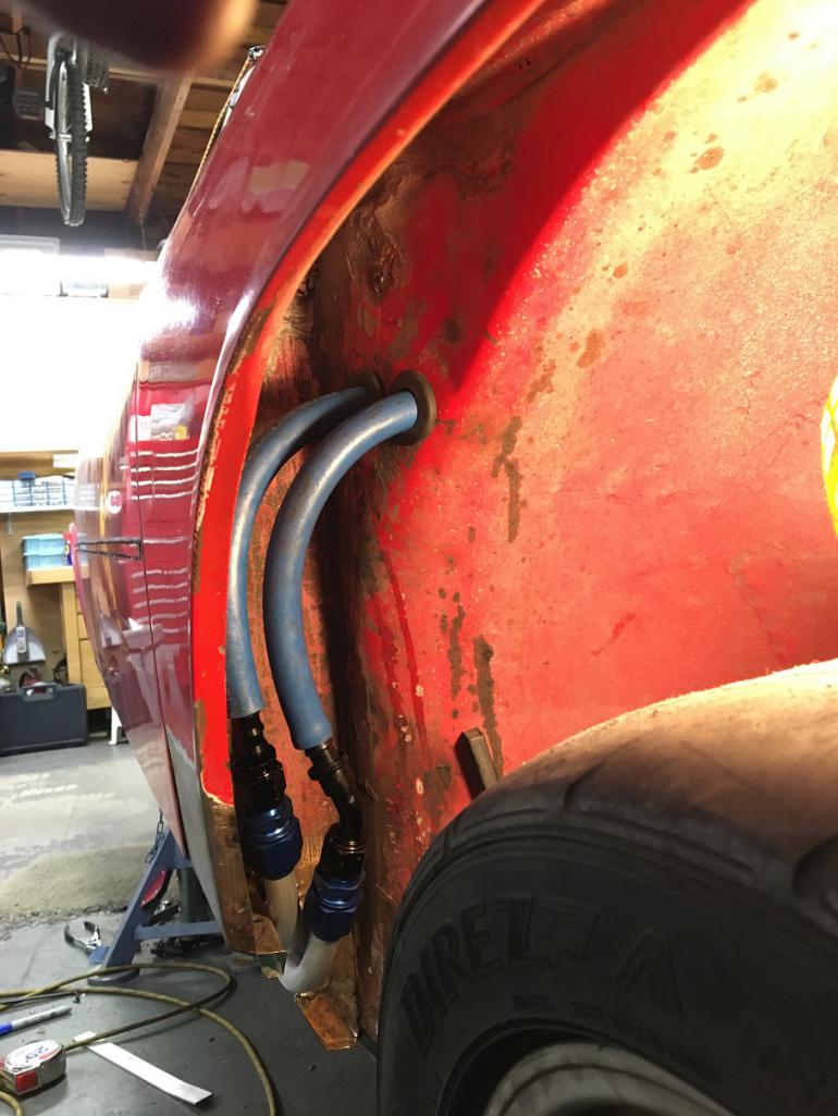

So the final result looks like this in the fender well:

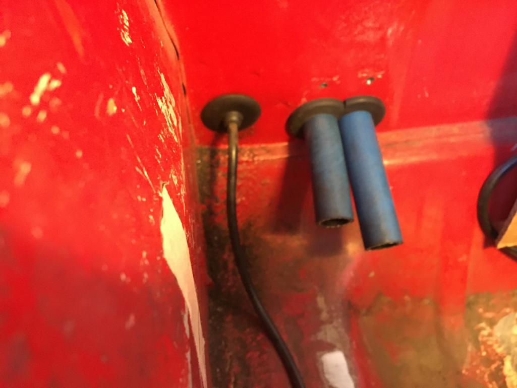

And in the trunk area:
