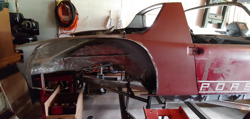

I am trying to understand the construction of the rear part of the fender, more precisely the area joining the front cowling.
Below is a sketch of how I think it is made but i would like someone to confirm...
Having removed the seam sealer in the upper rear area, I have discovered "this" (IMG:style_emoticons/default/dry.gif) which is not really unusual, but clearly a pain to fix. I am not sure though what I am looking at. If my sketch is correct, I guess the inner rusted layer is from the fender rear bulkhead that actually becomes an inner layer on the rear upper point of the fender by the door and cowling junction.
I might be able to cut this from the underside preventing me from cutting the outer surface of the fender. But I would like to better understand what is happening at the junction to the body.
How many layers are there from the fender, one or two?
Is the metal peeling off at the joint to the body the metal from the bulkhead/inner layer, or is it the outer fender layer?
As a reference, this if the situation of the channel, surface rust, but how bad? Is there a way to better know without destroying? Maybe poke with a screwdriver? (IMG:style_emoticons/default/confused24.gif)
Comments appreciated (IMG:style_emoticons/default/smile.gif)

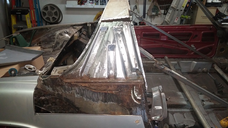

Montreal914   Here I will need the input from the experienced pe...   Dec 15 2021, 11:36 AM
Luke M   I've done both of these type of repairs. My br...   Dec 15 2021, 02:34 PM
Montreal914   Thank you for the advice and pictures Luke. :) ...   Dec 15 2021, 03:27 PM
Luke M   Thank you for the advice and pictures Luke. :) ...   Dec 15 2021, 06:12 PM
Montreal914   So am I understanding that you keep the tube on th...   Dec 15 2021, 08:14 PM
Luke M   Correct. Keep the tube on the donor q-panel. Remov...   Dec 16 2021, 11:07 AM

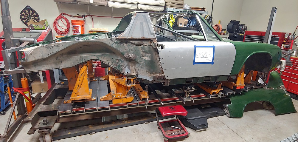

nathanxnathan   You know my original advice was to splice in just ...   Sep 26 2022, 10:45 AM
Montreal914   You know my original advice was to splice in just...   Sep 26 2022, 11:20 PM
nathanxnathan   Nathan, yes I still have all the pictures you sen...   Sep 27 2022, 11:39 AM
Montreal914   All good inputs!! :trophy: @nathanxnat...   Sep 27 2022, 08:03 PM
nathanxnathan   All good inputs!! :trophy: [b]@[url=h...   Sep 28 2022, 11:31 PM
