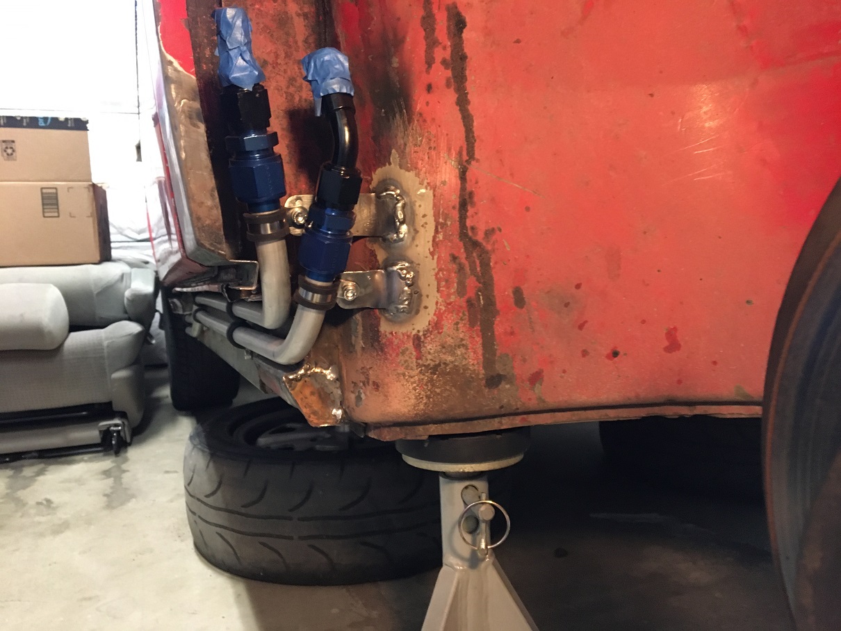

Finally, I moved on to finish the oil lines project. I fabricated a couple of brackets to support the front end of the aluminum rigid lines in the wheel well. Each bracket has an M6 nut welded on its back side allowing easy installation of the Abel clamp. Everything is now nicely secured. (IMG:style_emoticons/default/smile.gif)

Montreal914   Between the filter/thermostat assembly and the fro...   Dec 12 2021, 06:18 PM
Montreal914   Although I could have elected to use steel braded ...   Dec 12 2021, 07:19 PM
Montreal914   Now, that the rigid part has been completed, it is...   Dec 12 2021, 07:45 PM
bkrantz   Nice work--looks great!   Dec 12 2021, 08:05 PM
Montreal914   I am using a Mercedes Diesel oil cooler I got from...   Dec 12 2021, 08:08 PM
