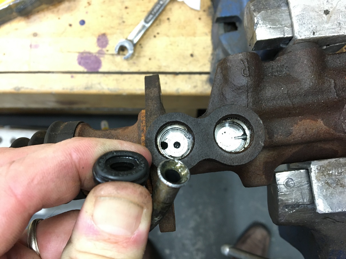

Today I removed the master cylinder and pedal assembly. This is a stock 17mm Ate. I removed all the parts from it in case I will need them on my new 19mm Ate MC once I reassemble the car. I will use a 19mm since I am upgrading to 911 front struts.
So, after removing the plastic/metal feed lines and grommet from the MC, here is what I am left with (picture). I thought there was supposed to be a washer underneath the rubber grommet?
I drove this car daily for 10 years and the MC was bone dry. I thought without the washers, the feed lines would leak? (IMG:style_emoticons/default/confused24.gif) Do I have a different setup here?
I will check to see if my new 19mm MC has the washers but please confirm that I do need the washers under the rubber grommet.
Thank you! (IMG:style_emoticons/default/beerchug.gif)
