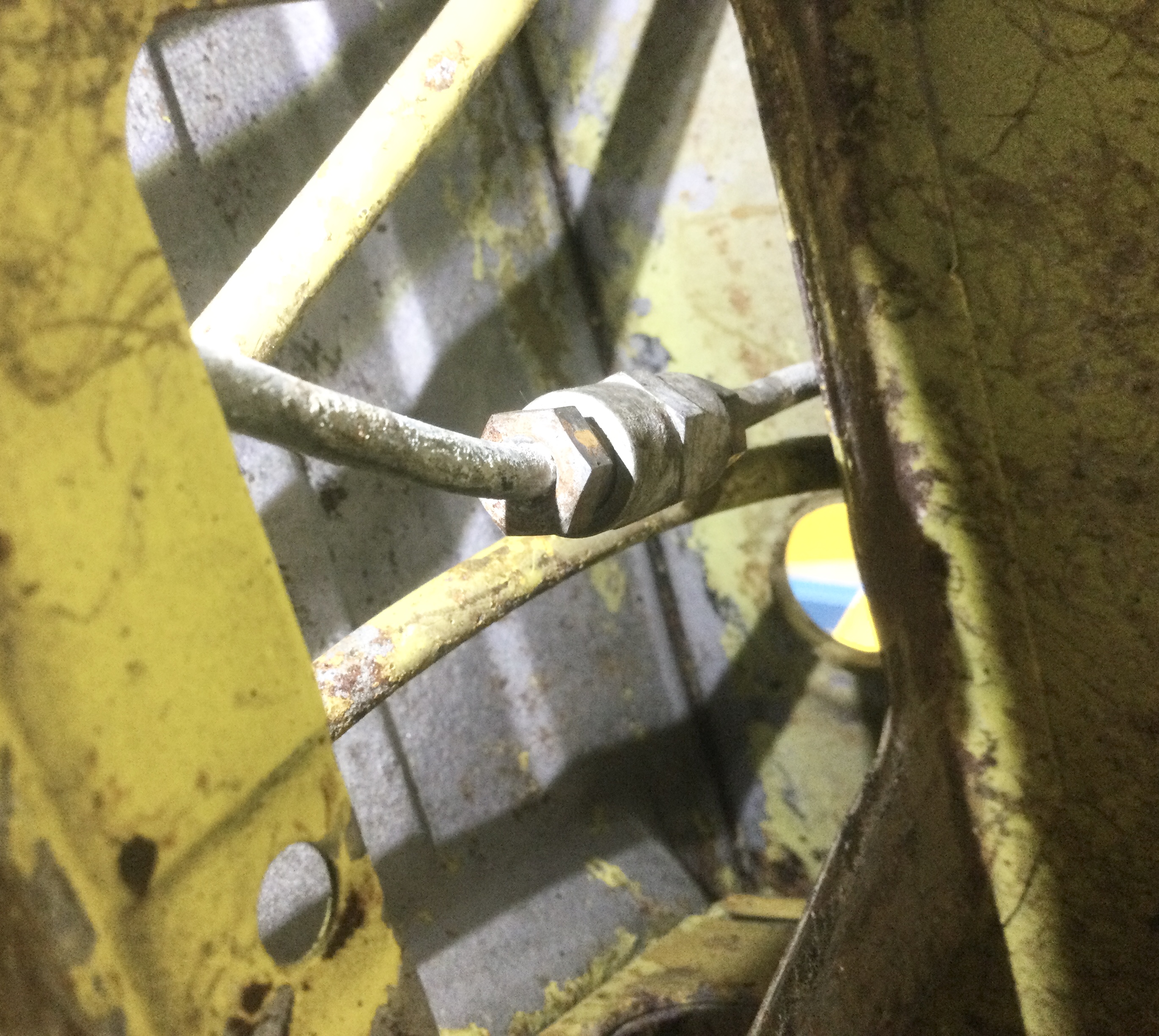

Alain V.   This stuff is “The Devil” boooooo! Eats 91...   Jan 2 2022, 03:57 PM

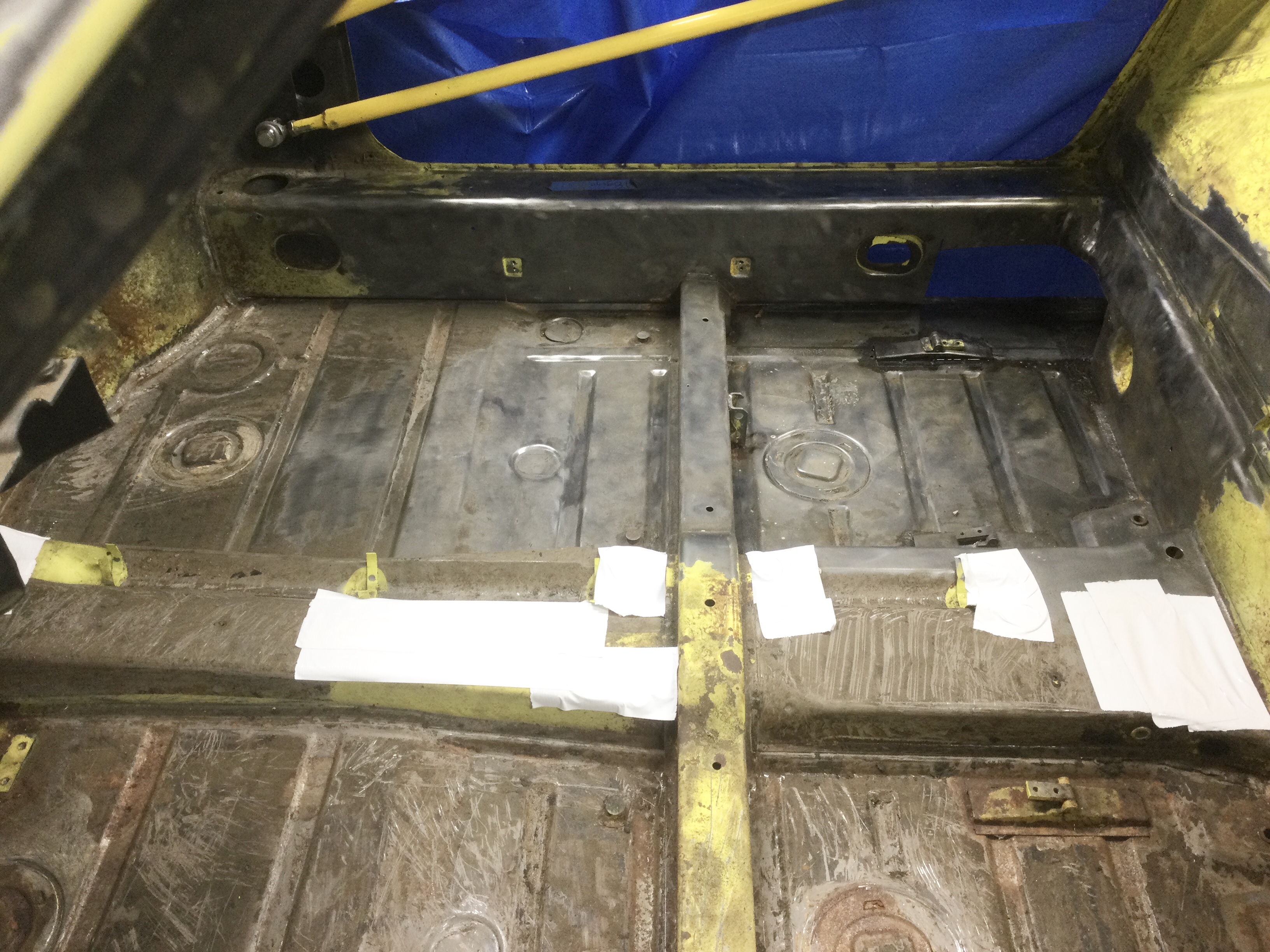

Alain V.   Time to start the rust hunt   Jan 2 2022, 04:17 PM
Alain V.   First “lesson learned”. I should have left the...   Jan 2 2022, 04:19 PM
Alain V.   My first attempt at installing a patch that I cut ...   Jan 2 2022, 04:21 PM

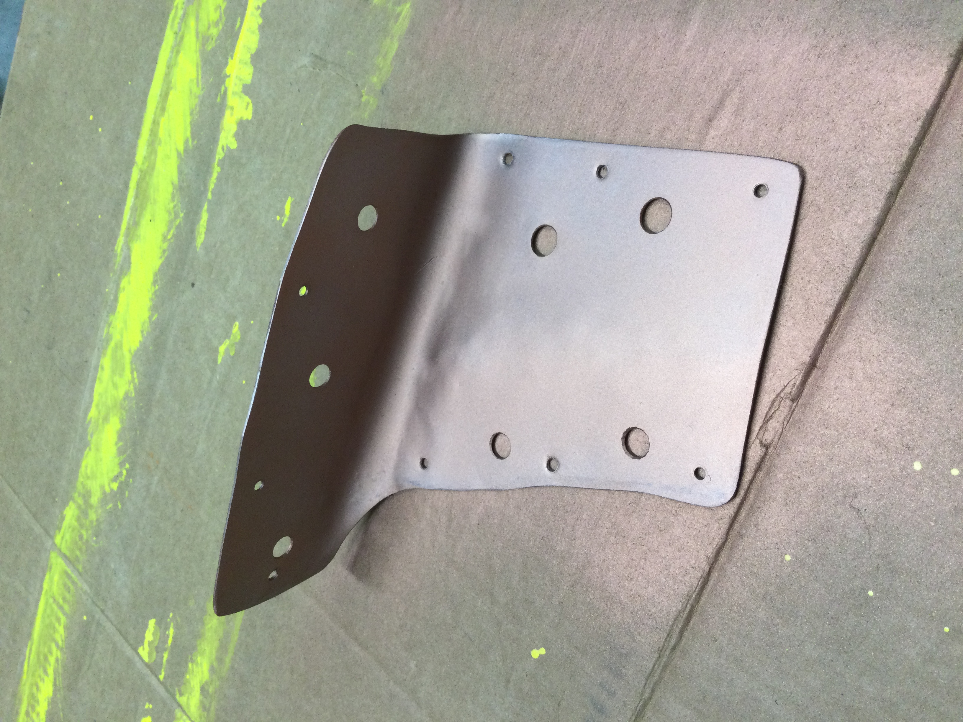

Alain V.   Removed old console piece   Jan 2 2022, 04:30 PM
Alain V.   Need to make a small patch for the skin behind the...   Jan 2 2022, 04:31 PM
Alain V.   RE: 72 rustoration / subaru 6cyl project in Kansas   Jan 2 2022, 04:33 PM
Alain V.   RE: 72 rustoration / subaru 6cyl project in Kansas   Jan 2 2022, 04:34 PM
Alain V.   RE: 72 rustoration / subaru 6cyl project in Kansas   Jan 2 2022, 04:35 PM
Alain V.   RE: 72 rustoration / subaru 6cyl project in Kansas   Jan 2 2022, 04:36 PM
Alain V.   Test fitting new piece   Jan 2 2022, 04:37 PM

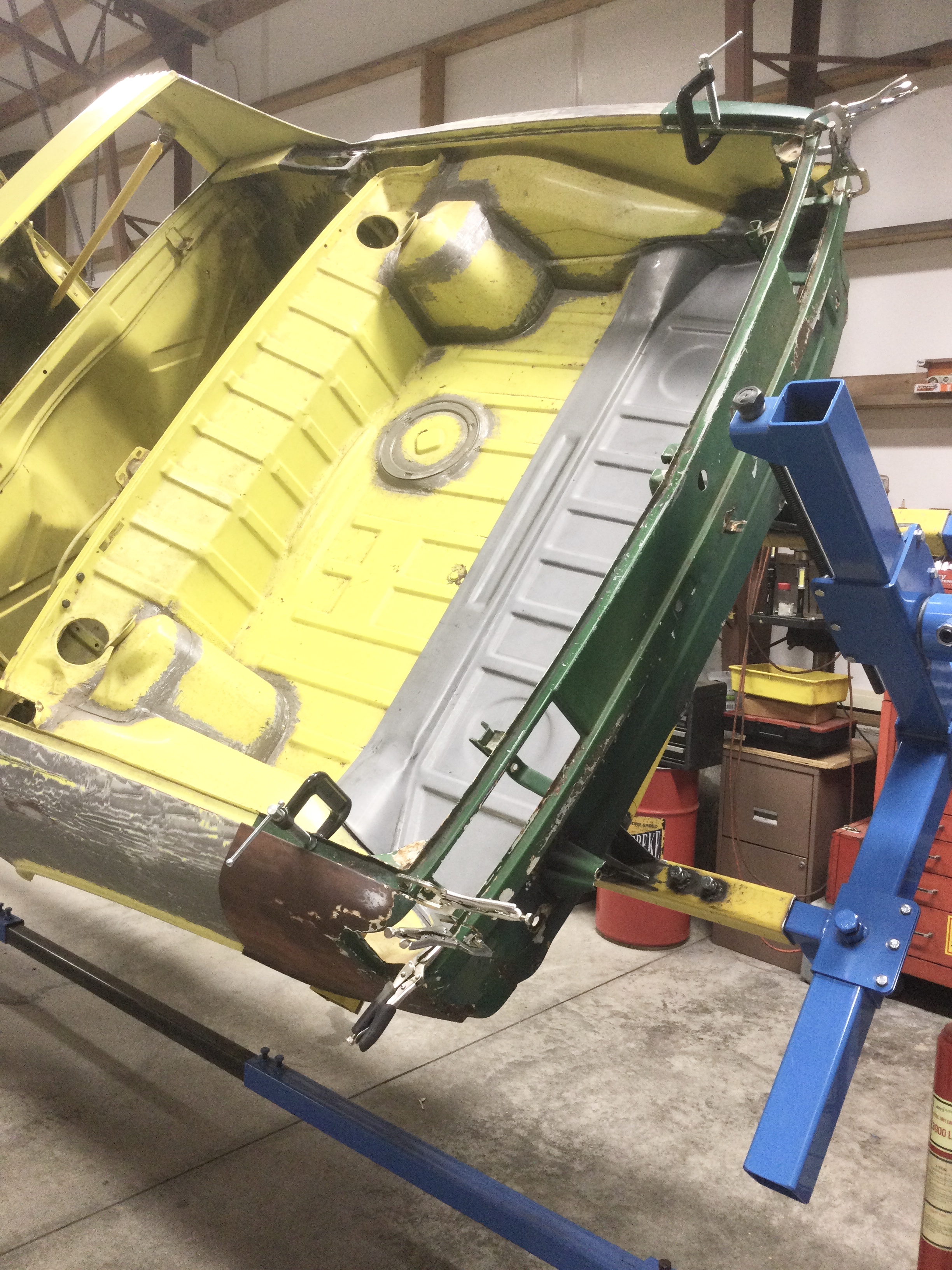

Alain V.   Decided to put the whole thing on an auto twirler ...   Jan 2 2022, 04:41 PM

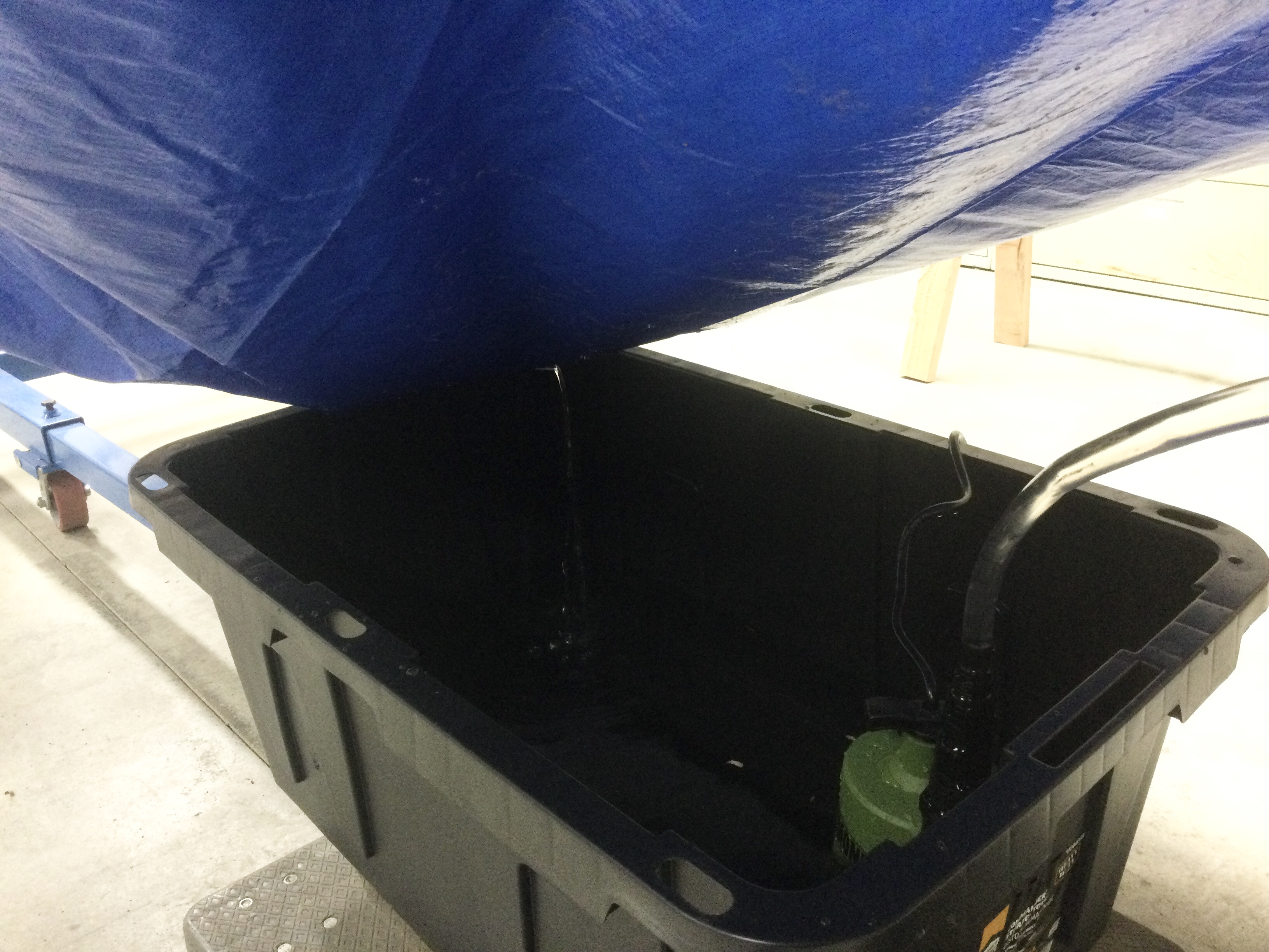

Alain V.   Got an idea for cleaning surface rust out of hard ...   Jan 2 2022, 05:45 PM
Alain V.   I’m going to flush the area with a rust solution...   Jan 2 2022, 05:48 PM
lesorubcheek   I’m going to flush the area with a rust solutio...   Jan 2 2022, 08:31 PM
Alain V.   RE: 72 rustoration / subaru 6cyl project in Kansas   Jan 2 2022, 05:49 PM
Alain V.   RE: 72 rustoration / subaru 6cyl project in Kansas   Jan 2 2022, 05:51 PM
Alain V.   After flushing.   Jan 2 2022, 05:52 PM
Alain V.   RE: 72 rustoration / subaru 6cyl project in Kansas   Jan 2 2022, 05:52 PM
Alain V.   RE: 72 rustoration / subaru 6cyl project in Kansas   Jan 2 2022, 05:53 PM

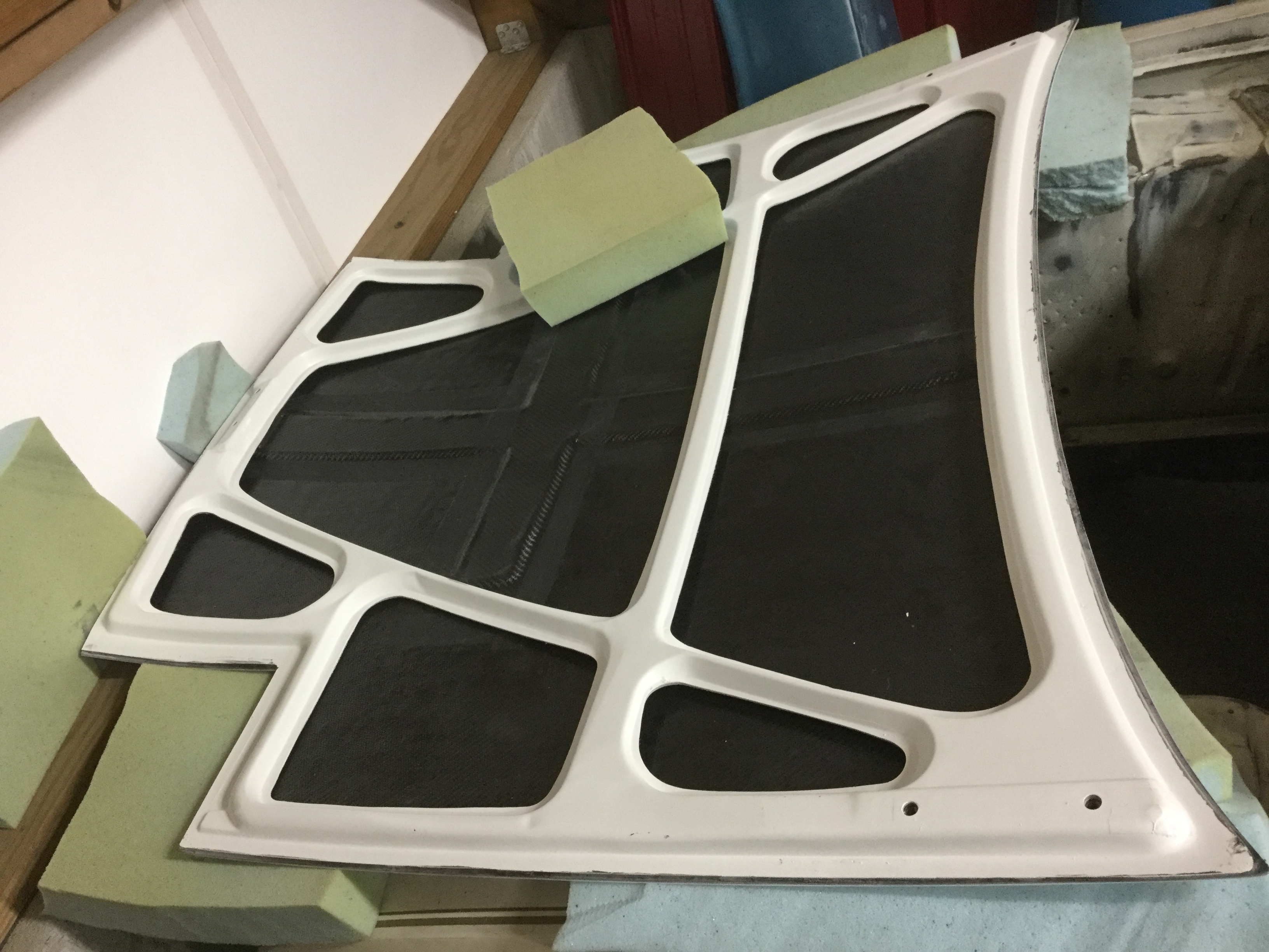

Alain V.   I'm also going to try and come up with a light...   Jan 3 2022, 09:46 PM

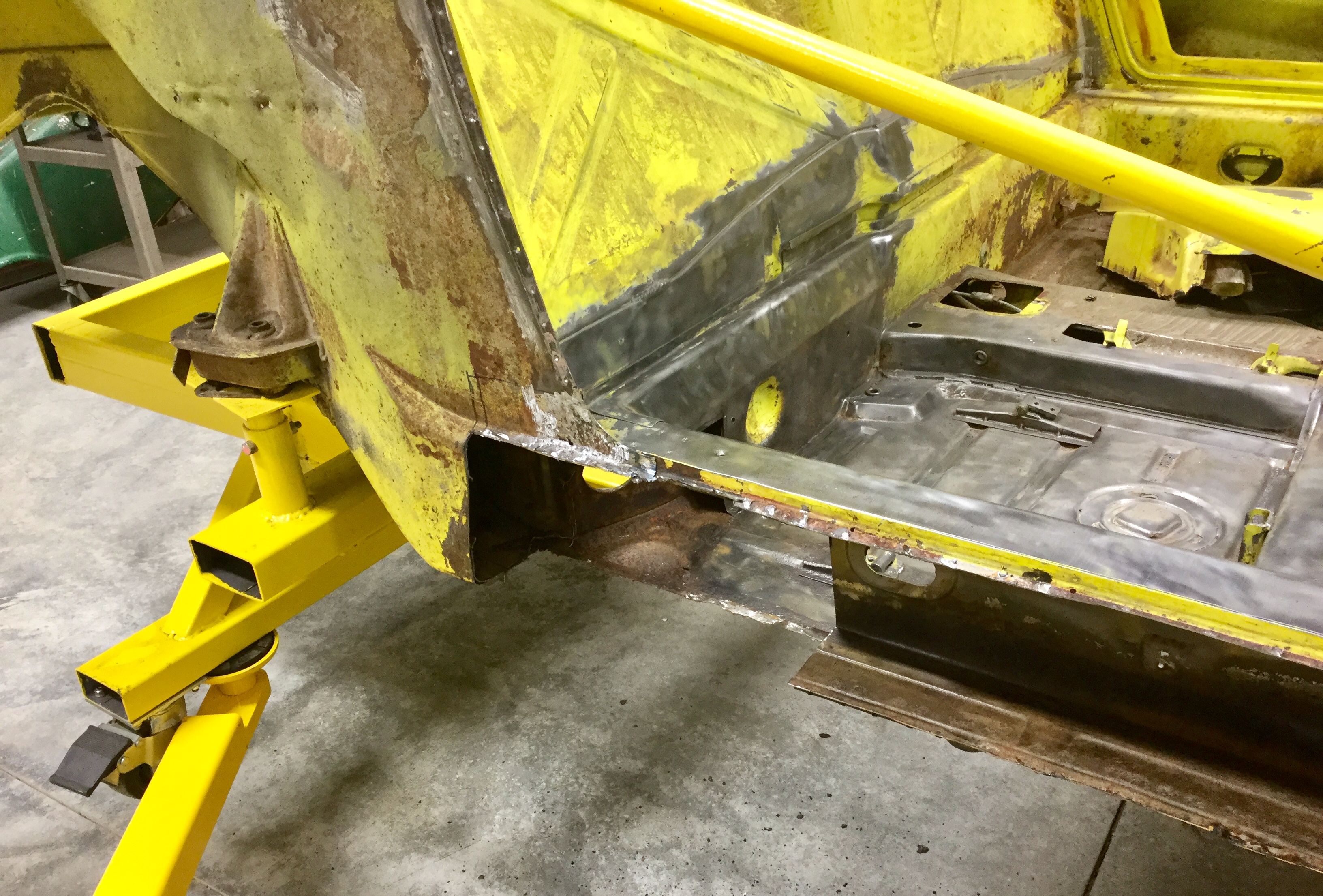

Alain V.   Well, making tiny amounts of progress,,,,,,,but at...   Jan 30 2022, 06:38 PM
Alain V.   Still needs a little finesse work on the side mark...   Jan 30 2022, 06:40 PM

Zaffer   It looks great, IMHO. What rotisserie are you usin...   Feb 13 2022, 06:07 PM
Alain V.   Thanks, the rotisserie is an Auto twirler "PR...   Feb 13 2022, 09:58 PM
