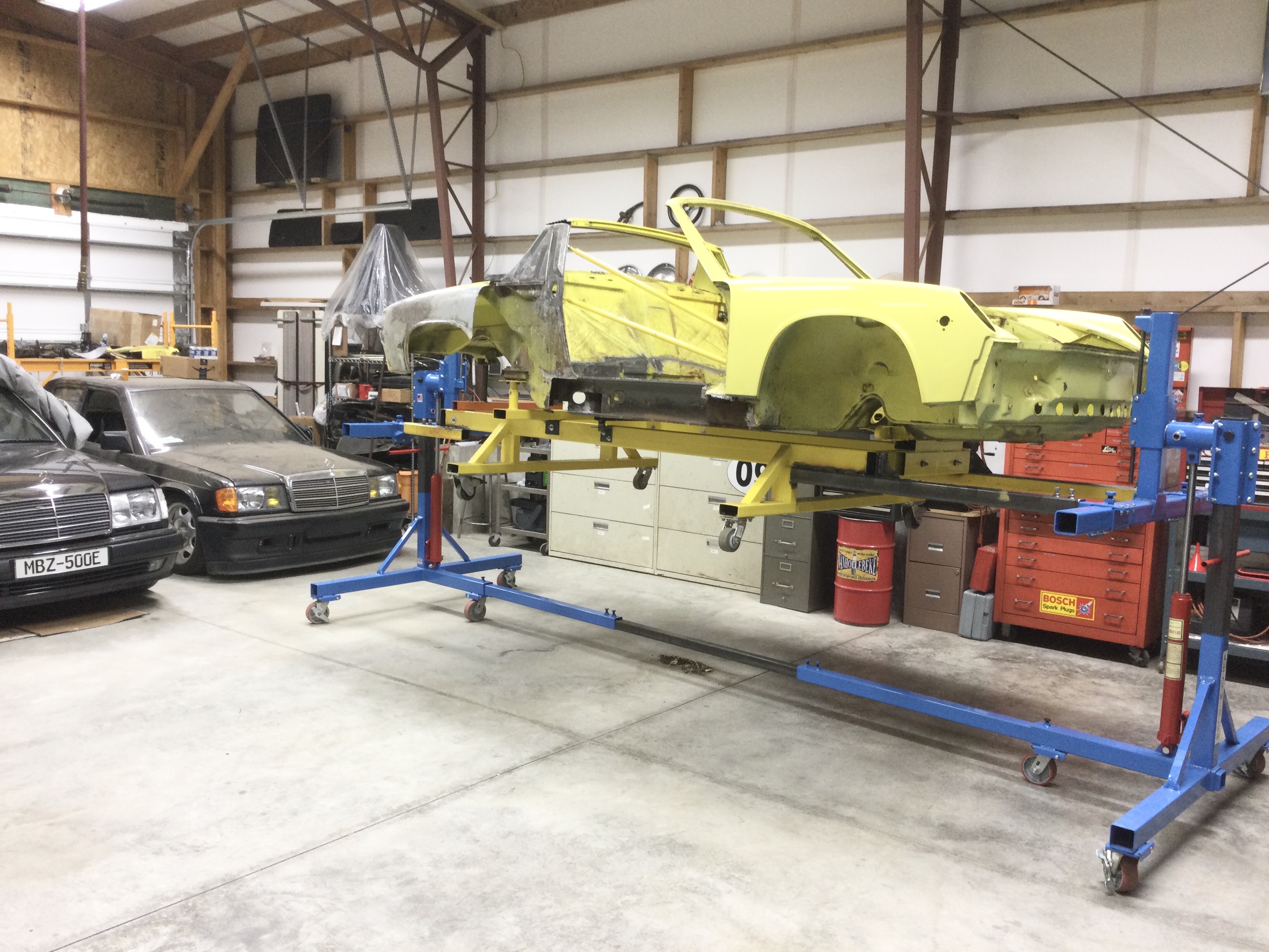

Decided to put the whole thing on an auto twirler pro rotisserie, so I can more easily reach all areas of the shell. Attached Image

Alain V.   Decided to put the whole thing on an auto twirler ...   Jan 2 2022, 04:41 PM

Zaffer   It looks great, IMHO. What rotisserie are you usin...   Feb 13 2022, 06:07 PM
Alain V.   Thanks, the rotisserie is an Auto twirler "PR...   Feb 13 2022, 09:58 PM
