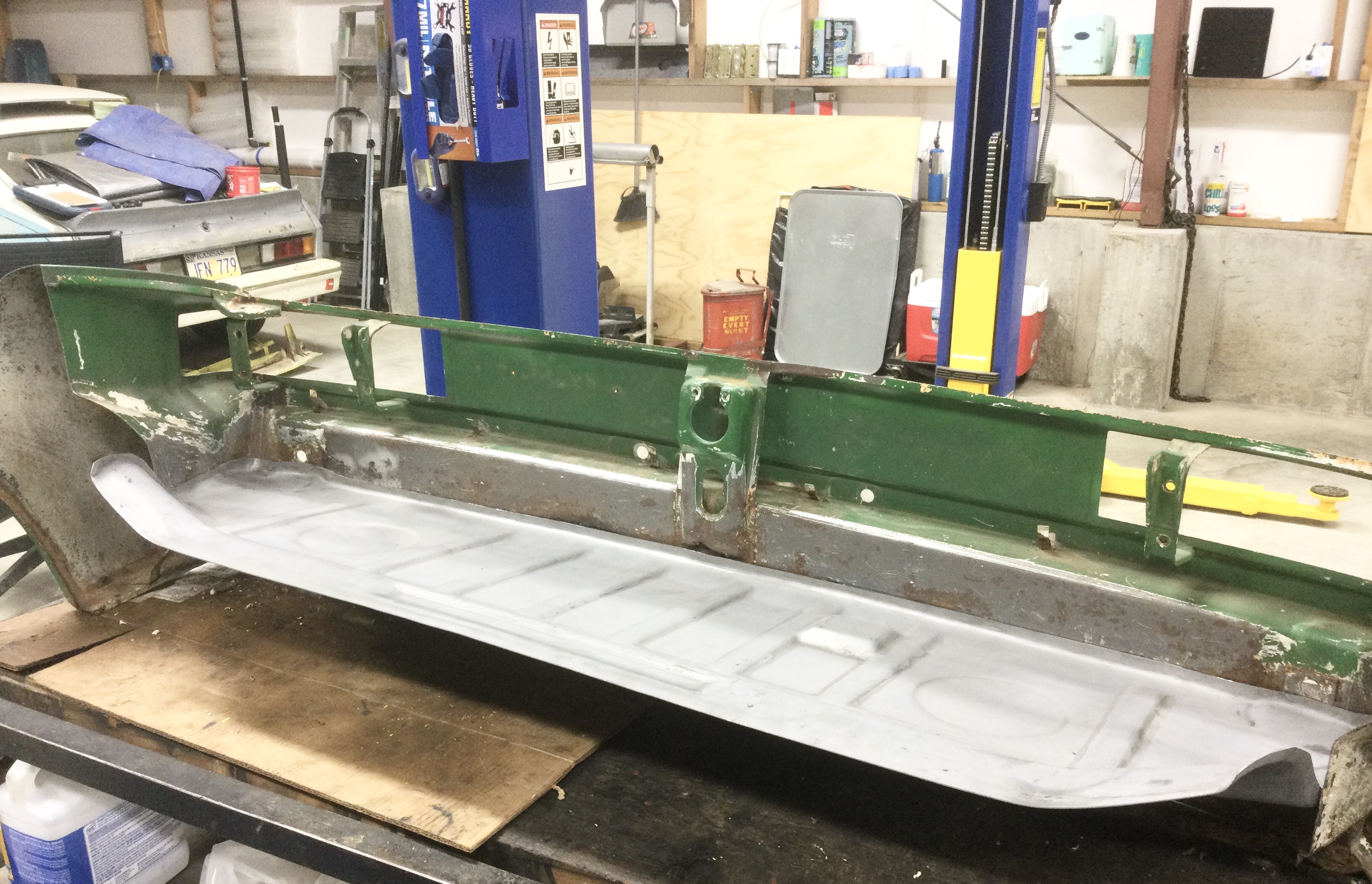

Starting to prep my new trunk panel and donor car tail panel for test fittingAttached Image

Alain V.   Starting to prep my new trunk panel and donor car ...   Jan 2 2022, 04:43 PM
Alain V.   In additi9on to the original tail panel being full...   Jan 2 2022, 04:46 PM
Alain V.   In order to get a decent fit, I made a “flexible...   Jan 2 2022, 04:52 PM
Alain V.   “Flexible shape pattern” set onto the body wit...   Jan 2 2022, 04:54 PM
