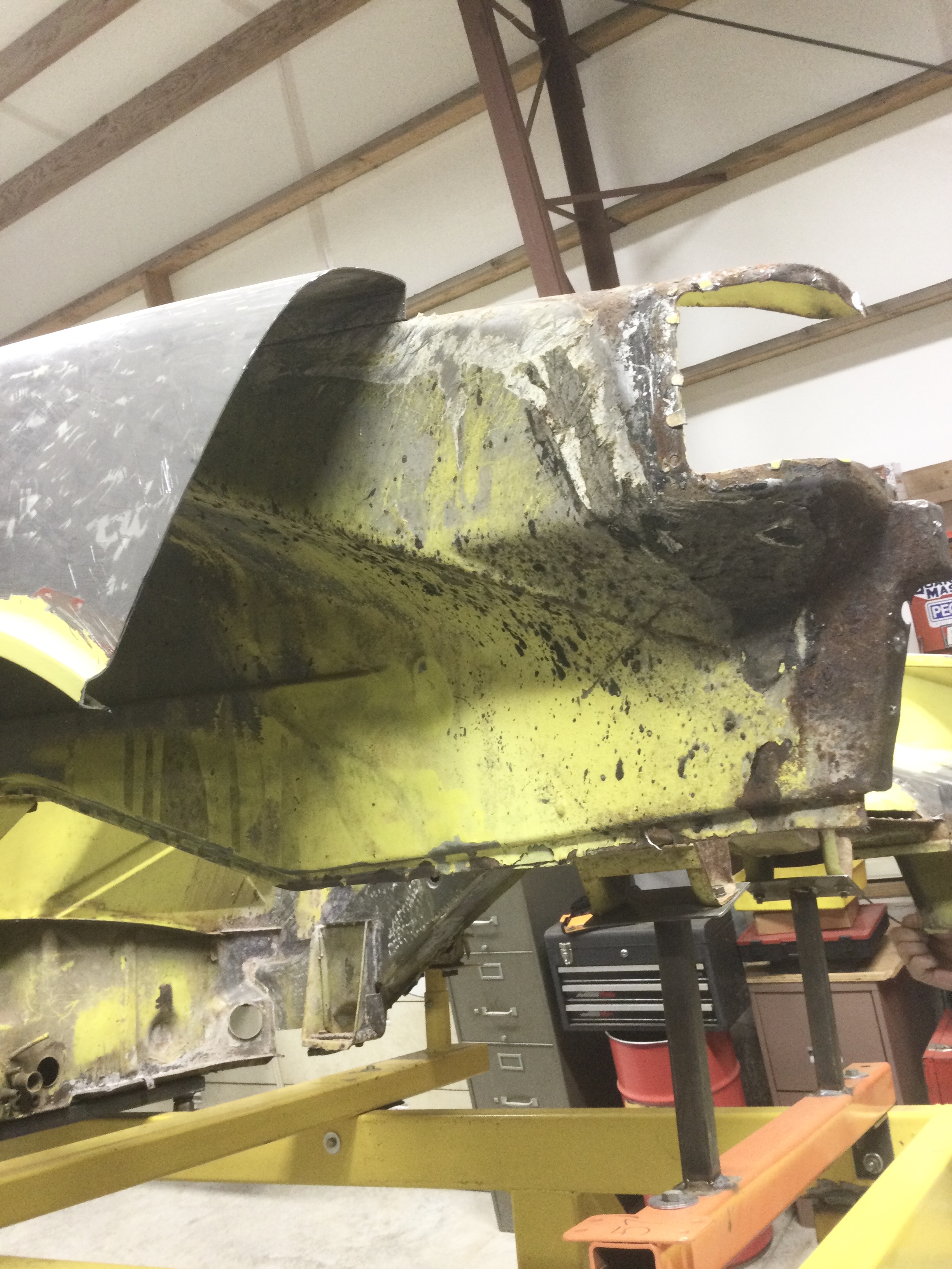

Cuts made. Before I install the rear pieces permanently, I plan to have the whole shell blasted & epoxy primed, clean etc, Attached Image

Alain V.   Cuts made. Before I install the rear pieces perman...   Jan 2 2022, 04:56 PM
Alain V.   Aaand, voila! It fits pretty good. Needs sligh...   Jan 2 2022, 04:57 PM
