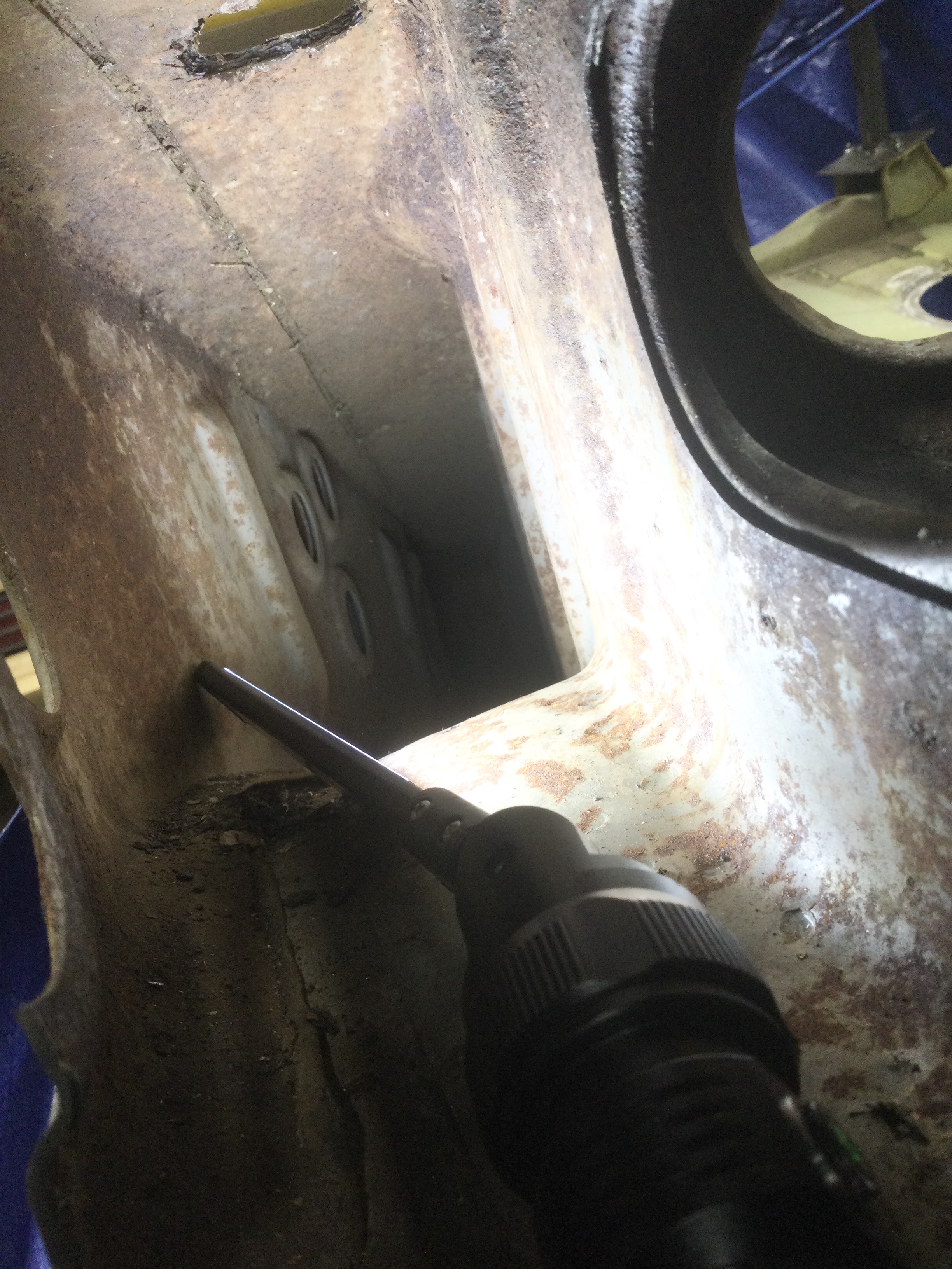

Got an idea for cleaning surface rust out of hard to reach areas, like the upper rear frame rails and center tunnel area. Here is a before shot

Alain V.   Got an idea for cleaning surface rust out of hard ...   Jan 2 2022, 05:45 PM
Alain V.   I’m going to flush the area with a rust solution...   Jan 2 2022, 05:48 PM

krazykonrad   :wttc: It looks like you've already made som...   Jan 2 2022, 05:56 PM
