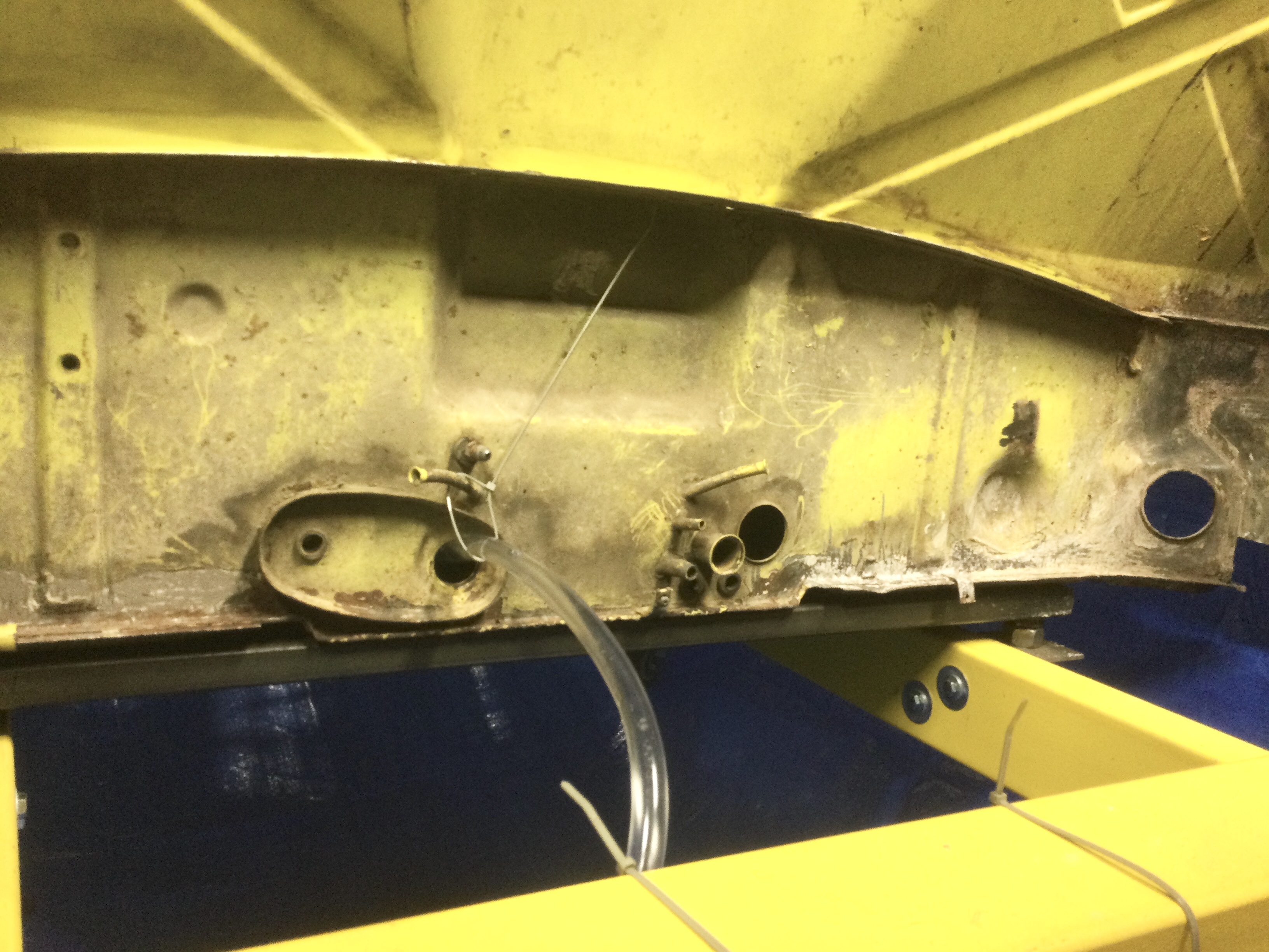

Alain V.   Got an idea for cleaning surface rust out of hard ...   Jan 2 2022, 05:45 PM
Alain V.   I’m going to flush the area with a rust solution...   Jan 2 2022, 05:48 PM
lesorubcheek   I’m going to flush the area with a rust solutio...   Jan 2 2022, 08:31 PM
Alain V.   RE: 72 rustoration / subaru 6cyl project in Kansas   Jan 2 2022, 05:49 PM
Alain V.   RE: 72 rustoration / subaru 6cyl project in Kansas   Jan 2 2022, 05:51 PM
Alain V.   After flushing.   Jan 2 2022, 05:52 PM
Alain V.   RE: 72 rustoration / subaru 6cyl project in Kansas   Jan 2 2022, 05:52 PM
Alain V.   RE: 72 rustoration / subaru 6cyl project in Kansas   Jan 2 2022, 05:53 PM
