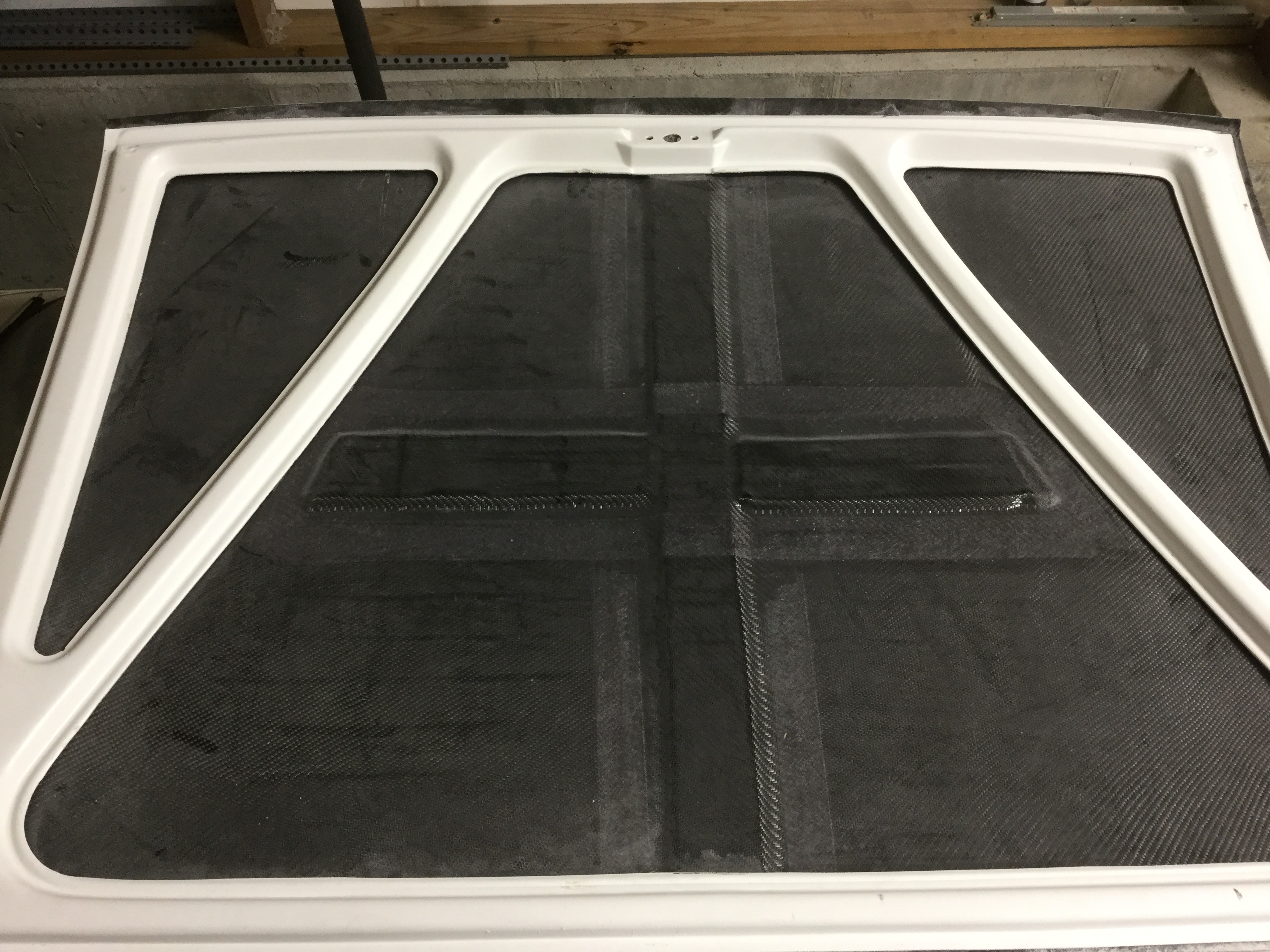

I'm going to do my best to reach that goal weight.
I've already got a pair of carbon fiber lids from 914 Rubber.
Since I'm using the lightweight lids, I've eliminated all of the original springs & associated brackets.
Every non-essential bracket on the body is being removed,,,or swiss cheesed.
I'm also going to make a GT style engine cover, fiberglass bumpers. Entire car will be "de-badged" (we don't need no stinking badges!....too heavy!)
