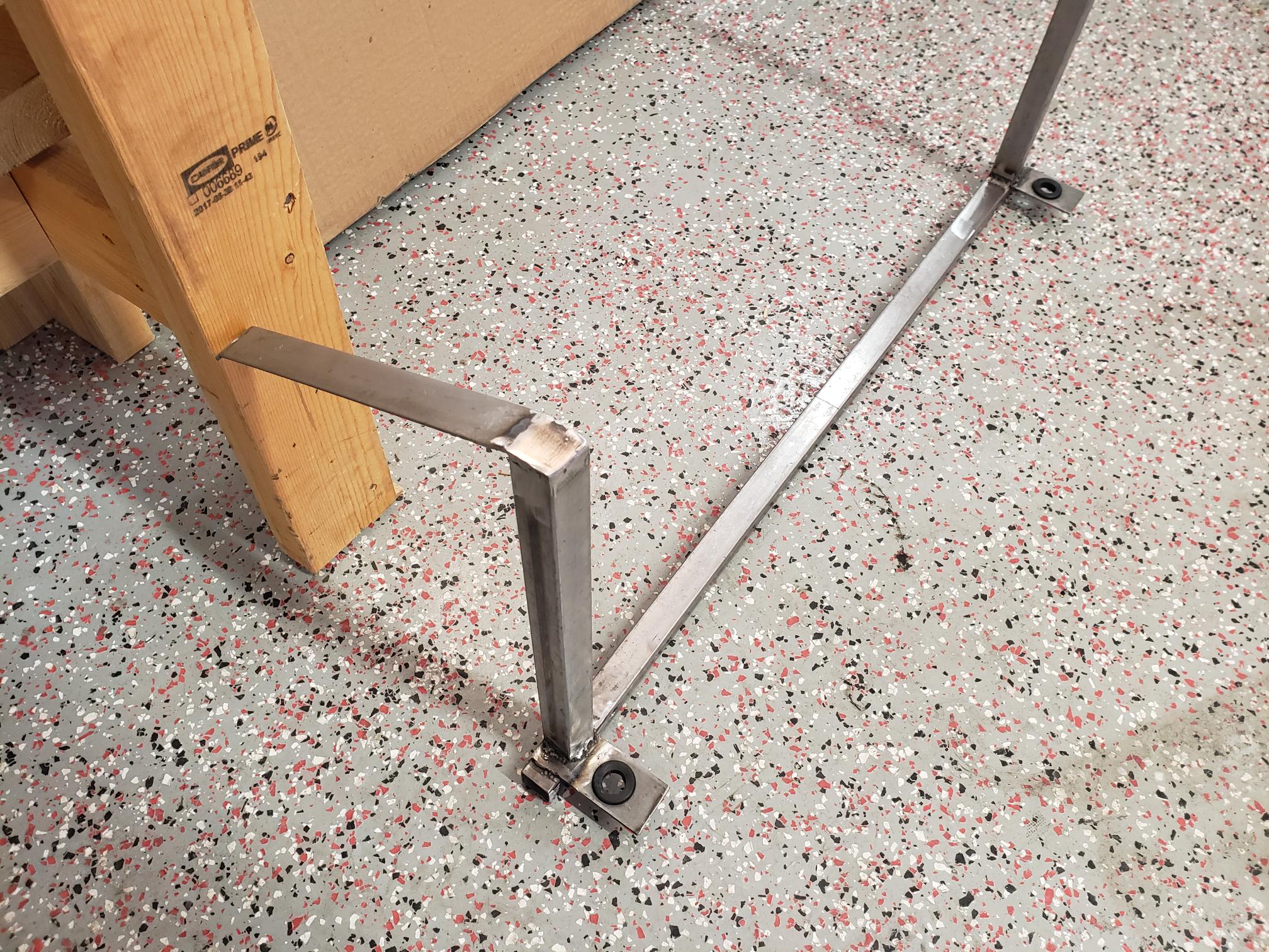

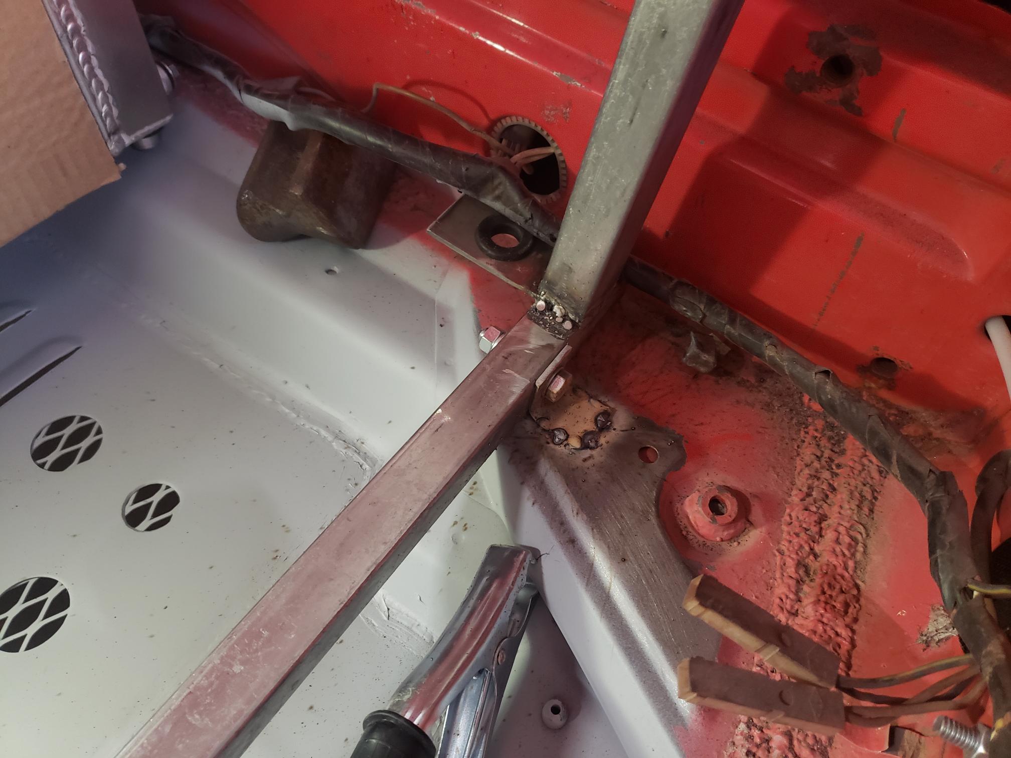

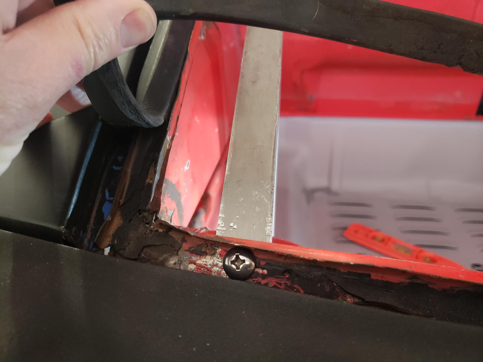

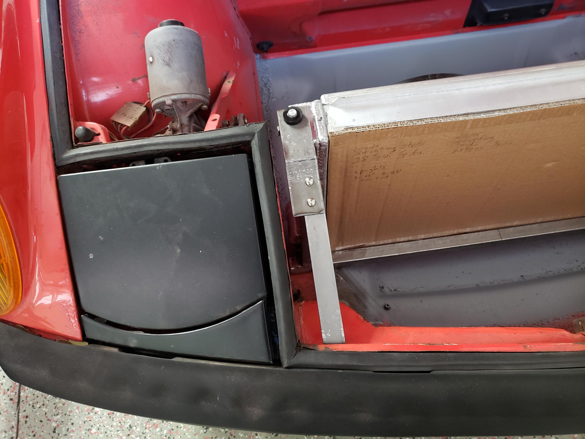

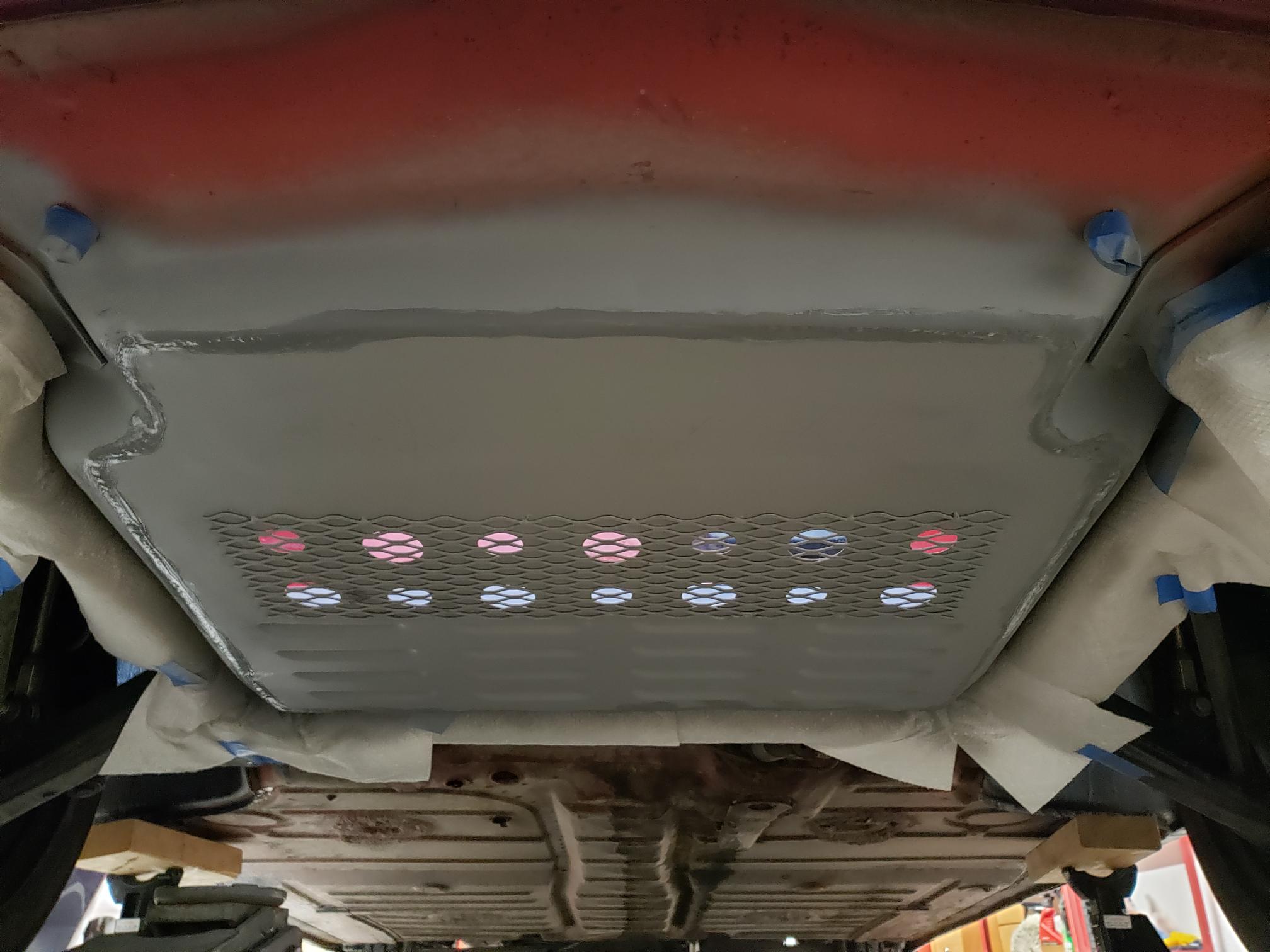

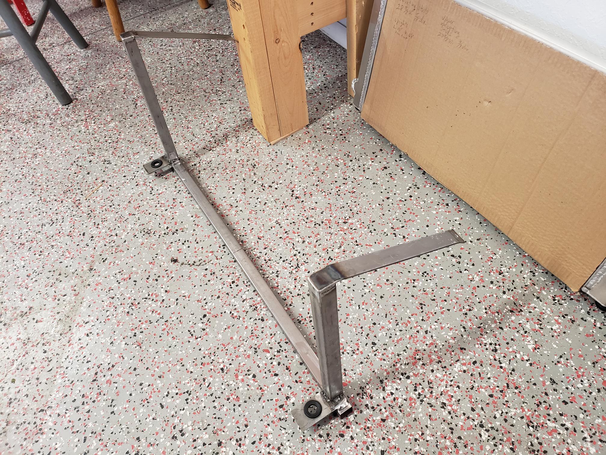

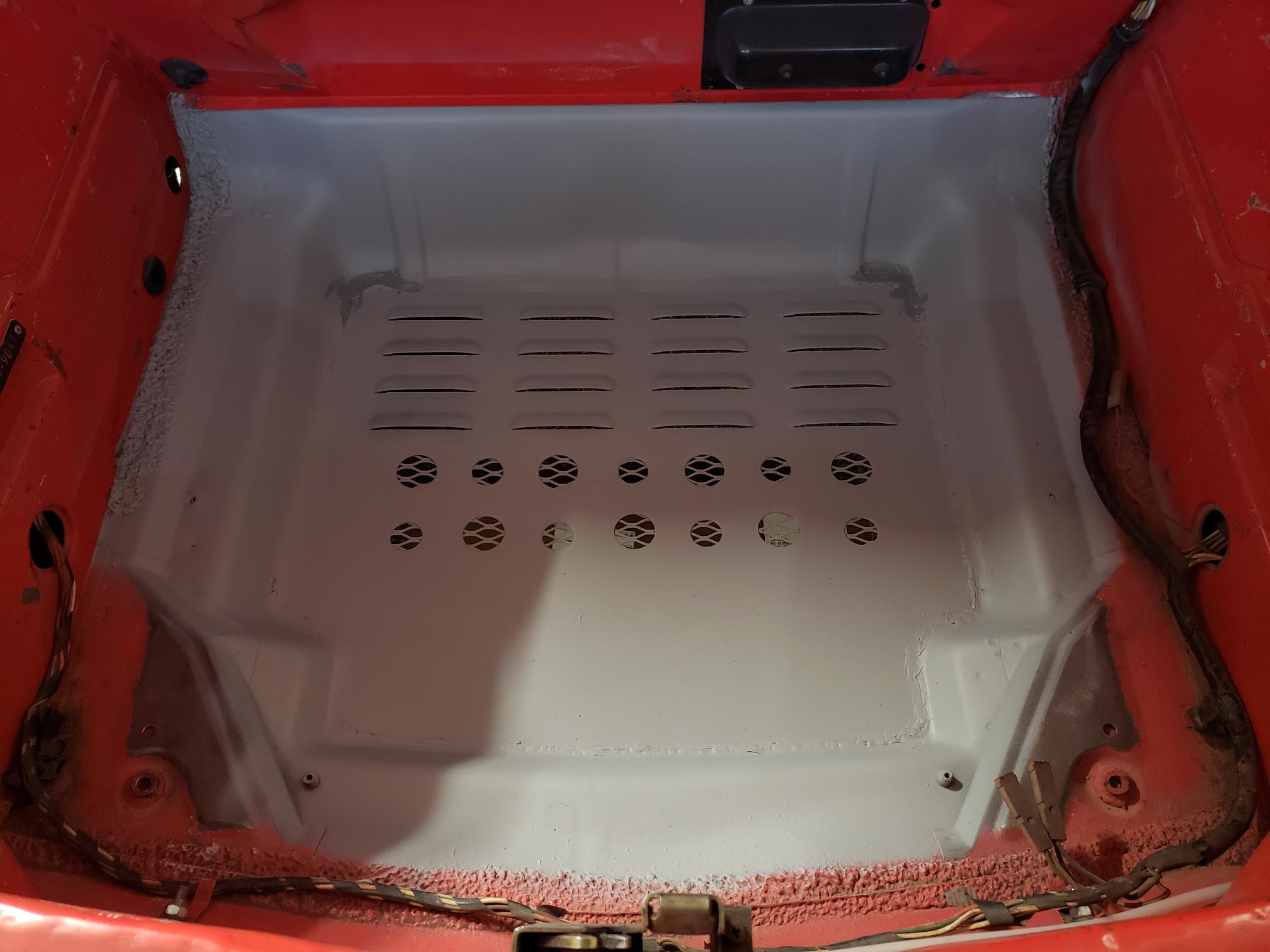

Work continues on the frunk-mounted cooling system. I got the vented floor pan welded in place, seam-sealed and primed. It felt great to repair that floor pan, even though its a different approach than I may have envisioned originally.
To mount the radiator frame to the floor, I made two tabs from 1/8" bar steel, drilled and bolted them to the bottom frame rail, then welded them to trunk floor. This way, the entire frame can be unbolted from the car relatively easily.
I bent and welded 1" bar steel supports to connect the upper frame to the front of the car. I lifted the weatherstripping and drilled holes for low-profile bolts to connect the supports.
The final piece to be able to mount the radiator was to create tabs to be bolted to the upper frame supports that are also grommeted to the top rad mounting pins. By removing the bolts (nuts are welded underneath), I can easily remove the radiator.
I'm actually going to re-do the tab design because I'm not happy with how it looks, but for now, the radiator is in position the way I planned.
Next step with be to start on the shroud design and execution, so we'll see how that goes. Happy New Year!
