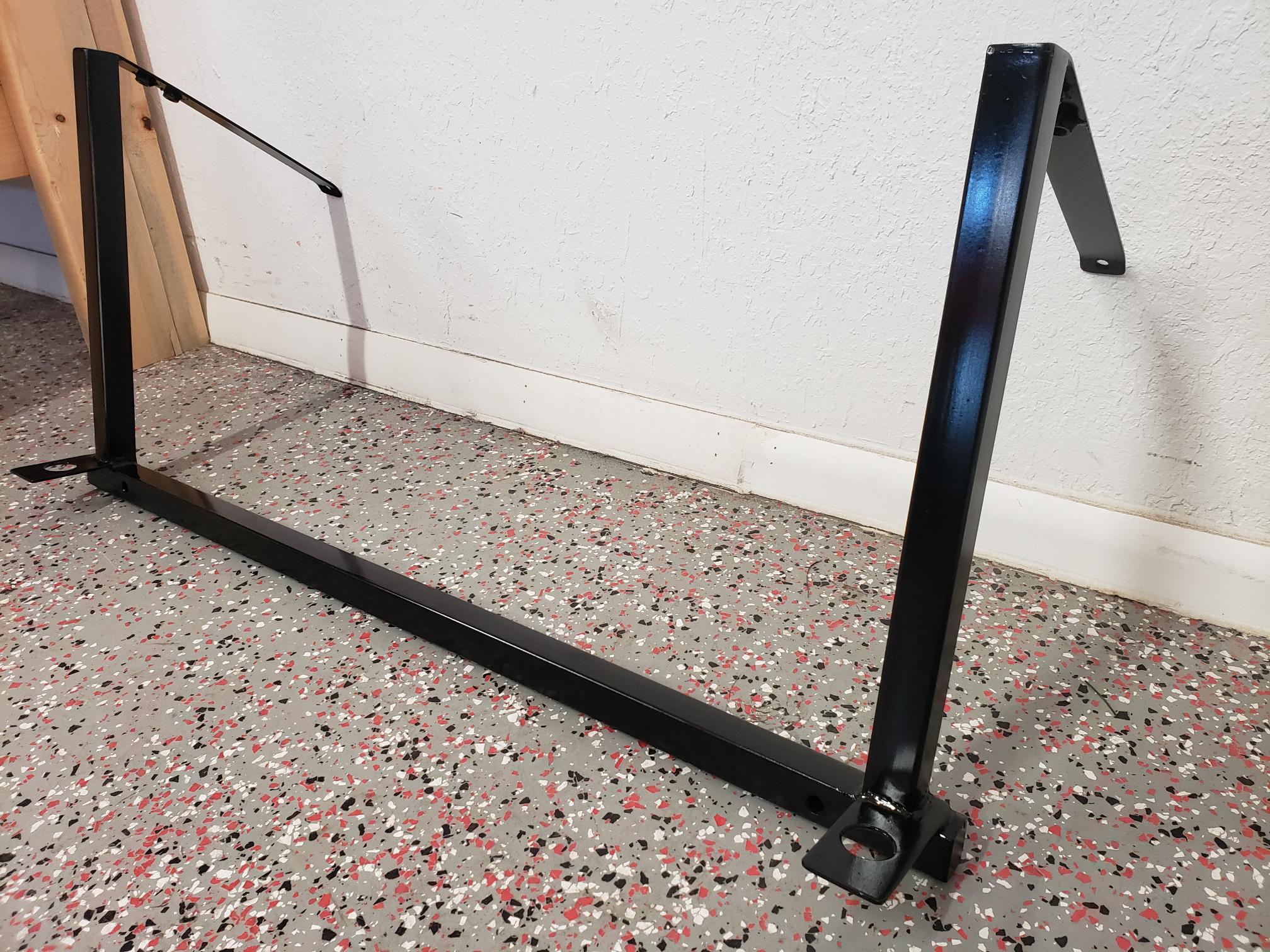

Made a little more progress on the radiator frame over the weekend. I welded on nuts to the frame arms to mount the tabs that will be grommeted to the radiator. I trimmed the lower frame crossmember, then cut tabs from 1" bar steel to cap off the ends. Did some more grinding on the welds, then finished them off with some JB Weld. Primed, then painted with gloss black VHT Chassis paint. Powdercoating would have been nice, but not in the budget at the moment.

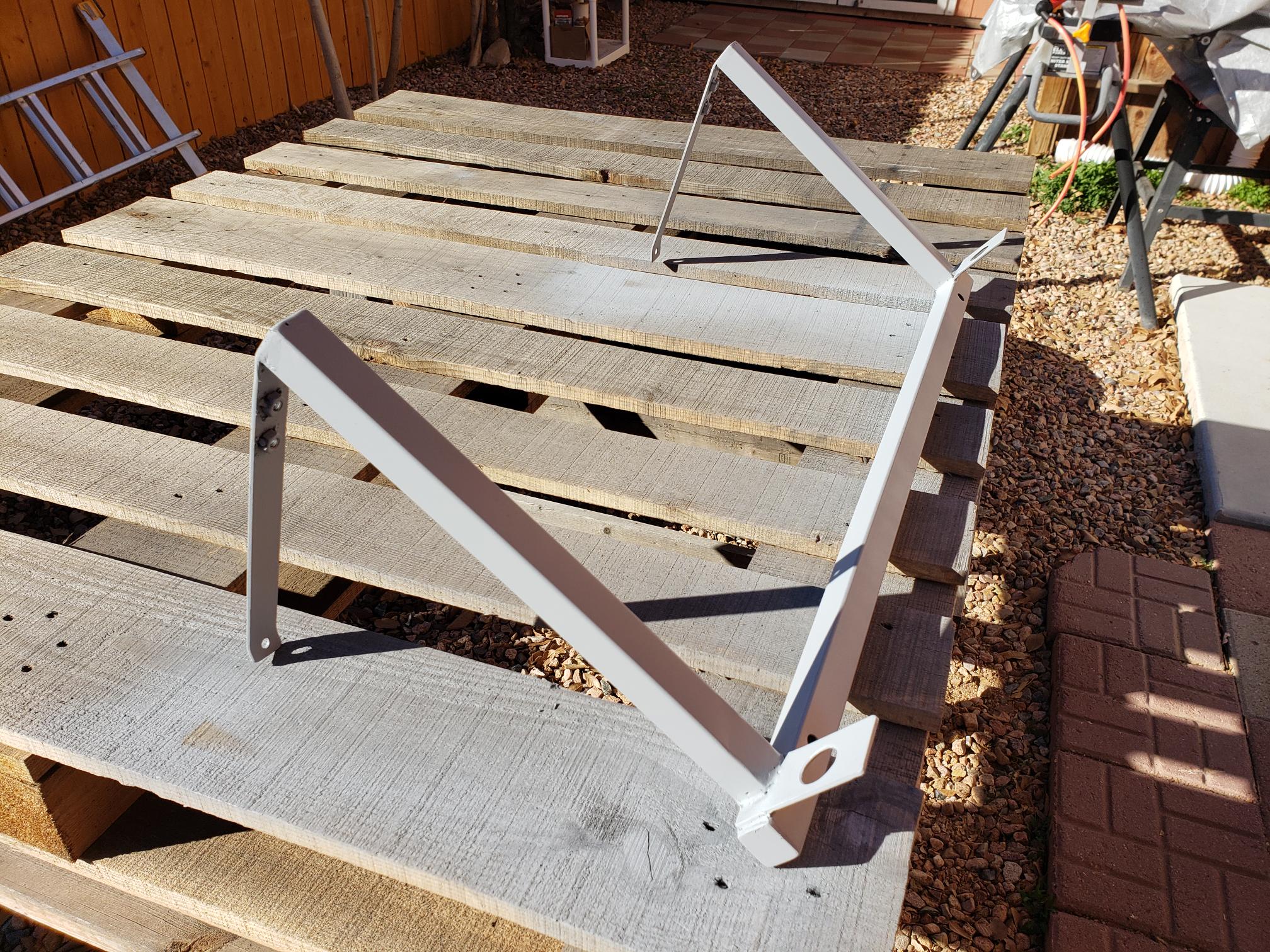

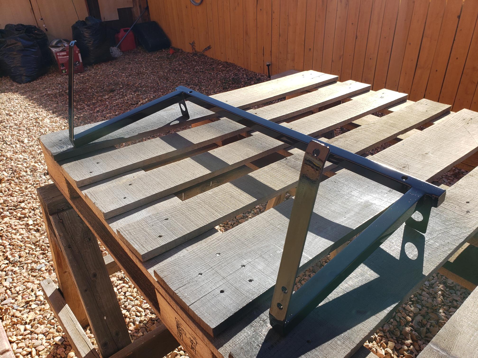

Mayne   Work continues on the frunk-mounted cooling system...   Jan 6 2022, 03:13 PM

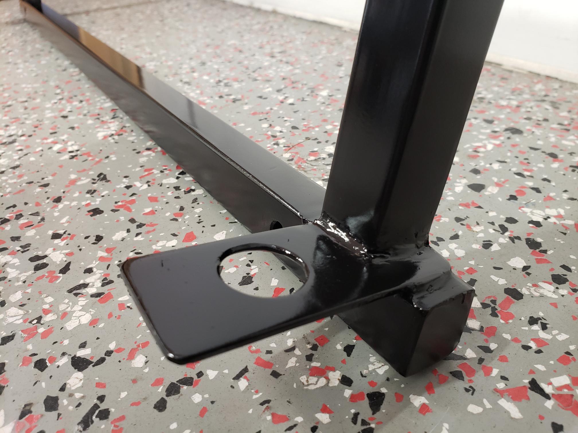

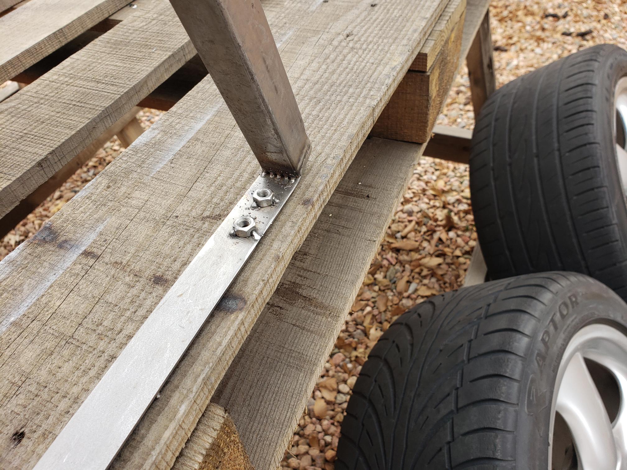

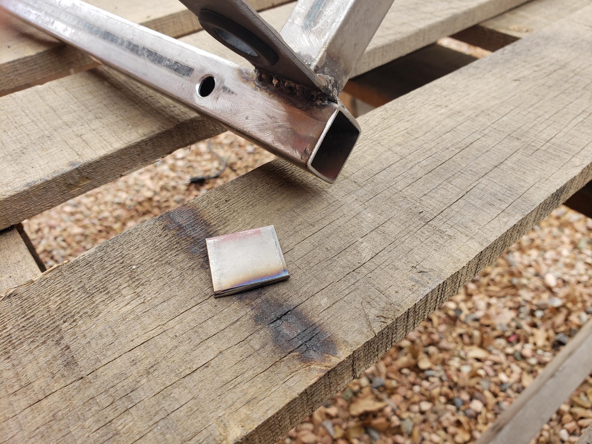

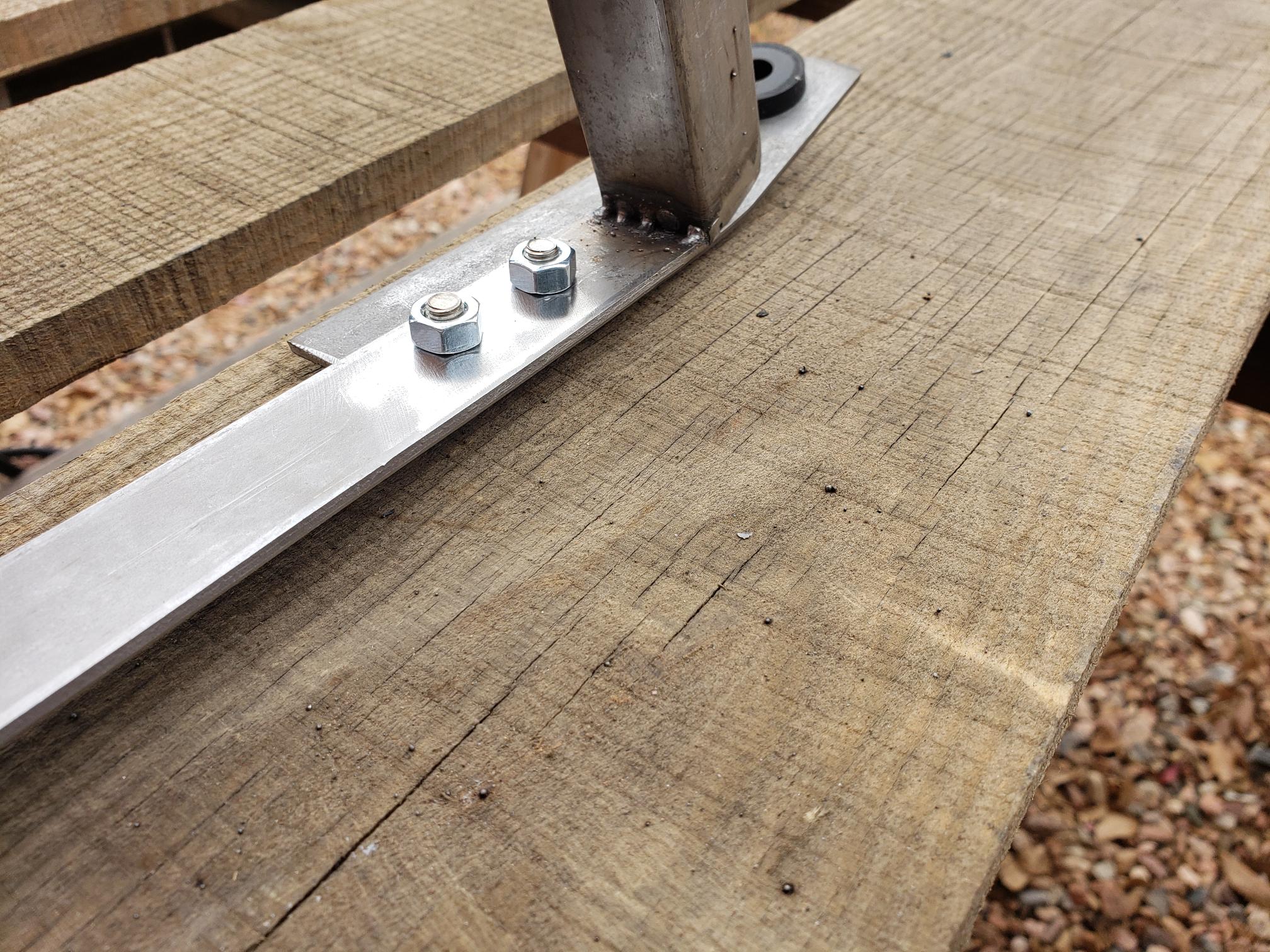

Mayne   Made a little more progress on the radiator frame ...   Jan 10 2022, 09:11 PM
