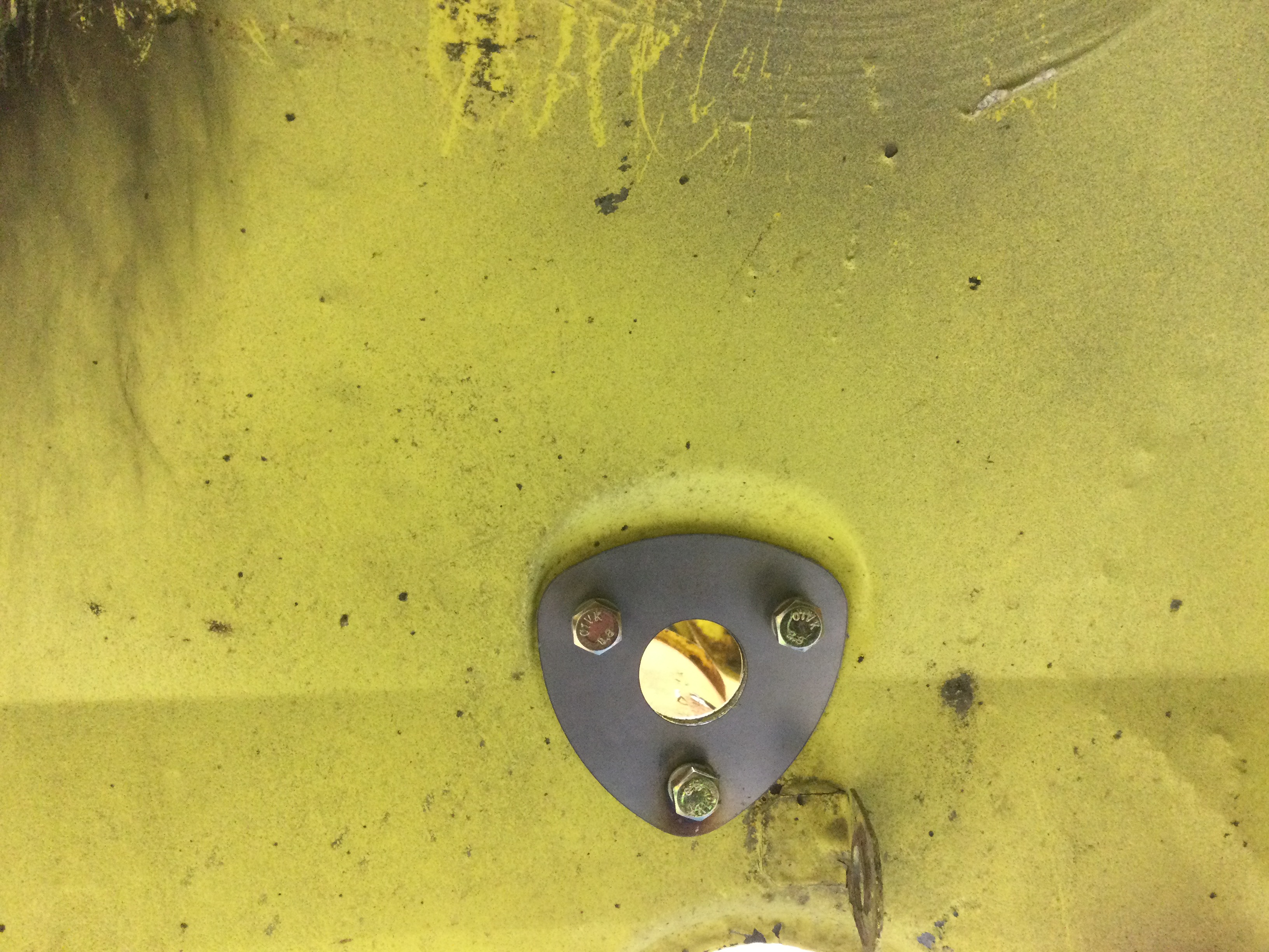

I drilled and test fit the brackets for the front sway bar today.
I’ll weld them after cleaning paint off the area and coating with weldable primer.

Alain V.   Well, not much progress to report.......... But I ...   Jan 16 2022, 05:30 PM
