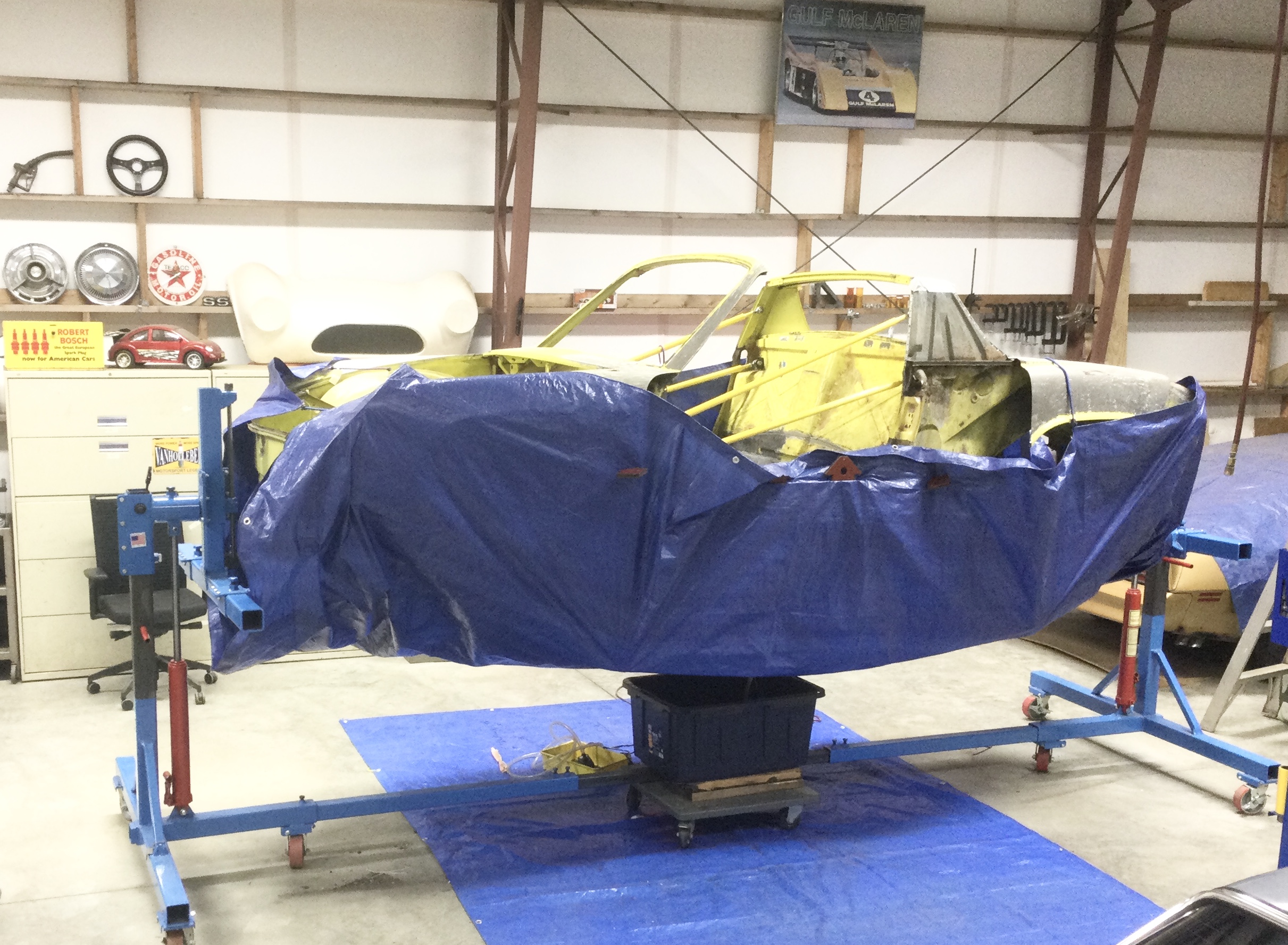

I also had to wait for a fresh gallon of rust treatment as my original solution became contaminated and weakened.
I still have an area on the driver side that I don’t think a blaster will reach, so I’m treating that spot with the solution.
Once it’s finished, I hope to be able to finish welding various little holes, etc on the tub before blasting and epoxy coating.Attached Image

Zaffer   It looks great, IMHO. What rotisserie are you usin...   Feb 13 2022, 06:07 PM
Alain V.   Thanks, the rotisserie is an Auto twirler "PR...   Feb 13 2022, 09:58 PM
