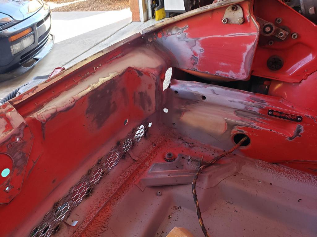

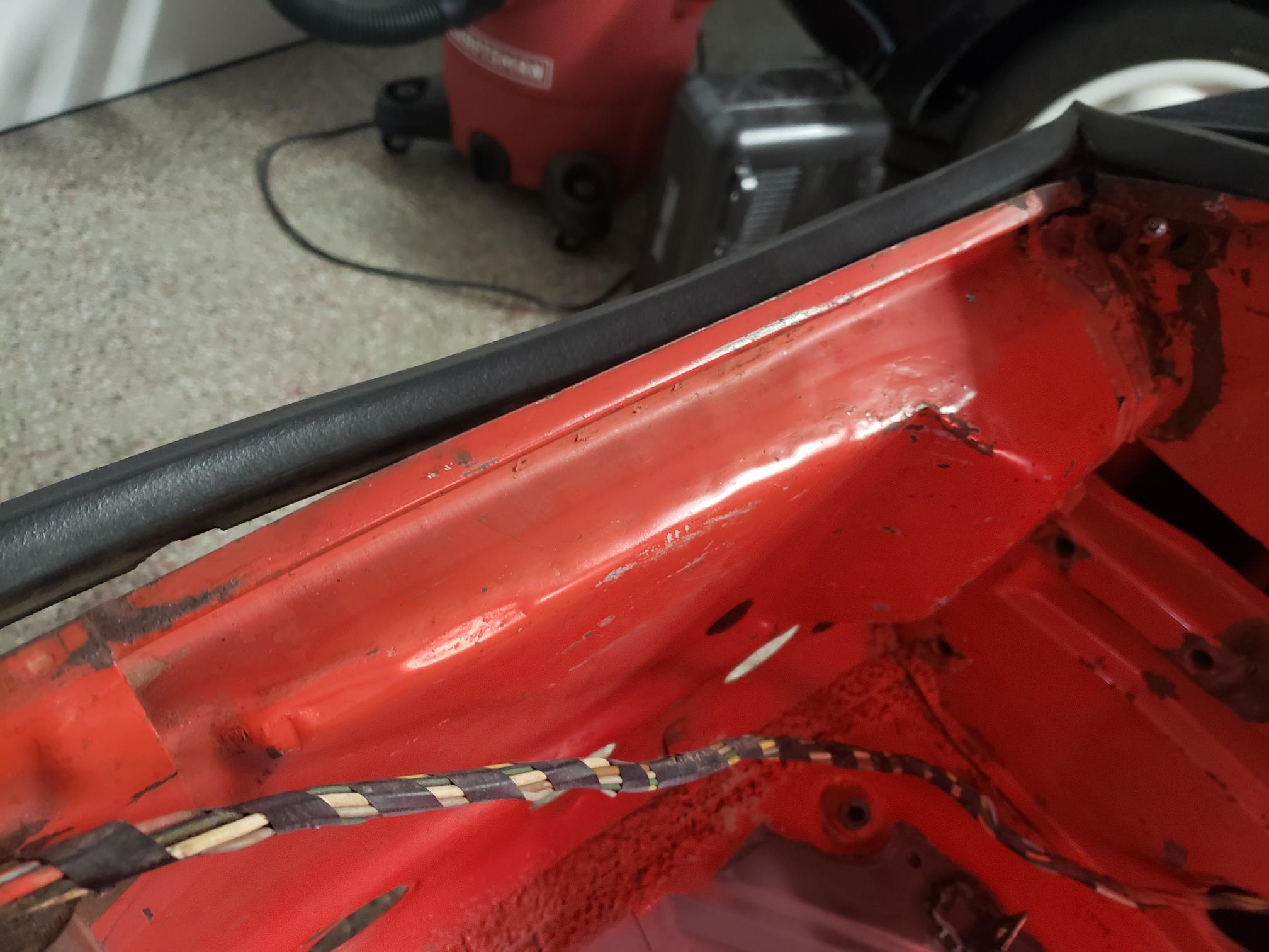

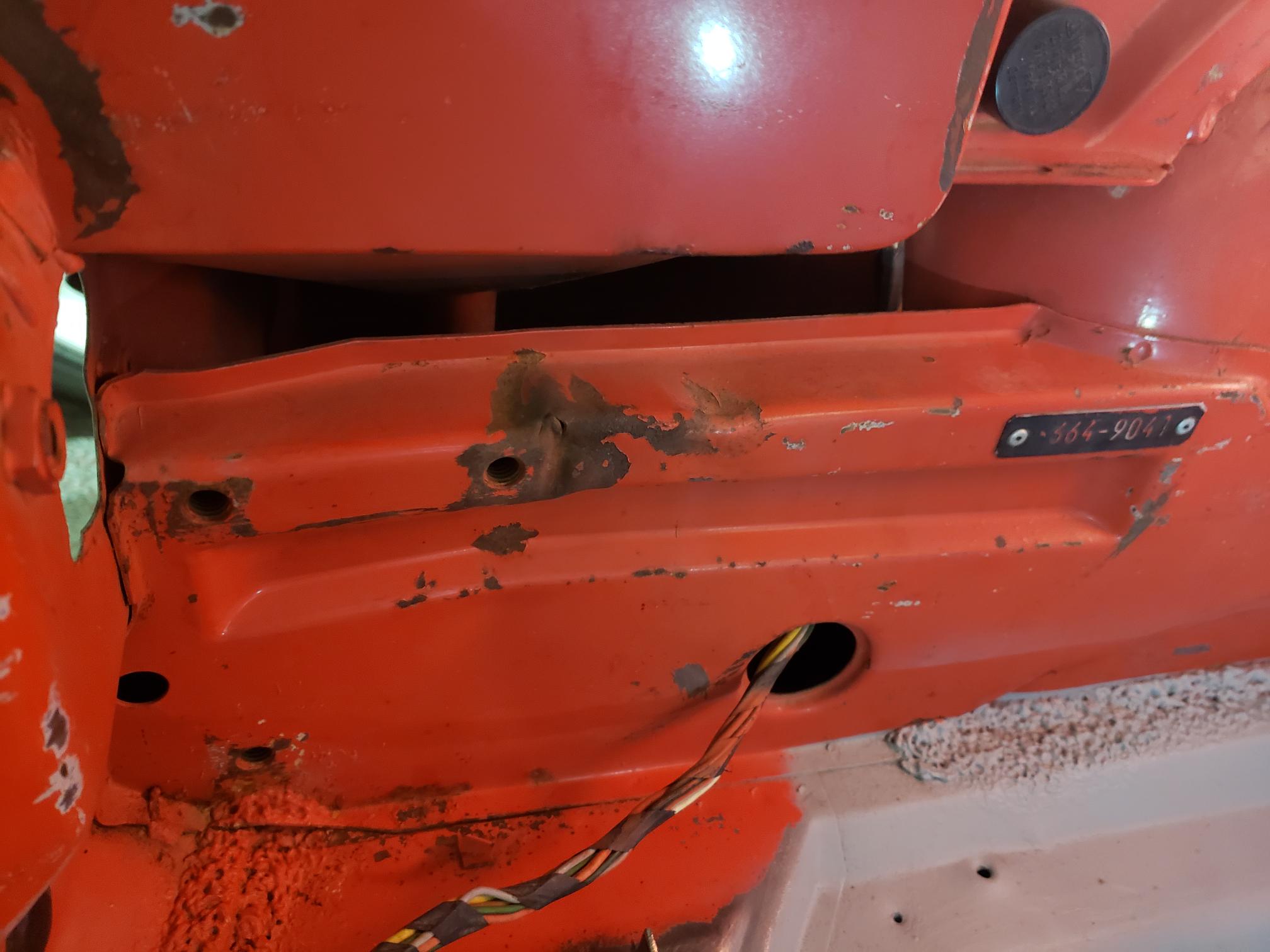

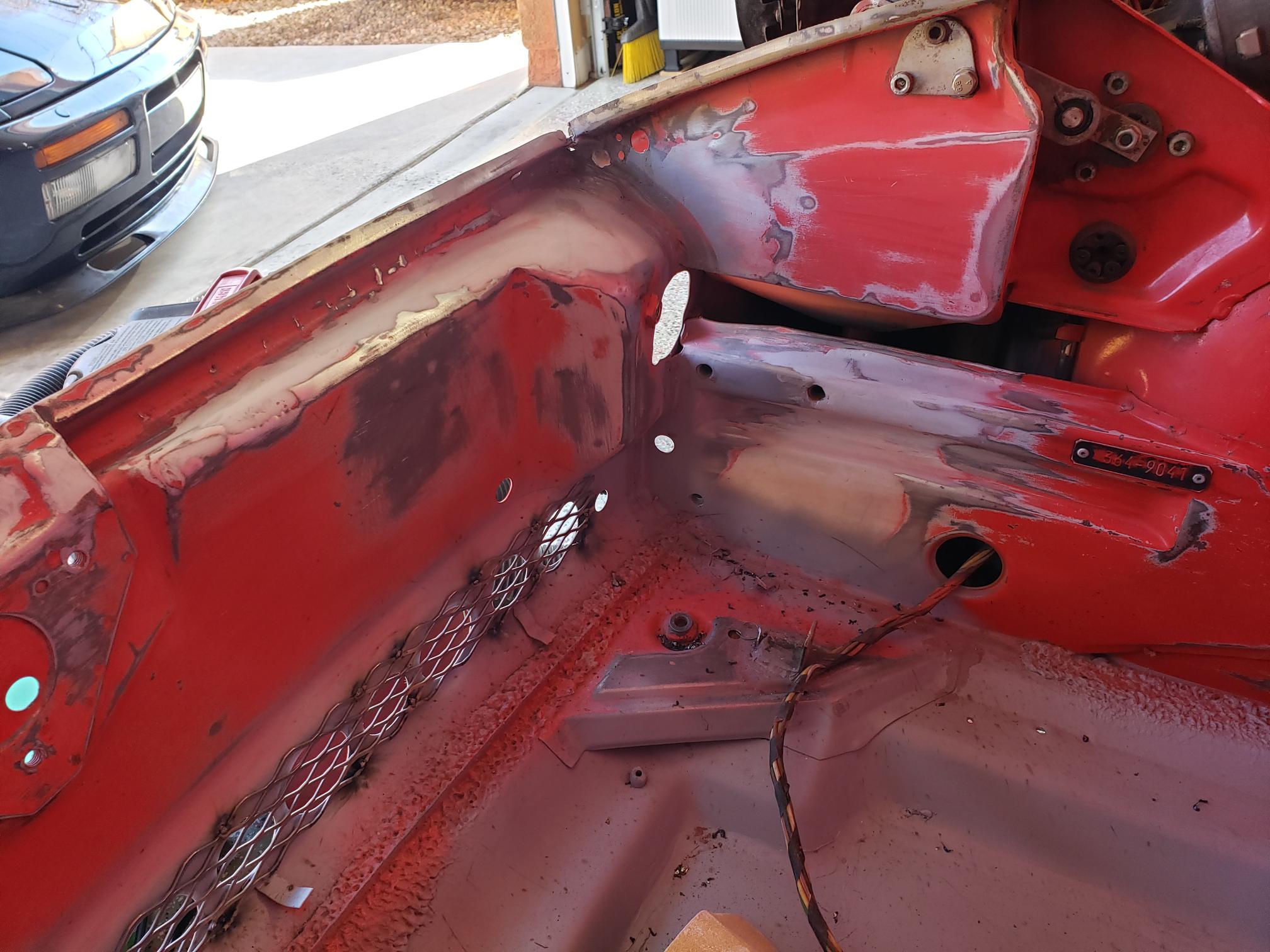

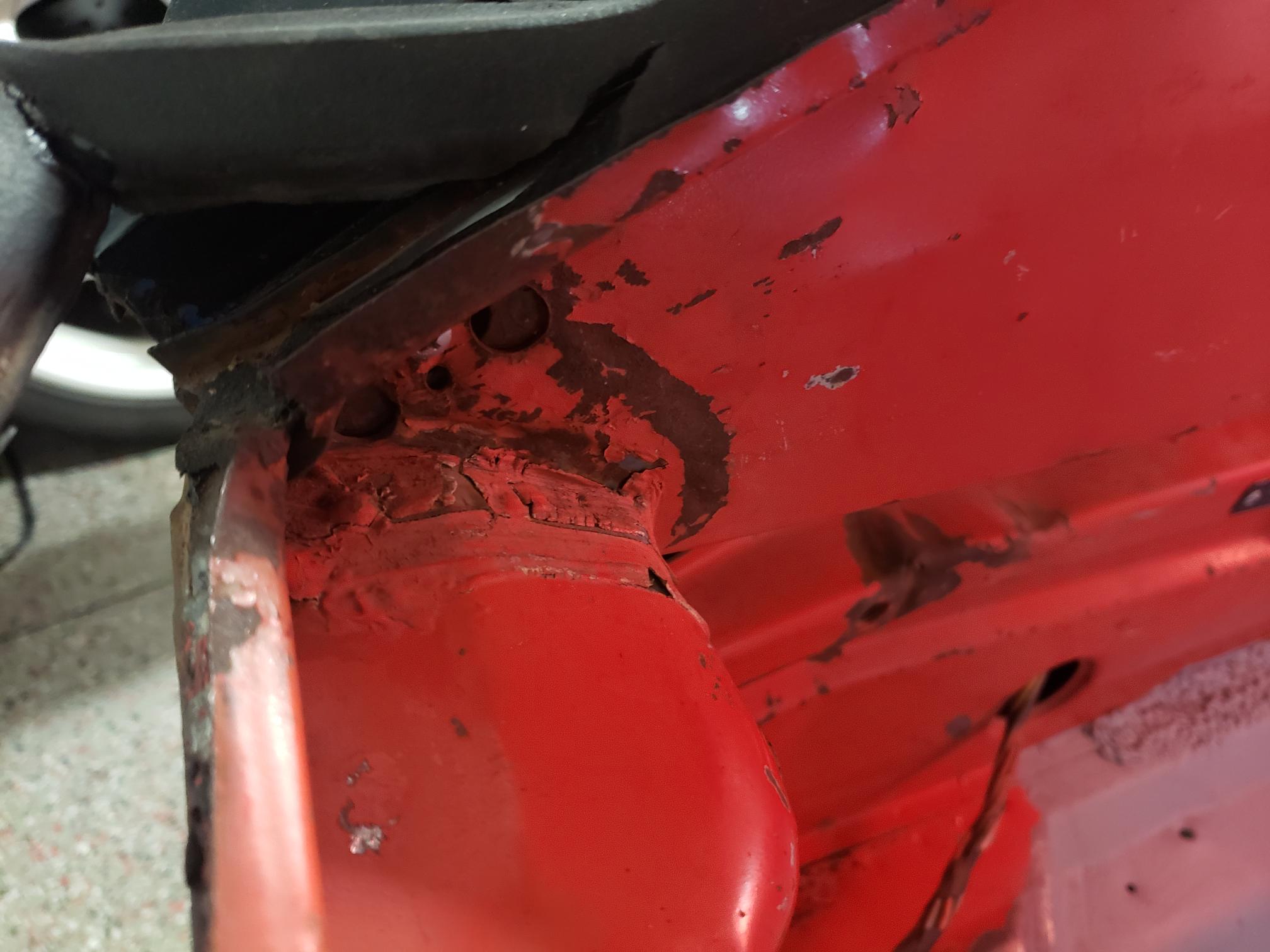

In working on the front of the car so much, I decided to deal with some body damage that has bugged me for as long as I've owned the car. I wasn't really planning on doing it at this stage, because I really want to complete the Subaru 6 conversion to the point of running and driving before I tackle body and paint. But dealing with the front end damage (to some extent, at least) makes me feel better moving forward.
I also plan to do similar work in the engine bay before putting the new engine in, so when it is finally time to strip it down for paint, much of the "B surface" work will be pretty good. I know many people start with paint and body, then do the powertrain, but for me it makes the most sense to do any cutting, welding and modifying to the body first so I don't have to cut into a freshly painted body (though I'm sure some of that will have to happen anyway).
I detailed some of this in a separate thread recently, so I'm just getting all the info into the build thread here.

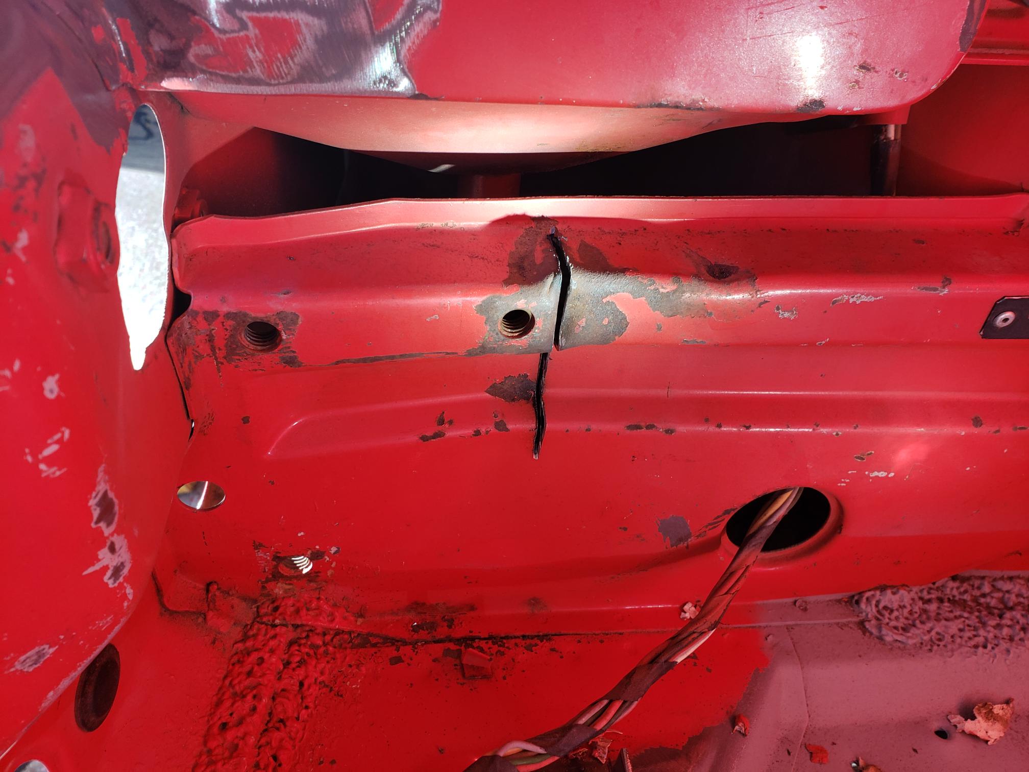

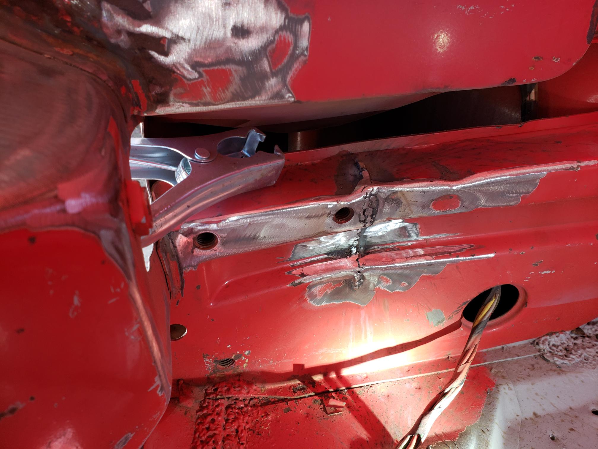

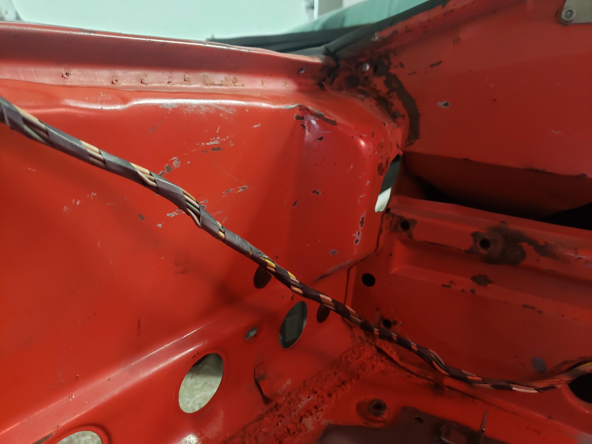

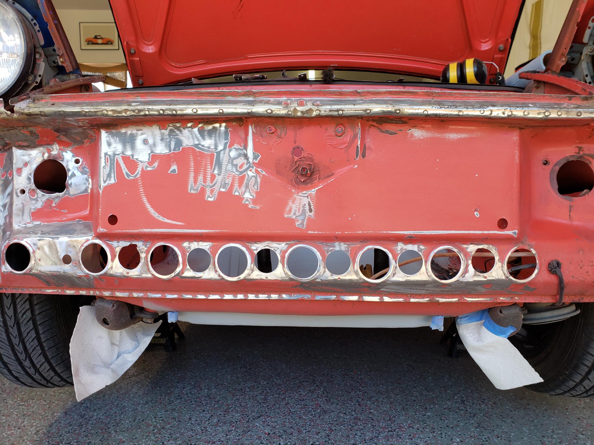

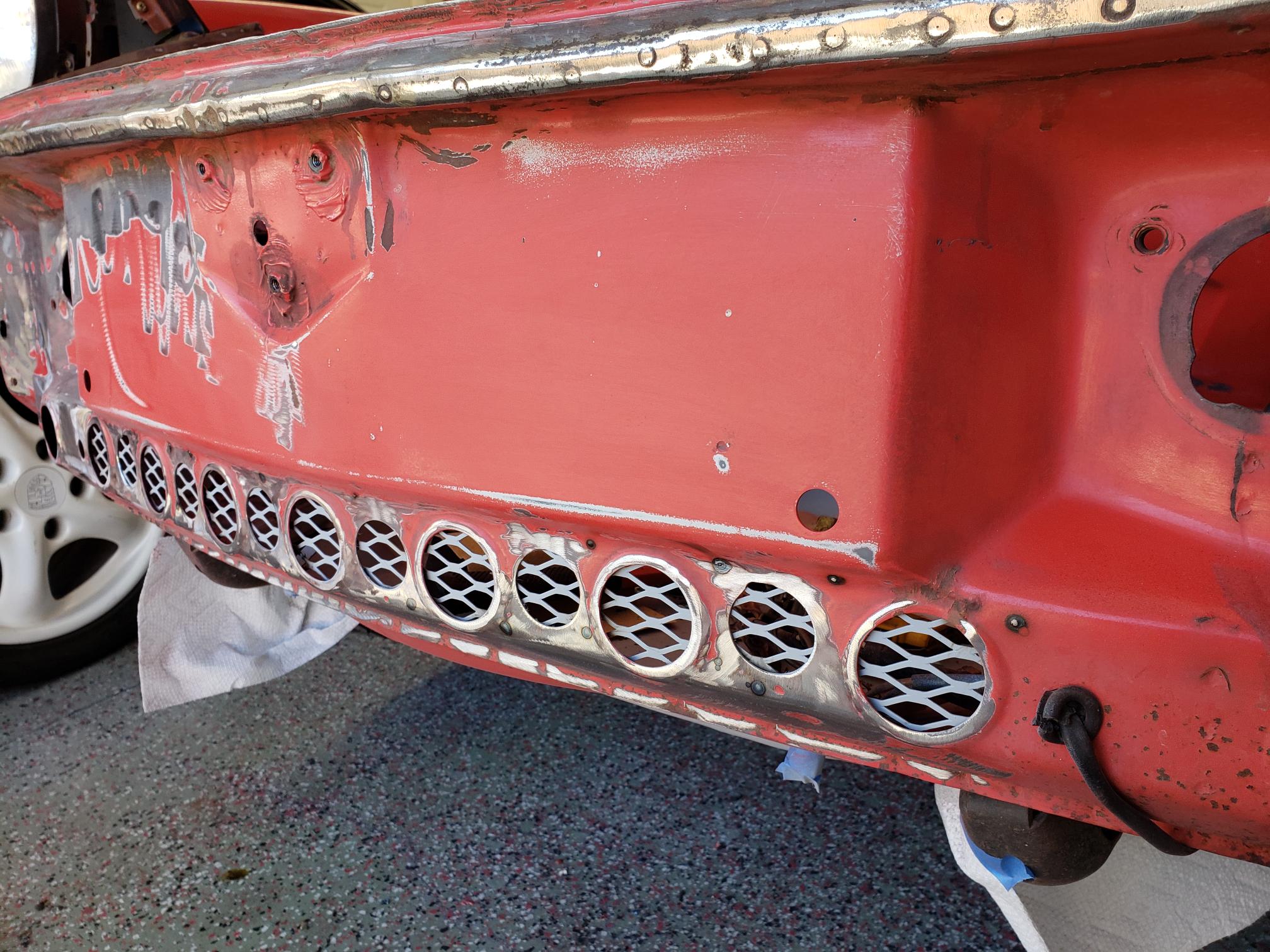

Body damage and surface rust. The structure was reasonably pulled, but there was no effort to treat the bare metal, so a lot of superficial rust:

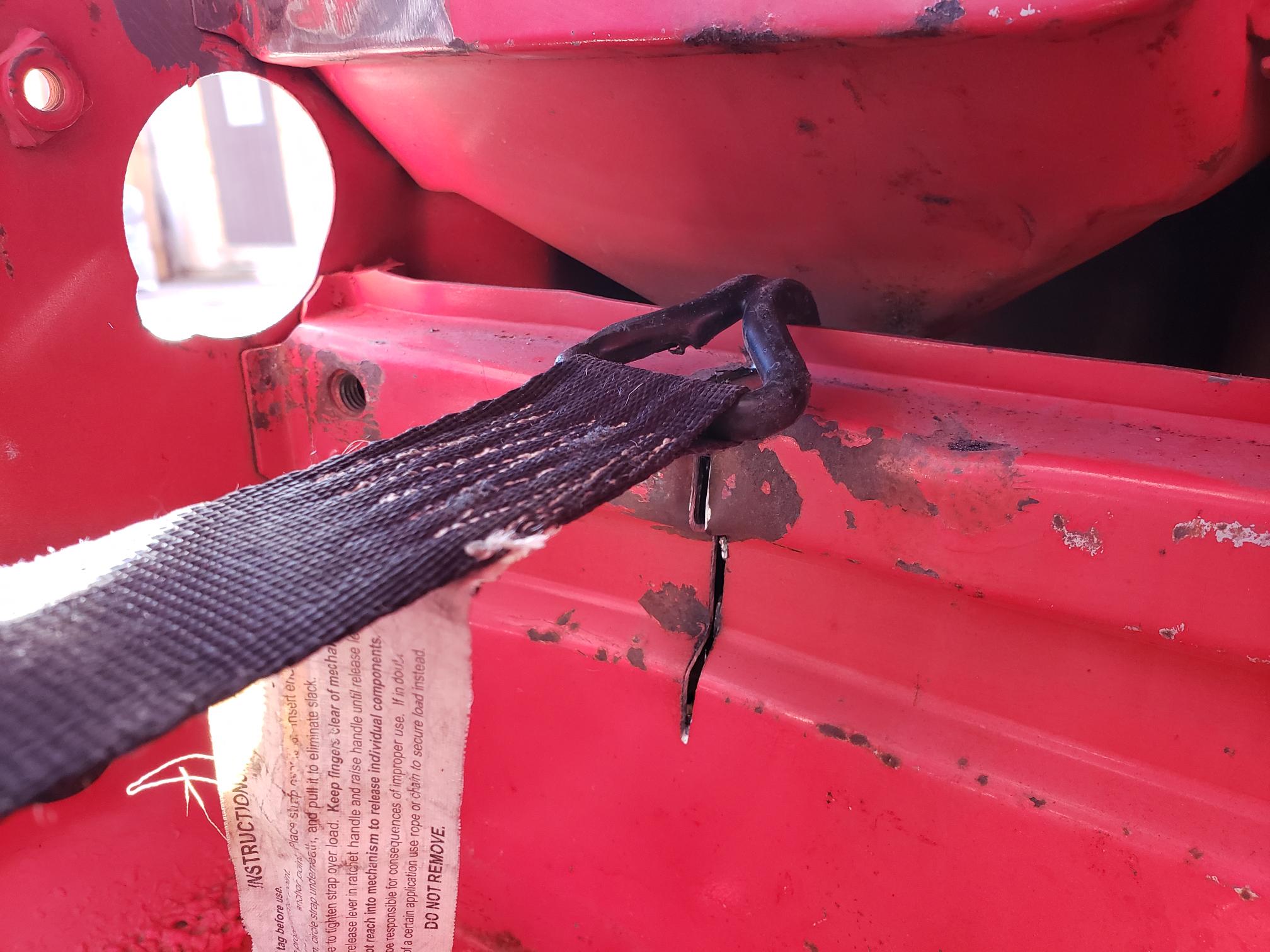

I cut the worst of the kink, then put a ratcheting strap on it to pull it inward a little. This really didn't move it too much, though maybe if I had cut it more, it would have. At any rate, added some metal to the opening and welded it up. I did some hammer and dolly work, then added some filler and seam sealer.

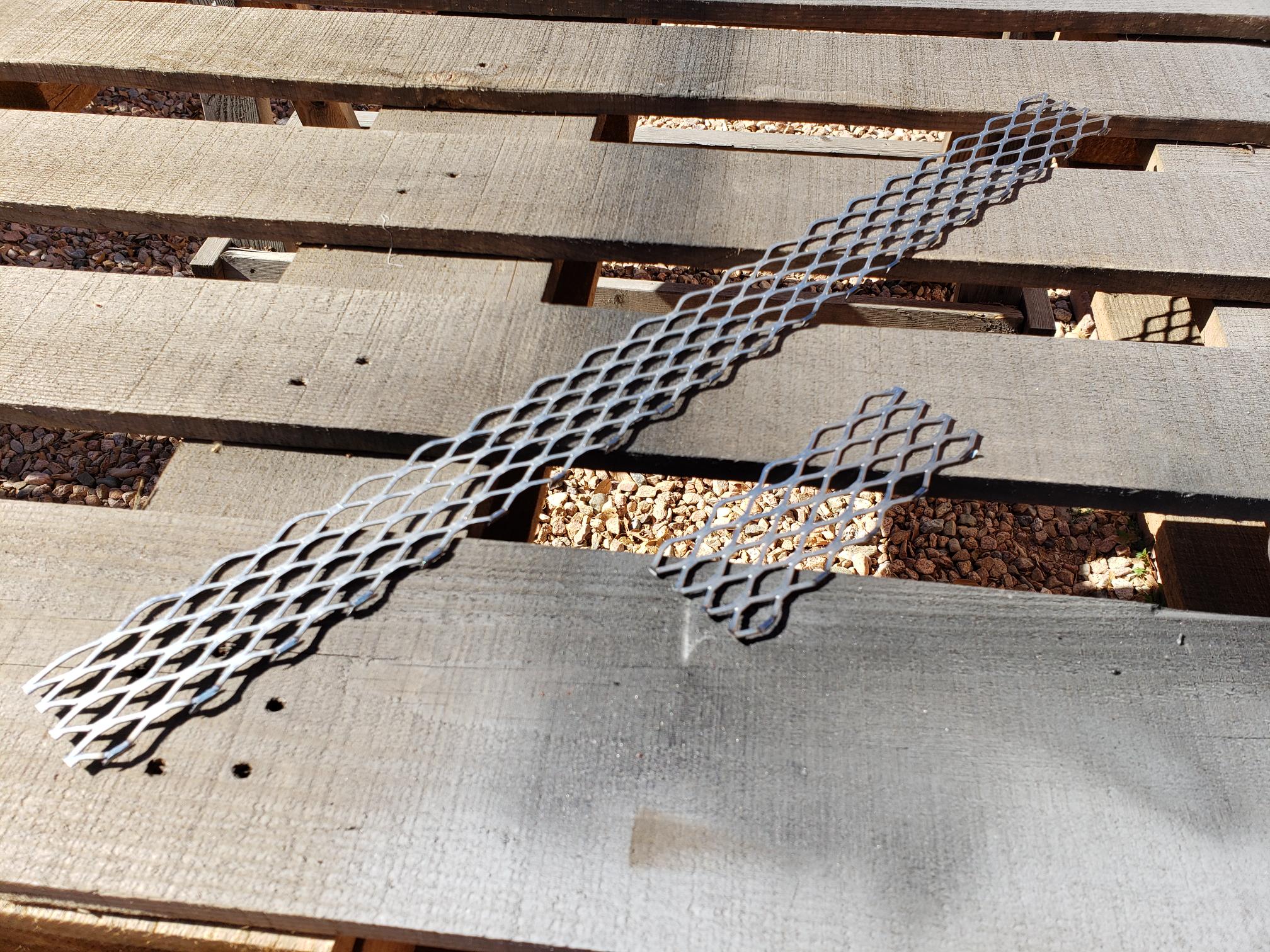

Before priming, I added extra holes between the factory holes in the nose for better airflow to the radiator. I cut some mesh, which wasn't quite long enough to span the distance. A few spot welds made it into one piece and I tacked it into place.
