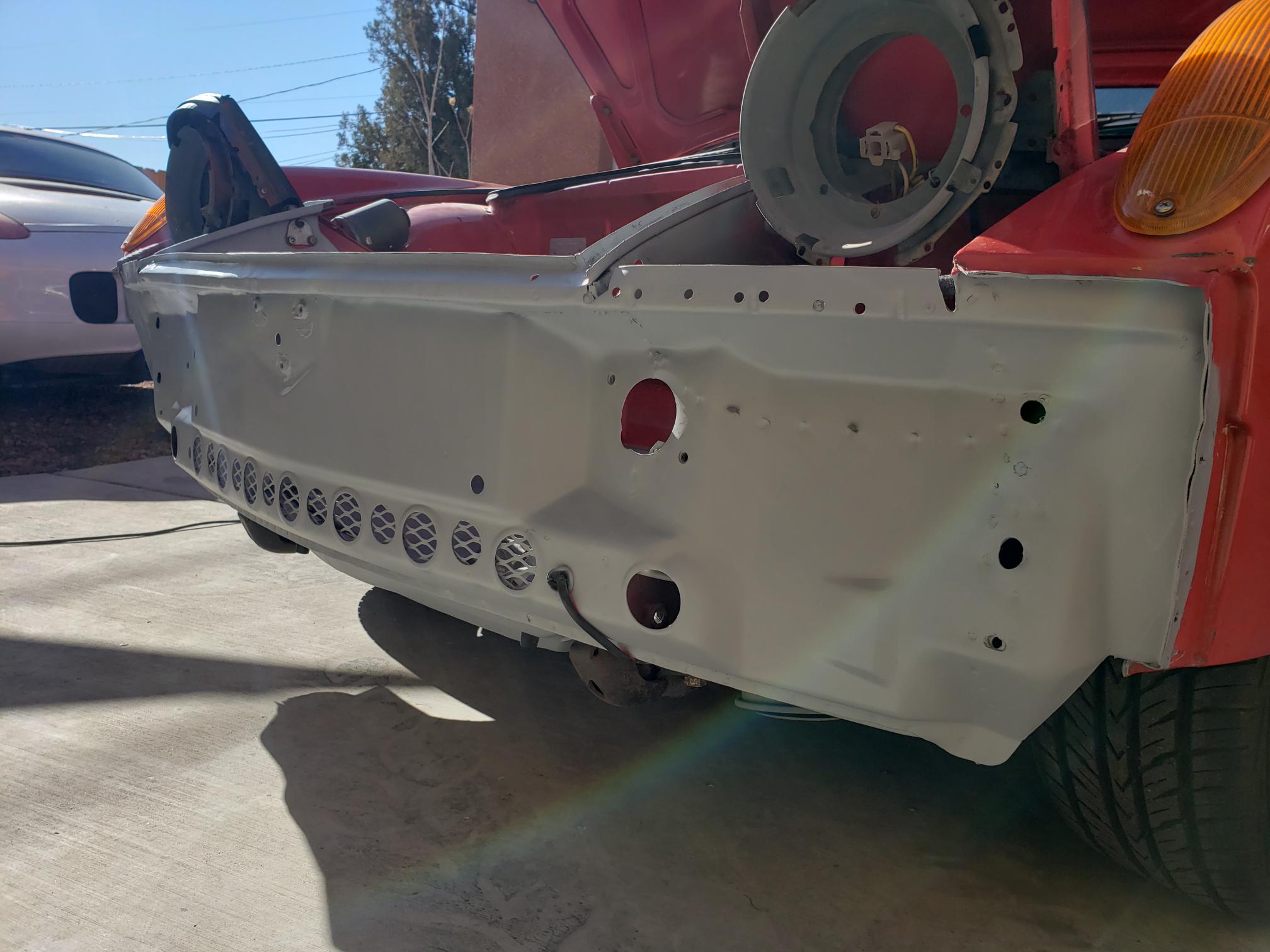

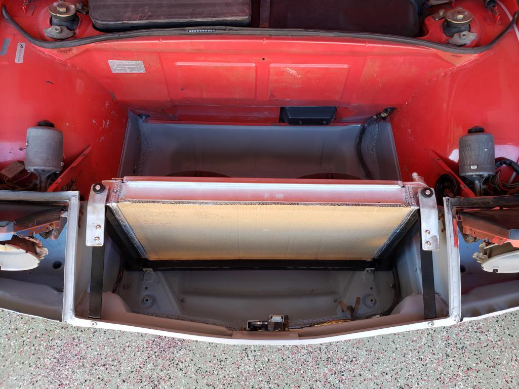

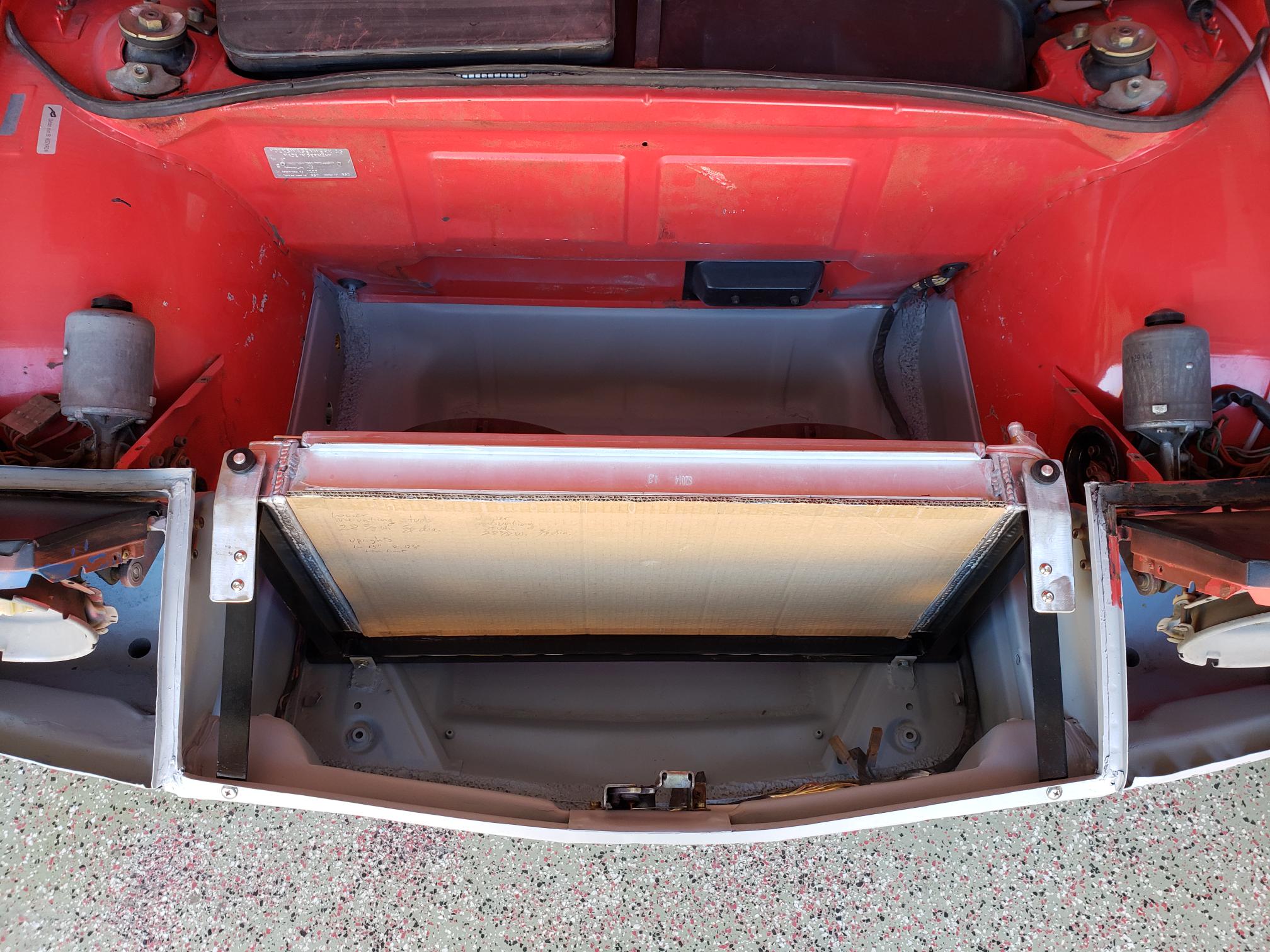

I stripped as much of the paint on the nose as I could, then taped it off and sprayed several coats of primer/surfacer. I got into the buckets below the headlights and treated some surface rust in there (as well as removing a substantial rodent nest!).

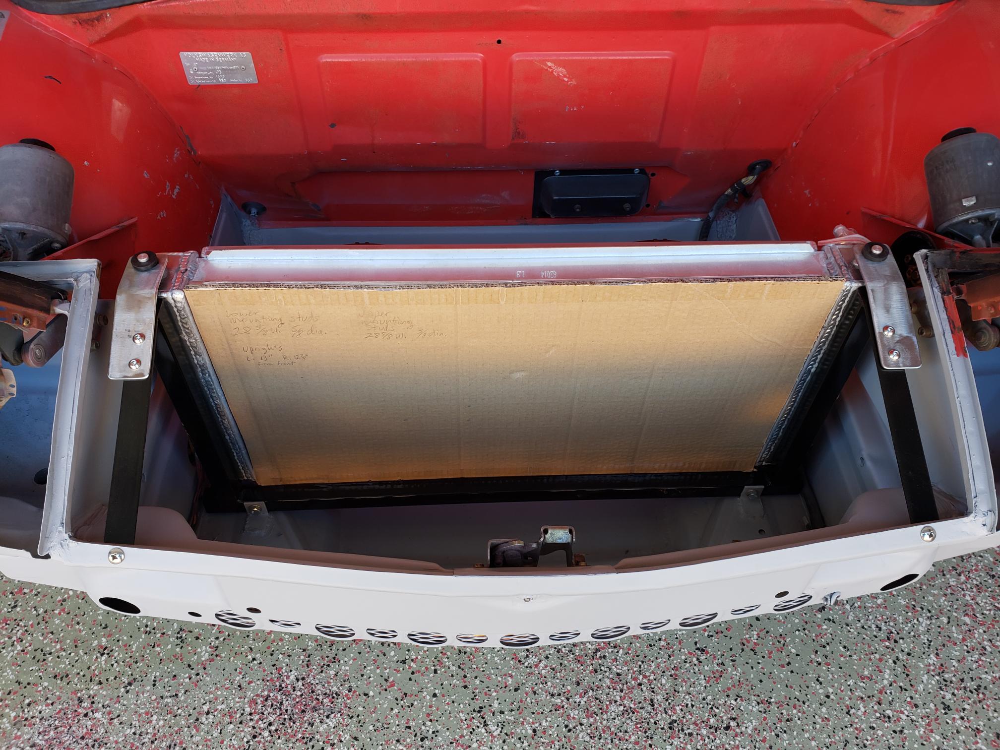

Now that the body work was decent, I finally got to install the radiator with my painted frame. The upper mounting tabs are just in bare metal, since I'm not sure how I want to finish them. Once the shrouds are in place, they will be about the only visible brackets. I'm considering drilling some "lightening" holes for aesthetics, burnishing the metal more, then clearing, but we'll see. But now that the radiator is in and I'm content with the mounting, I can start mocking up the lower and upper shrouds, maybe out of 1/16" aluminum.

Mayne   In other news, I finally got a new radiator...for ...   Oct 29 2021, 11:18 AM

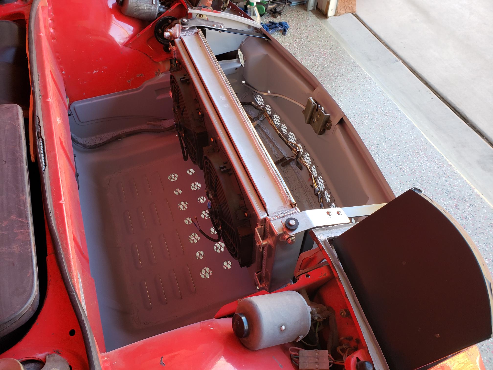

Mayne   Work continues on the frunk-mounted cooling system...   Jan 6 2022, 03:13 PM

Mayne   Made a little more progress on the radiator frame ...   Jan 10 2022, 09:11 PM

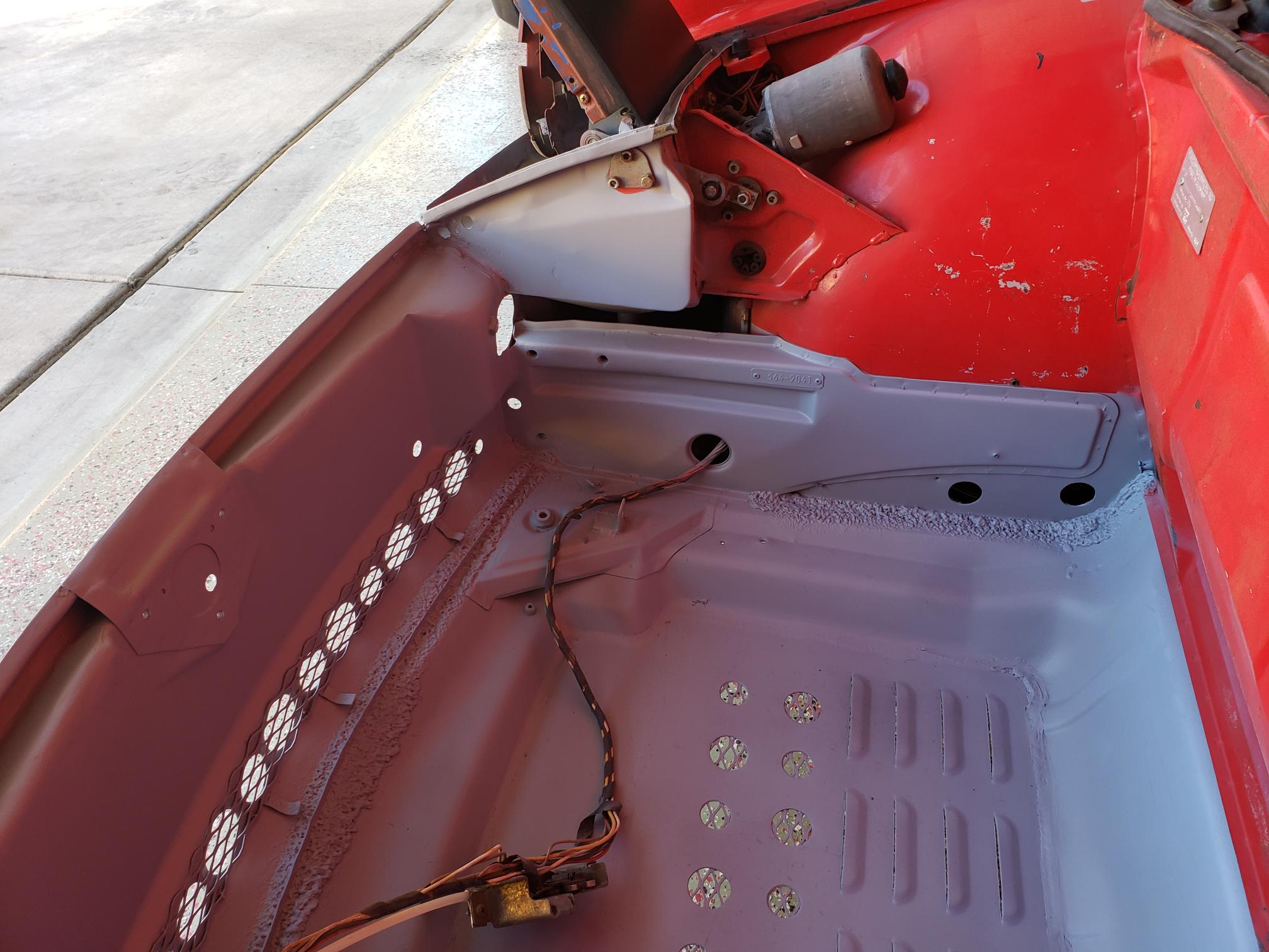

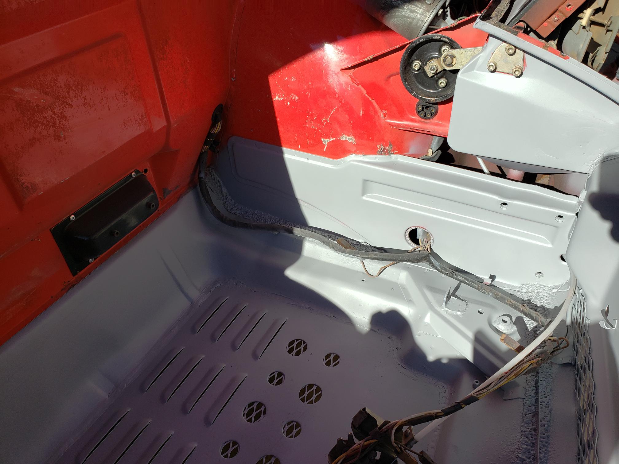

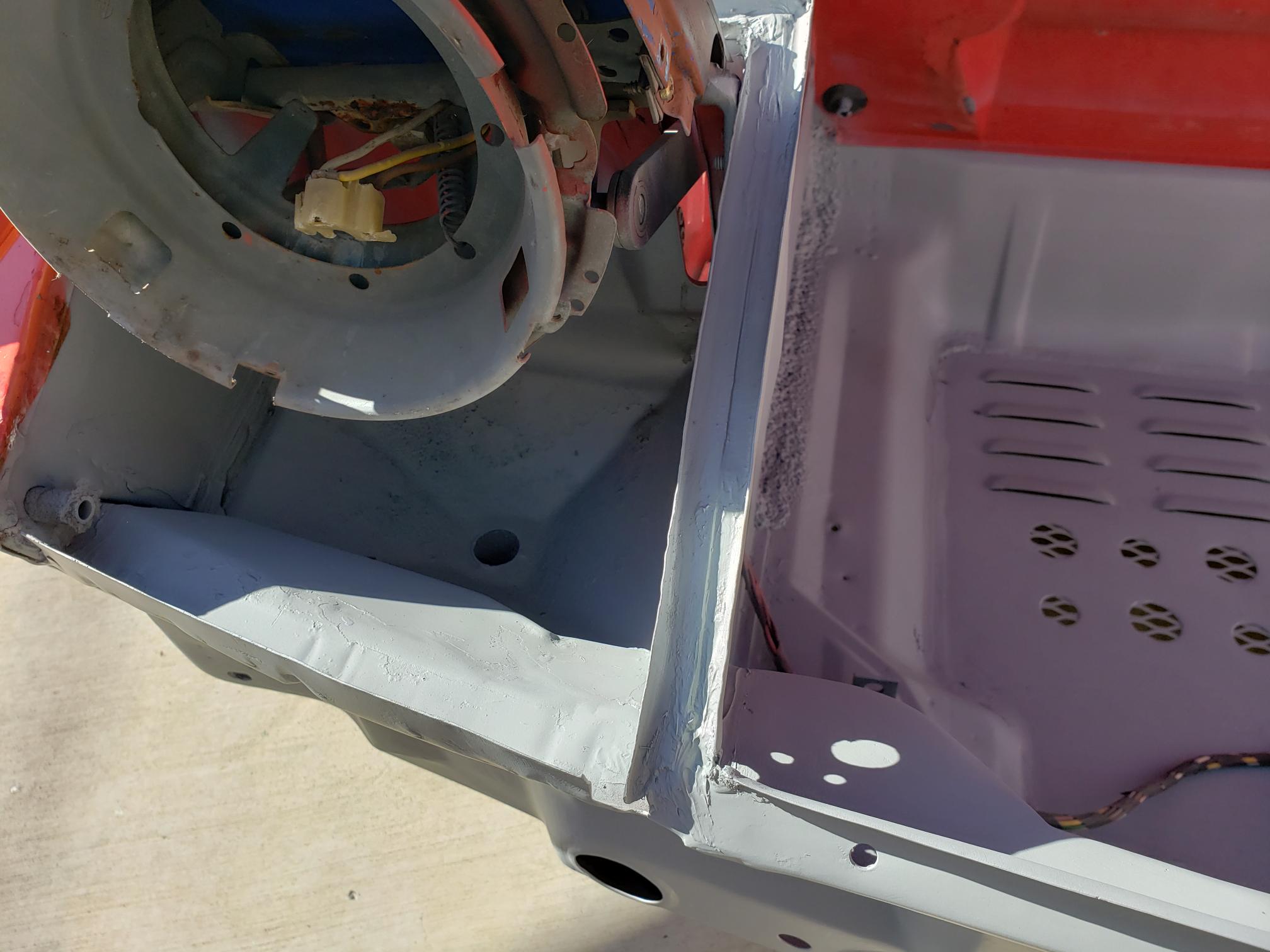

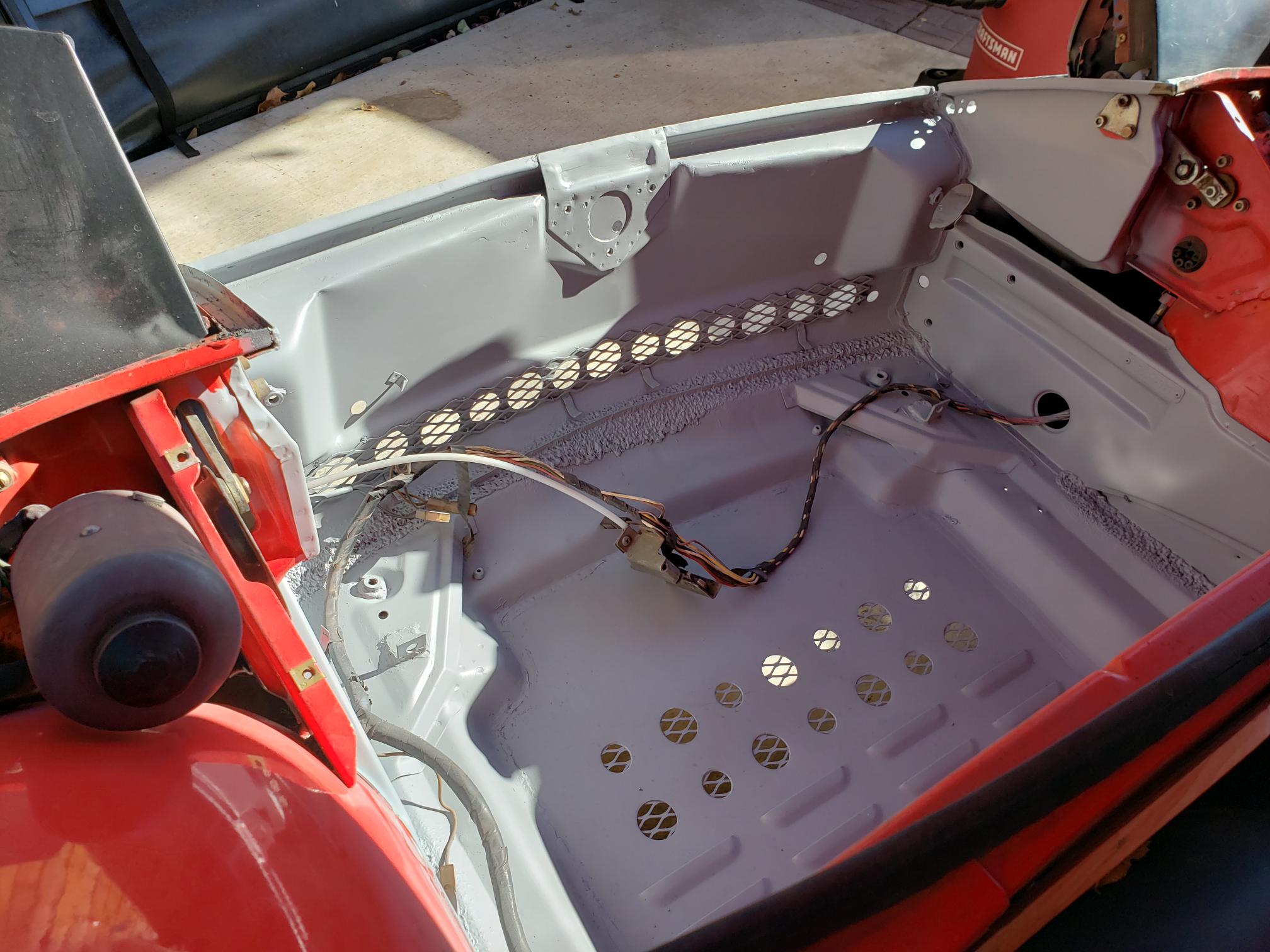

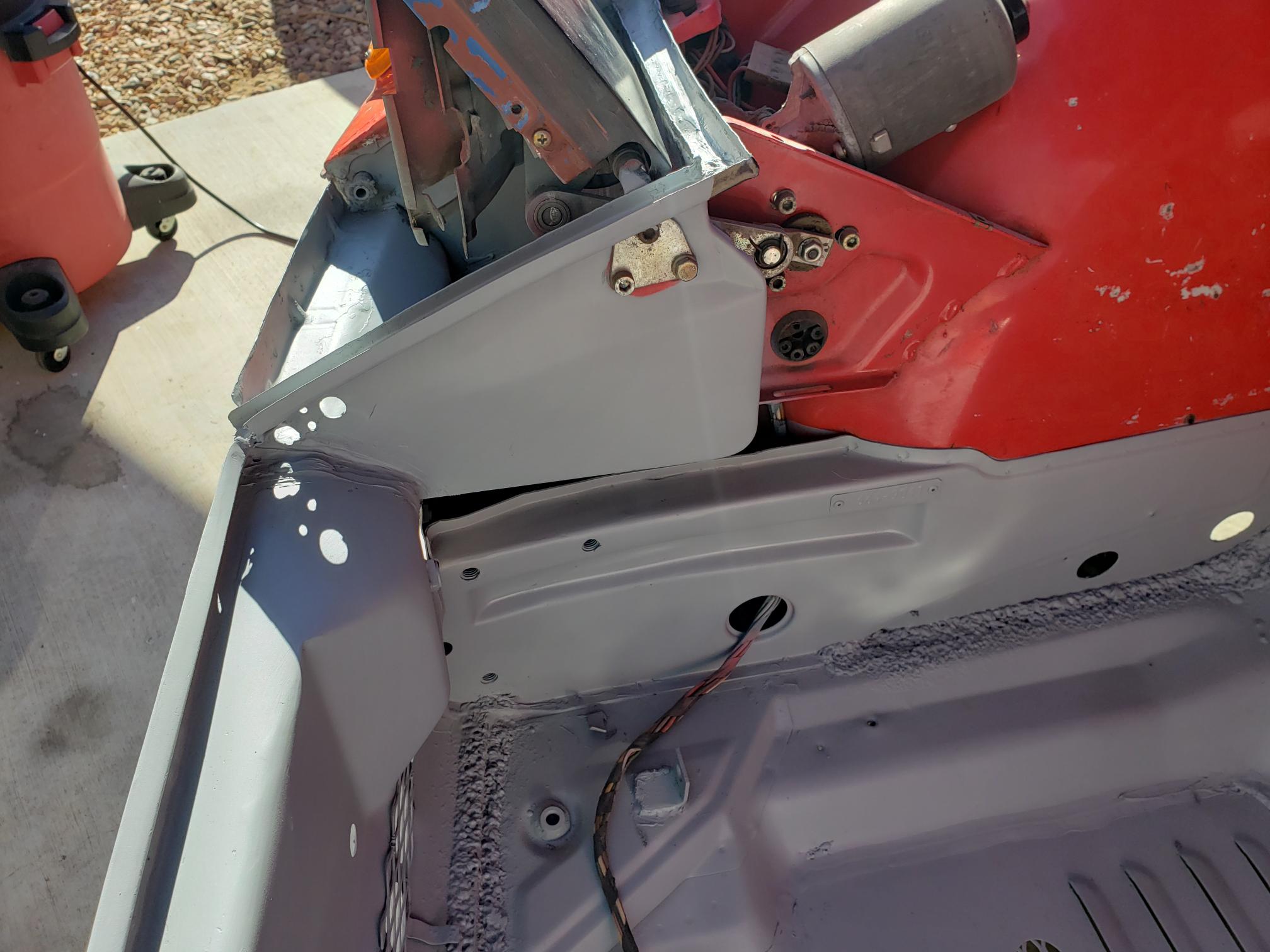

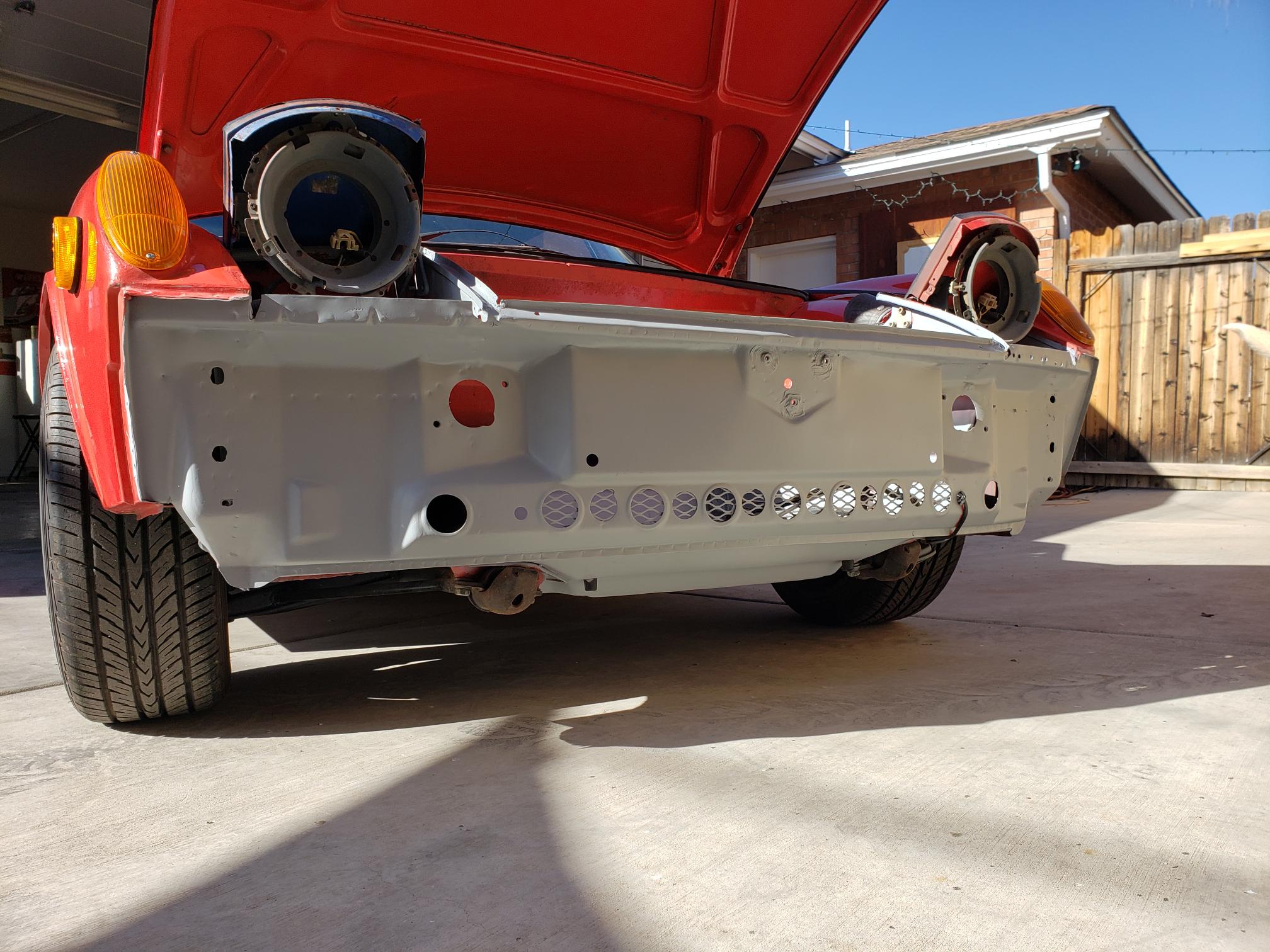

Mayne   In working on the front of the car so much, I deci...   Jan 25 2022, 03:16 PM
Mayne   I stripped as much of the paint on the nose as I c...   Jan 25 2022, 03:30 PM

Mayne   Time for a little update here. Up next was making ...   May 27 2022, 08:41 AM

Mayne   At that point, I got a little delivery >:D : ...   May 27 2022, 08:54 AM
Mayne   Next up was getting on to the exit side of the rad...   May 27 2022, 09:05 AM
