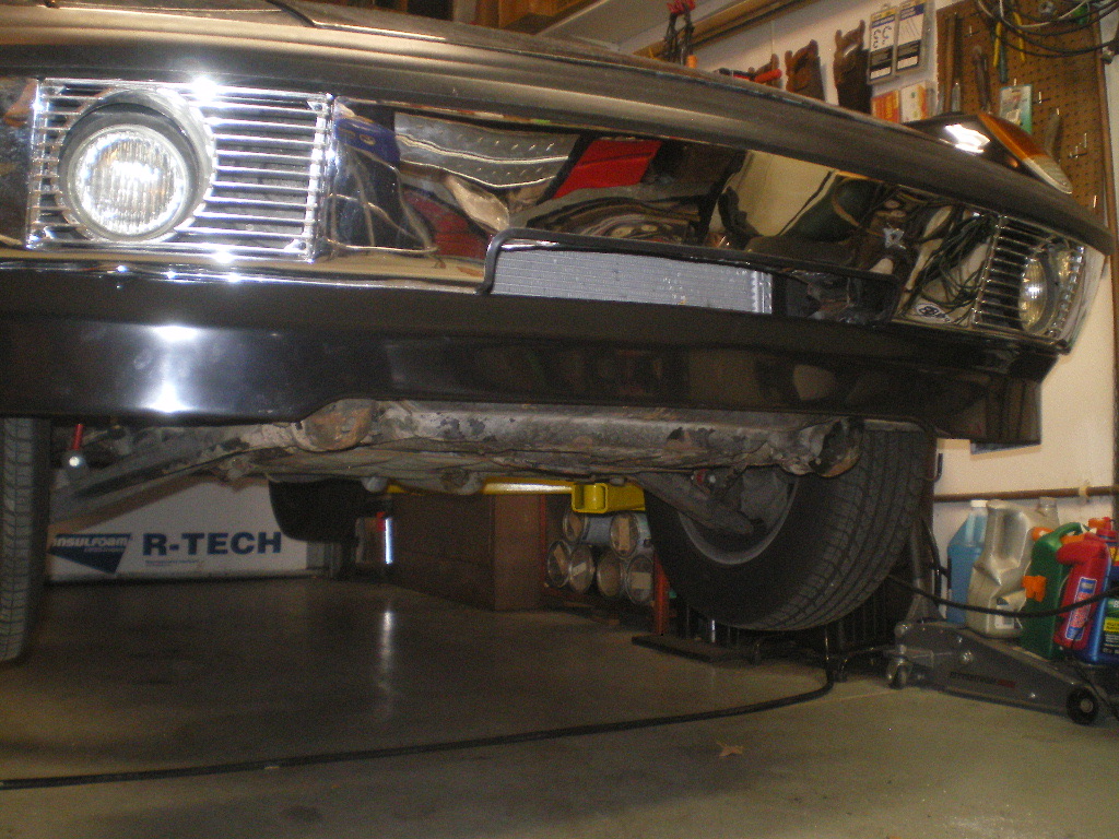

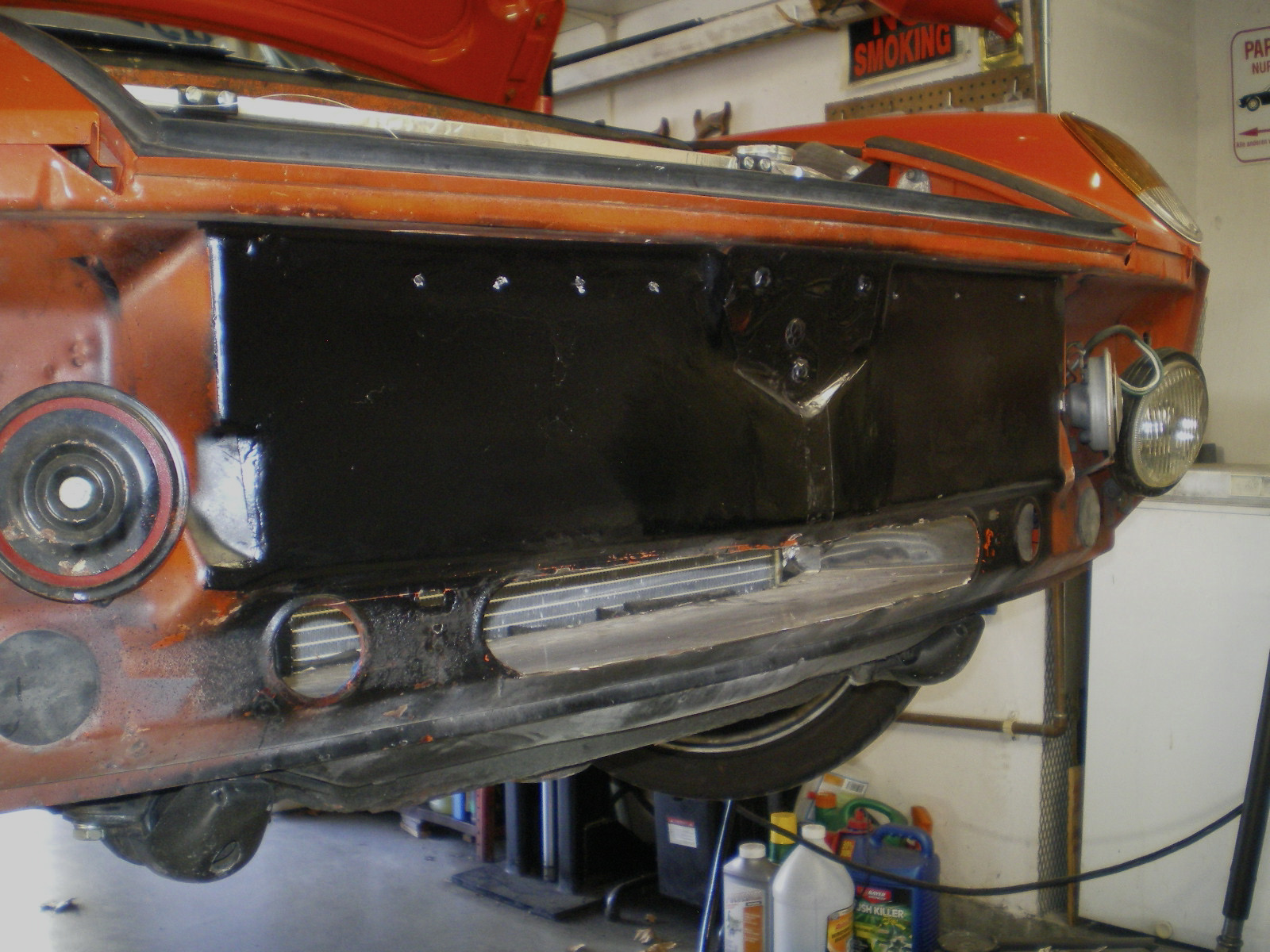

He should be OK. Here are both of my Subaru conversions and their openings for reference. On the 70 with the green & yellow bumper I cut out 5 of the centermost holes creating an oval opening and it cools fine. Jeremy is using 7 holes and has opened up smaller holes in-between each of those. Worst case is he'd need to open it up by removing the material between the holes. The EZ30's don't require much of an opening. Even with AC. HighJack over.

I like how you did that, i wish i cut my hole open like that in a past life instead of cutting the bumper out so much. What does the backside of that look like? i went through the fender wells but i do really like the floor exit for non race car kinda swaps.
I was just more worried about exit, but he is right that he can cut more holes. Especially with ducting it’ll be better. If theres good water proof ducting and you have the grating, why not just cut it out so you don’t need to figure out if it works good enough on a hot day. Keep up the work though!

tazz9924   I would be worried about cooling with your setup. ...   Jan 26 2022, 07:43 PM
Mayne   I would be worried about cooling with your setup....   Jan 26 2022, 09:12 PM
76-914   He should be OK. Here are both of my Subaru conver...   Jan 26 2022, 10:53 PM
tazz9924   He should be OK. Here are both of my Subaru conve...   Jan 28 2022, 03:42 AM
