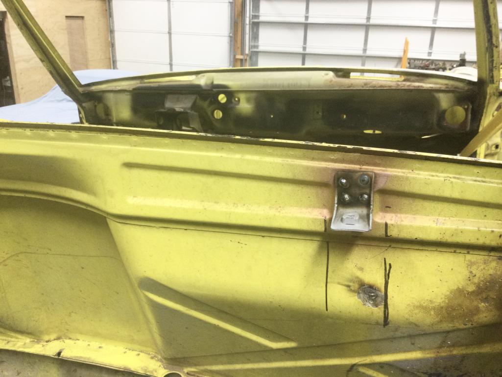

Well, making tiny amounts of progress,,,,,,,but at least I’m working on it.
I replaced the passside engine cover support as the original was broken.
Also managed to weld the front sway bar mounts into place.
Started to eliminate the front side markers as I have never liked them.
I tried doing it using the “Fitzee fabrication “ method and had so/so results.
Had a heck of a time with having little pinholes in the welds which let light through.
When I tried filling them with little tack welds, I’d sometimes pop a hole in the sheet metal about 3/16 in diameter.
Tried lowering my welder settings but that didn’t help much as I lost penetration.
Overall, it was kind of a pain in the butt, and I’m still not satisfied with it.
I think I’m going to do some practicing on some scrap pieces to get a bett feel of butt welding thin sheet metal,,,,,,before continuing on the car itself.

Alain V.   Well, making tiny amounts of progress,,,,,,,but at...   Jan 30 2022, 06:38 PM
Alain V.   Still needs a little finesse work on the side mark...   Jan 30 2022, 06:40 PM
