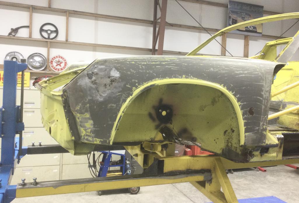

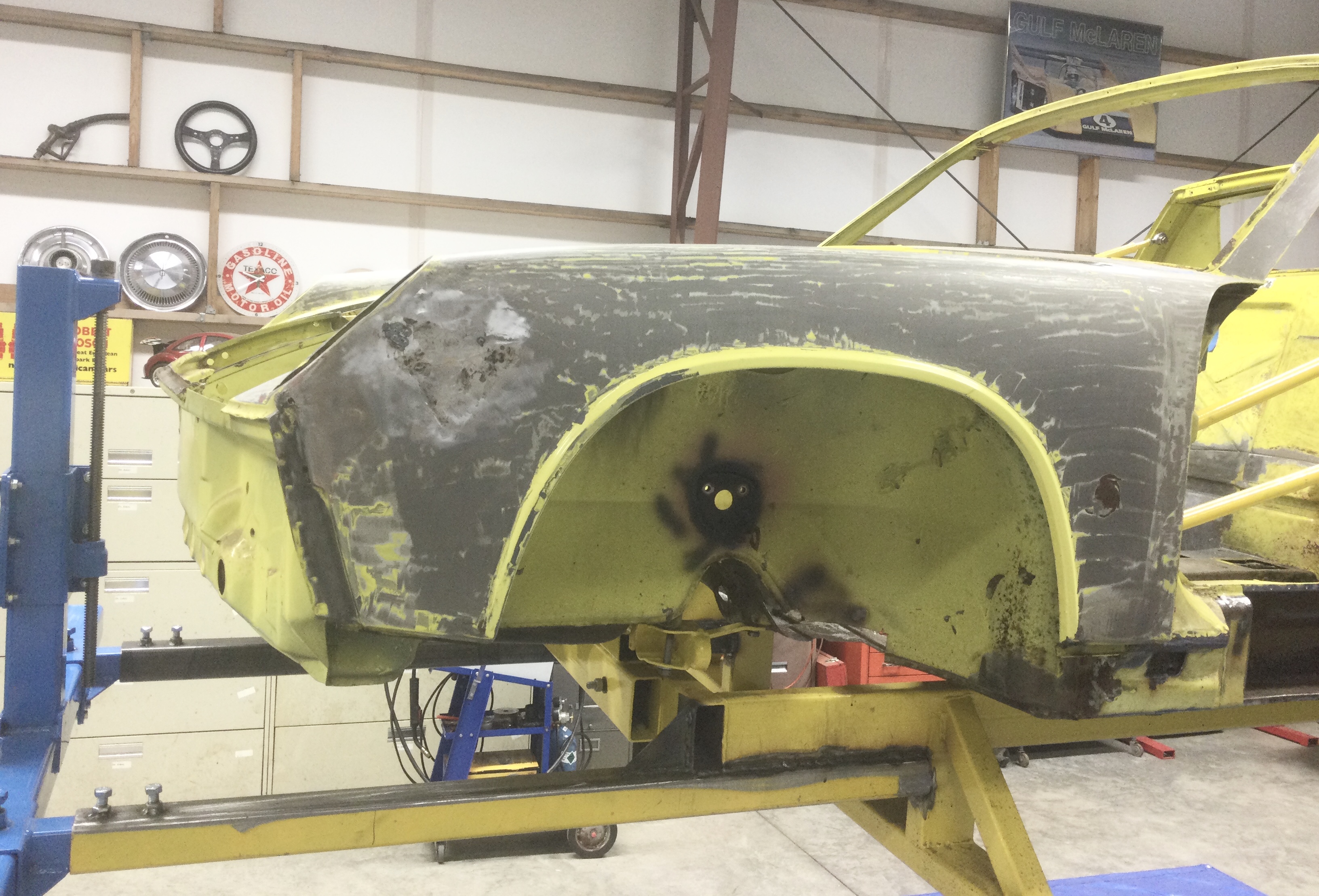

Alain V.   Well, making tiny amounts of progress,,,,,,,but at...   Jan 30 2022, 06:38 PM
Alain V.   Still needs a little finesse work on the side mark...   Jan 30 2022, 06:40 PM
