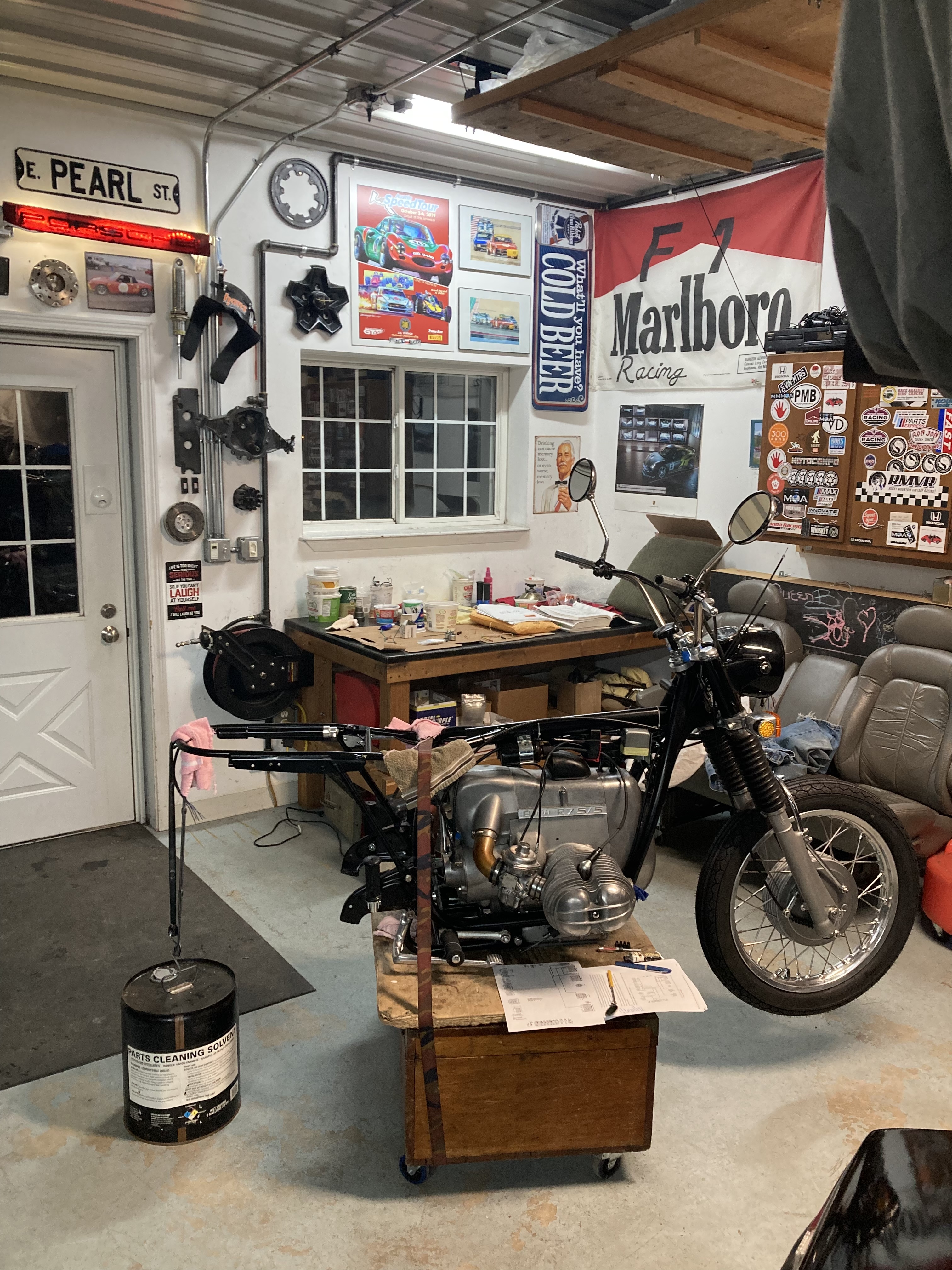

A wooden box with casters can come in handy for lots of projects
My motor box currently:
