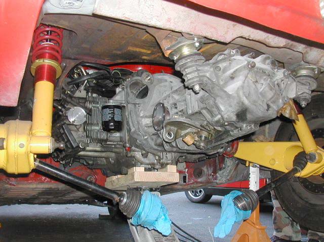

Feb 10 2022, 03:35 PM
QUOTE(Dobbsy @ Feb 10 2022, 01:02 PM)
is there a cradle like the one for the 4 cylinder
Not pretty, but functional ...

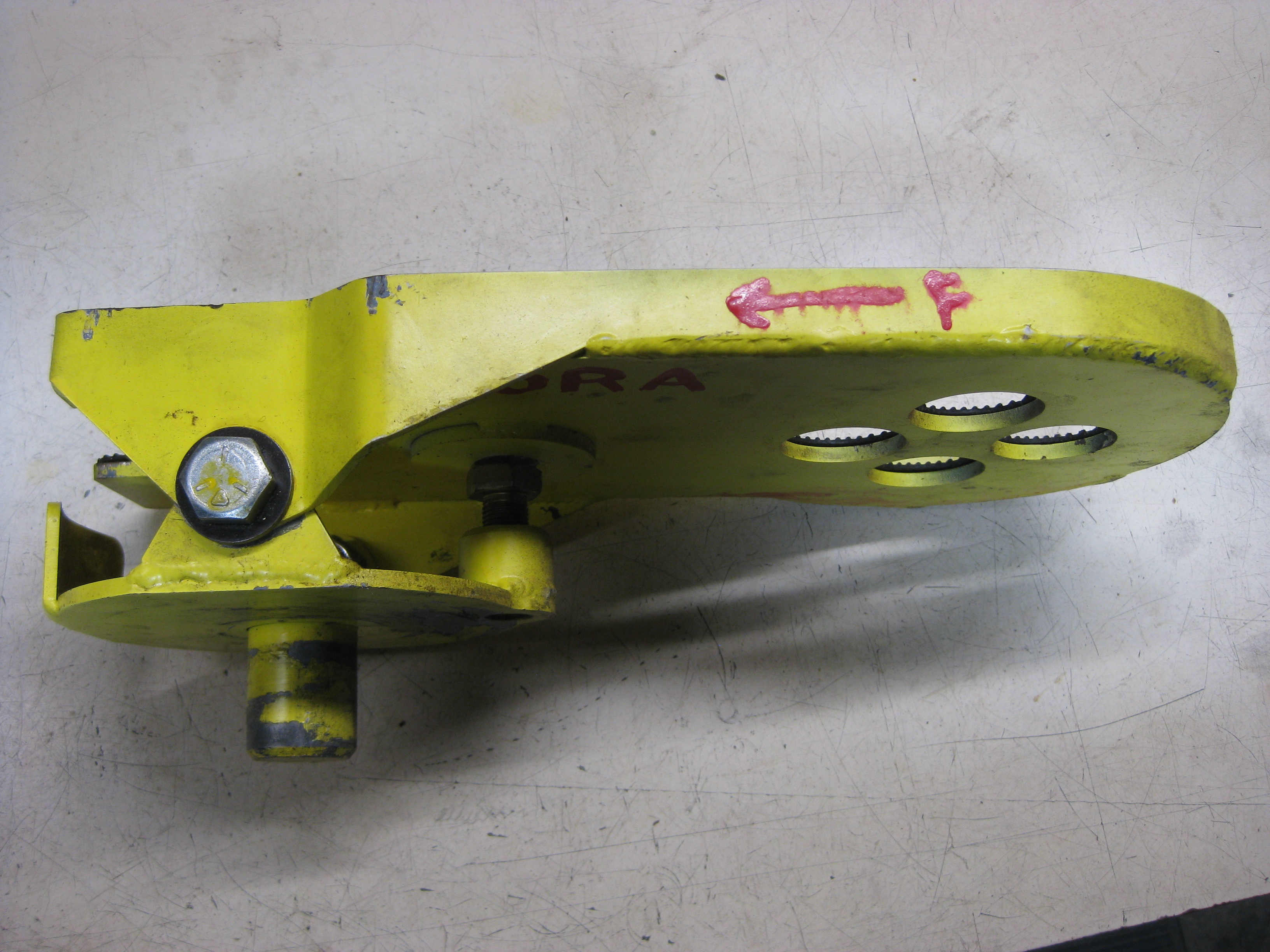

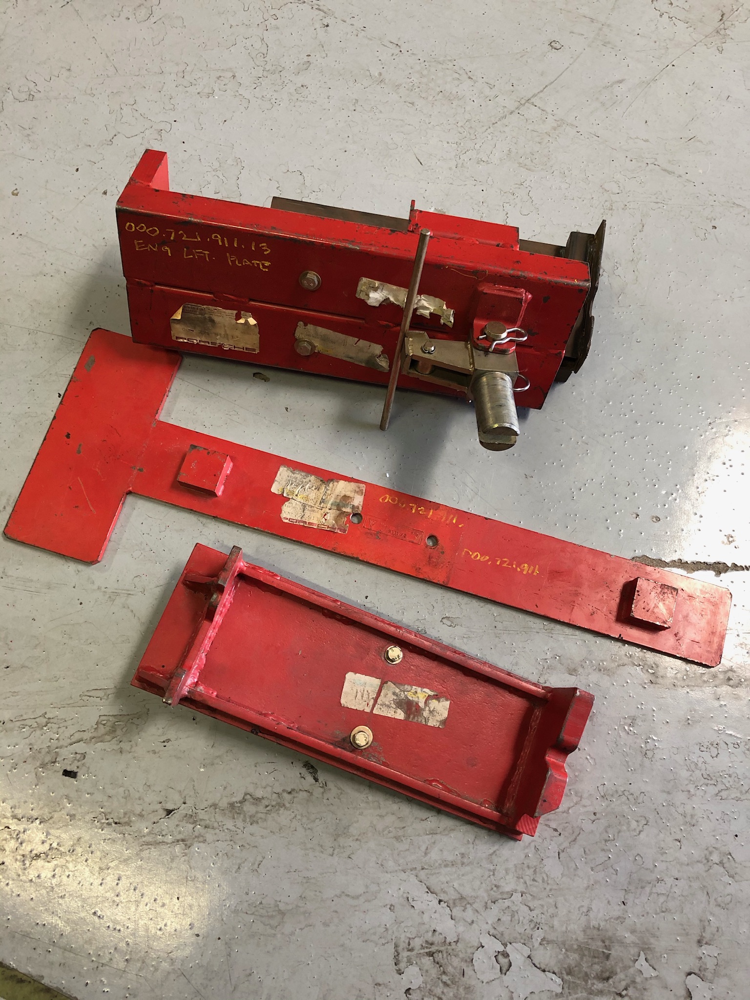

Factory tools, not cheap!

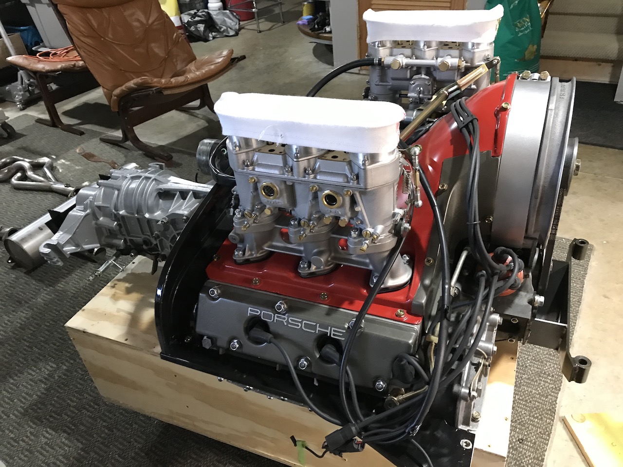

brant
Feb 11 2022, 08:37 AM
I prefer the lift
I have a wheeled platform for pulling the motor with jackstands
But prefer the lift
I reinforced this box. And added casters….
Lift the car
Lower the car onto the box
Pull 4 bolts and lift the chassis off the drivetrain
Roll drivetrain anywhere you decide

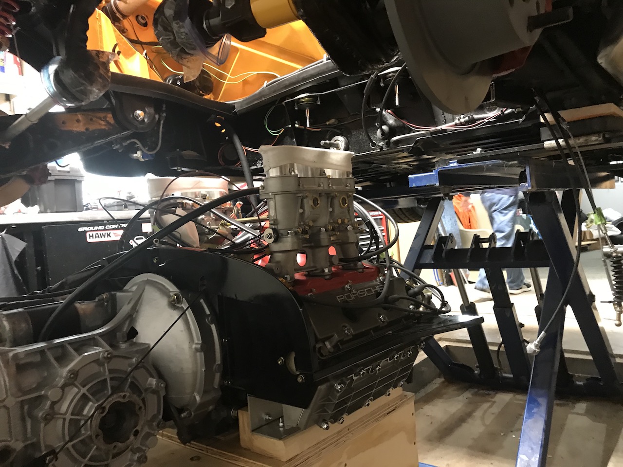

brant
Feb 13 2022, 10:55 AM
A wooden box with casters can come in handy for lots of projects
My motor box currently:
