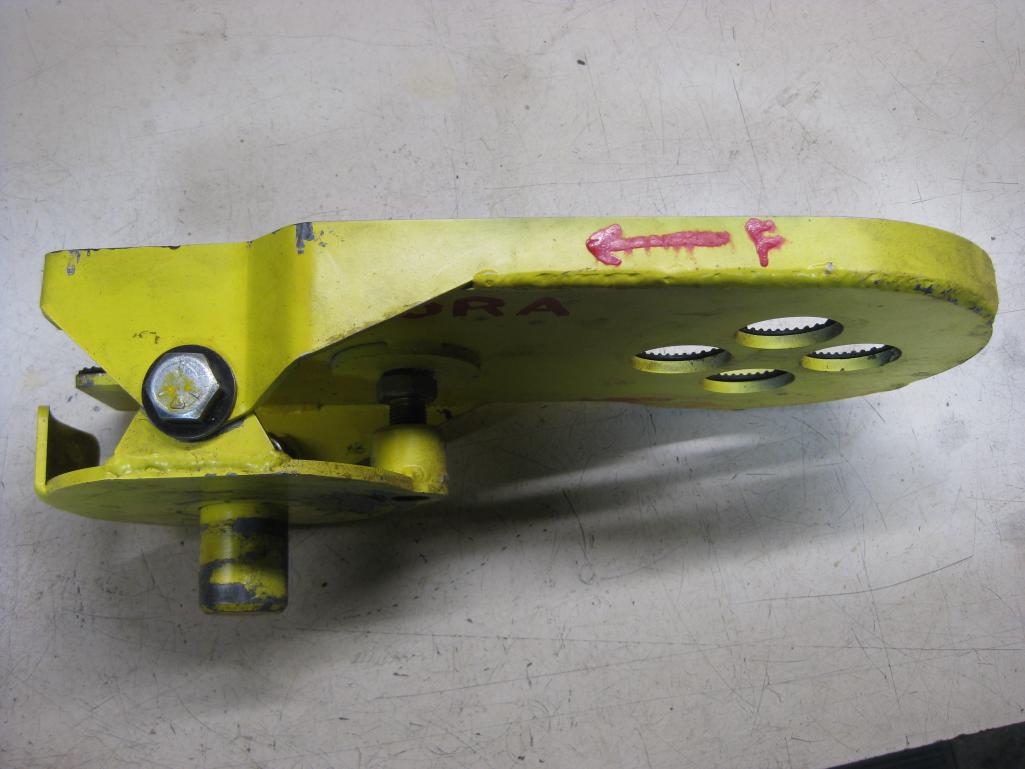

is there a cradle like the one for the 4 cylinder Not pretty, but functional ... (IMG:style_emoticons/default/biggrin.gif) (IMG:http://www.914world.com/bbs2/uploads/post-179-1165172581.jpg) (IMG:http://www.914world.com/bbs2/uploads/post-179-1165172660.jpg) |

Shame Tangerine Racing doesn't offer a nice plate for /6. Maybe SirAndy willl offer a GB on the wood version. (IMG:style_emoticons/default/laugh.gif)

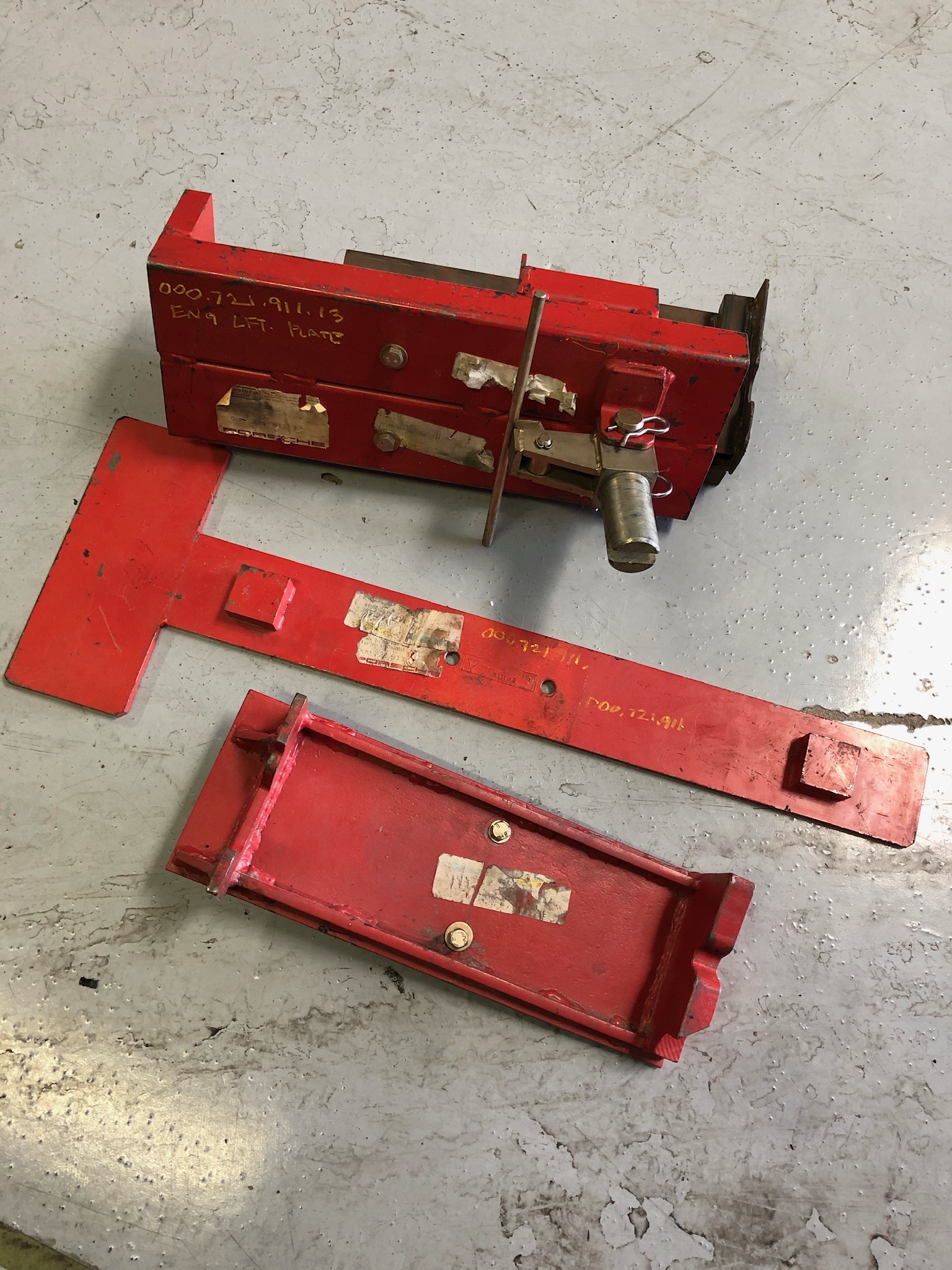

I also have a plate that I used originally for 911s..fits right under the engine and those holes are at the sump plate....works fine for 914 too....and then as mentioned the piece of plywood on a jack works fine especially if the HE's are on it as they make a nice flat bed... Mark I also have modified my lift table so the arm folds to the outside/back so it doesn't get in the way and can be used for pulling. |

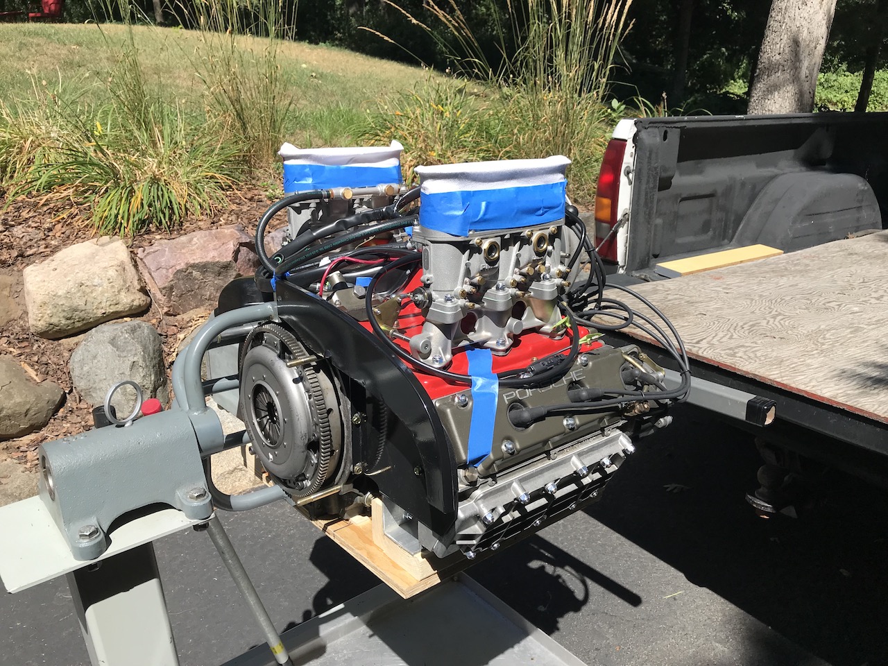

I use 2-8's across a motorcycle lift. I've done this several times. Of late, once the motor is resting on the lift, I can jack up the car to get the clearance I need (not having a two post lift as some others). (IMG:style_emoticons/default/smile.gif) Attached thumbnail(s) |

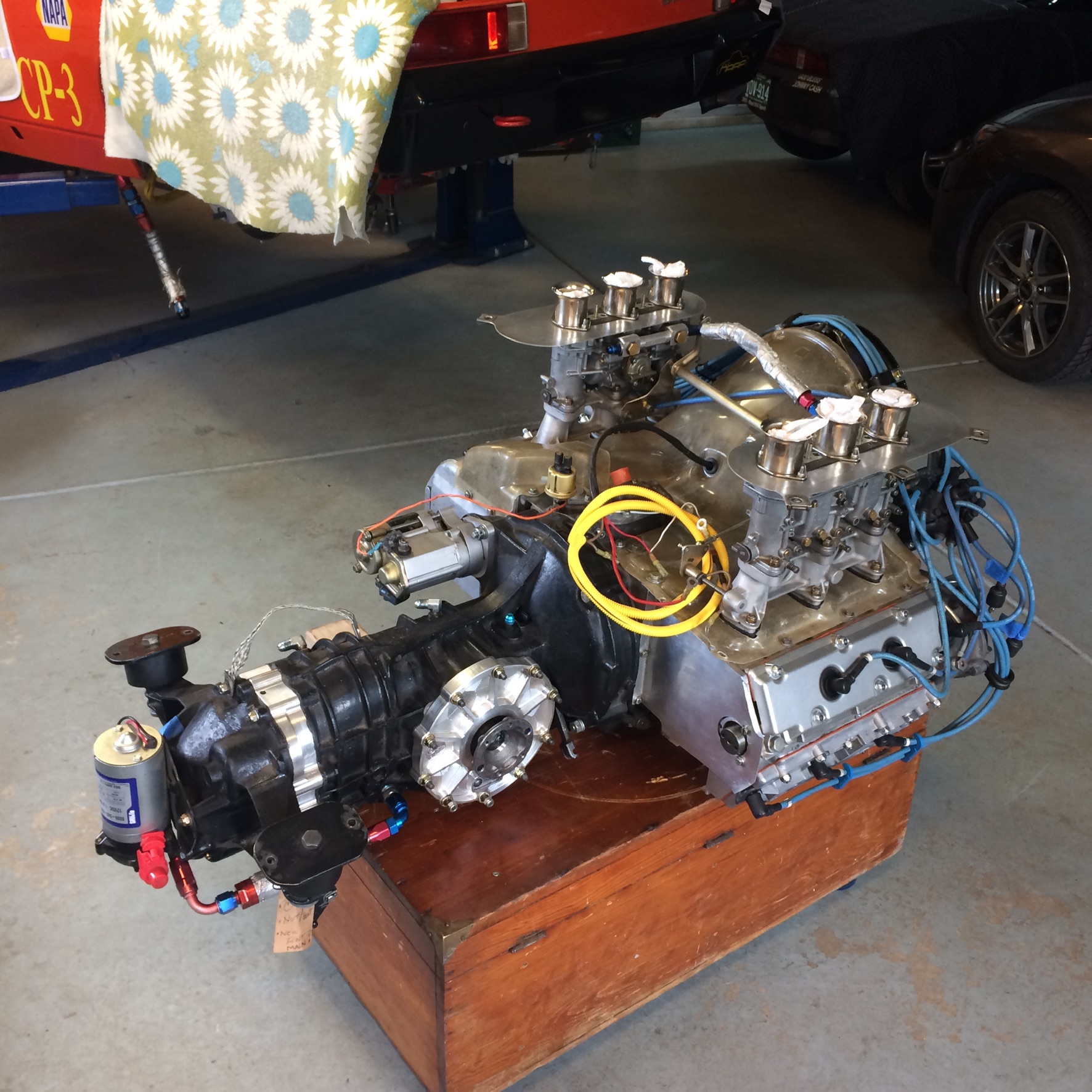

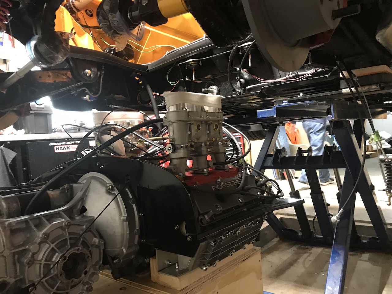

I have a wheeled platform for pulling the motor with jackstands But prefer the lift I reinforced this box. And added casters…. Lift the car Lower the car onto the box Pull 4 bolts and lift the chassis off the drivetrain Roll drivetrain anywhere you decide Attached thumbnail(s) |

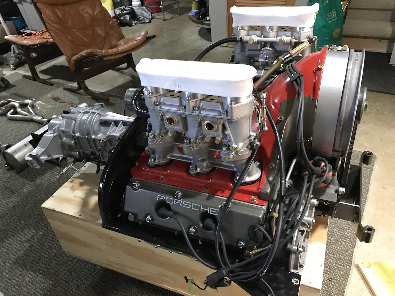

Dobbsy, I built a engine cradle to support engine while sending to a shop( bolts to exhaust studs and sit on case) but also worked great for the engine install. I have a scissor lift so I built a sturdy box with caster to support engine and trans, just rolled up under car and lowered lift and bolt up. Best, Mark

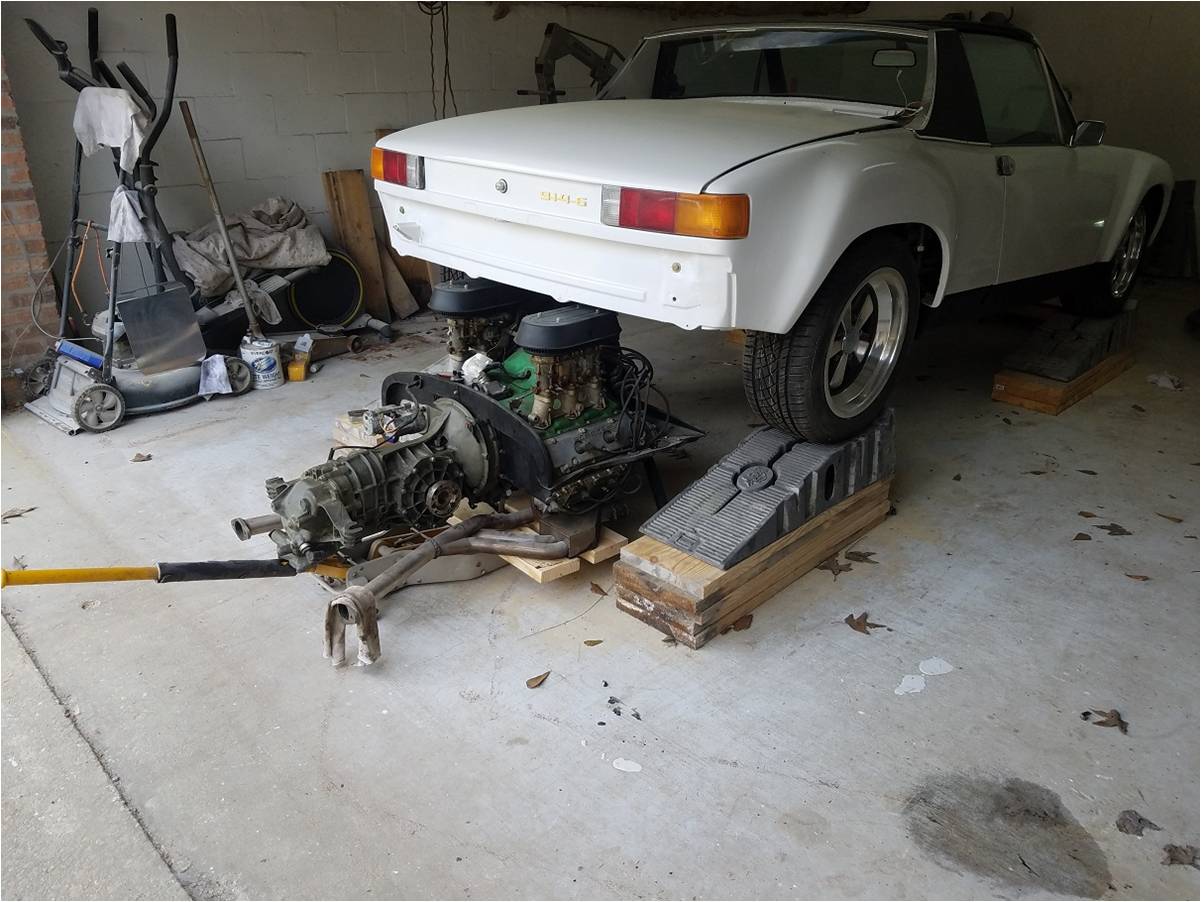

What a bunch of sissies ! Way too fussy. Just back up over a couple old tires. East peasy! (IMG:style_emoticons/default/smile.gif) |
