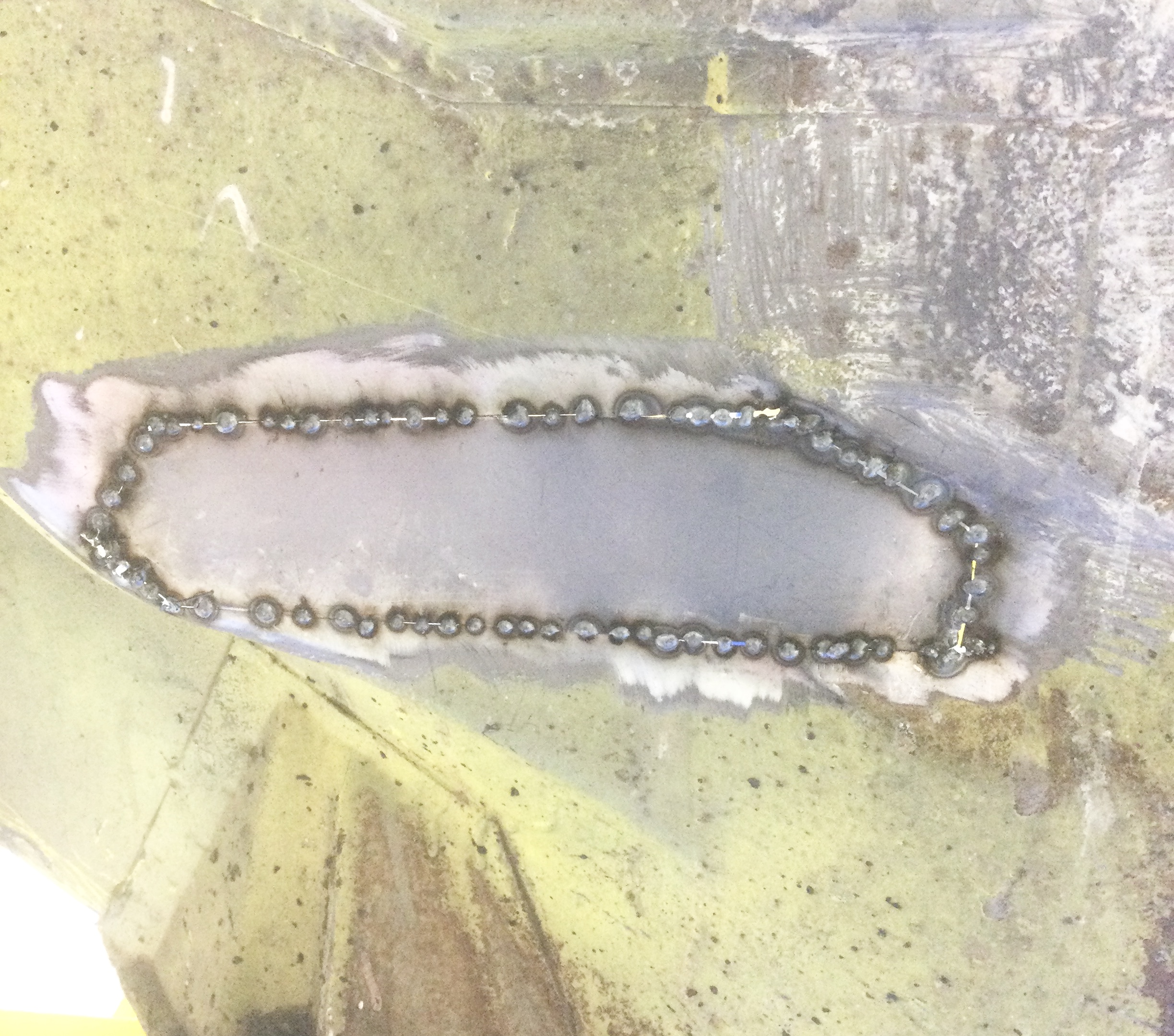

Alain V.   Well, making tiny amounts of progress,,,,,,,but at...   Jan 30 2022, 06:38 PM
Alain V.   Still needs a little finesse work on the side mark...   Jan 30 2022, 06:40 PM
Superhawk996   Glad to see this one is still moving along. :D ...   Jan 30 2022, 07:06 PM
Alain V.   Thanks for the tip about using copper. Not too mu...   Feb 13 2022, 05:12 PM
Alain V.   Welding it in.   Feb 13 2022, 05:13 PM
