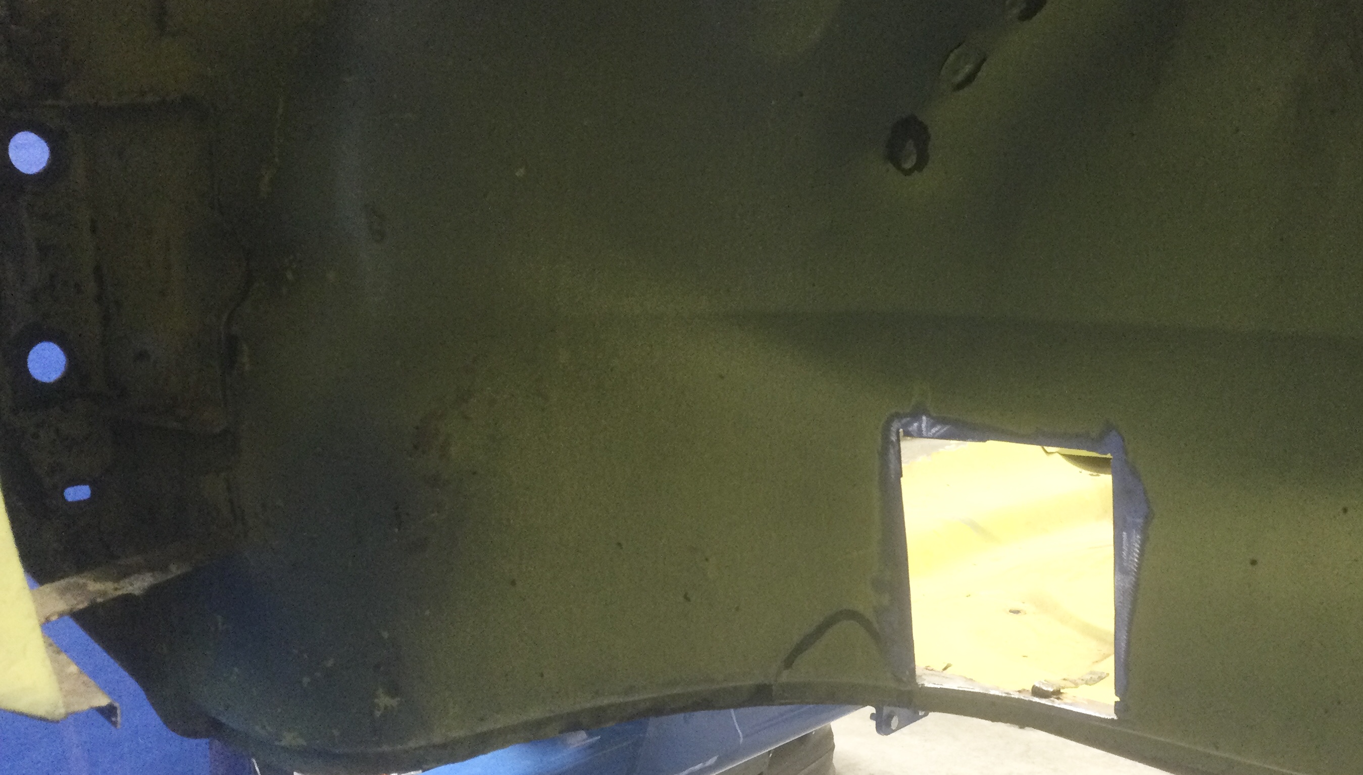

Also found a bad spot in the left front fender well.
I’m going to try and finish up these small areas in the next few weeks.
Once these small patches are done, I’m planning to have the entire tub blasted & epoxy coated.........then it’s on to the bigger stuff.

Alain V.   Also found a bad spot in the left front fender wel...   Feb 13 2022, 05:17 PM
