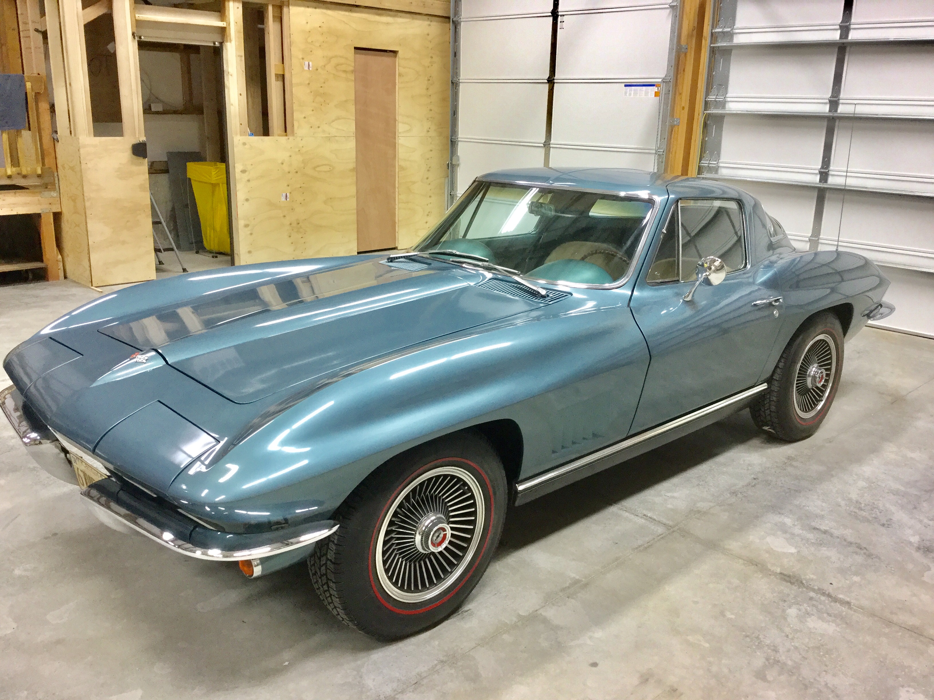

It’s a 67. Survivor car. Never been restored, or modified.
I’m the second owner. It’s “Lyndail blue” ,looks much prettier out in the sunlight.Attached Image

QUOTE(Alain V. @ Feb 14 2022, 11:25 AM) *
Wow. That is a real treasure.
