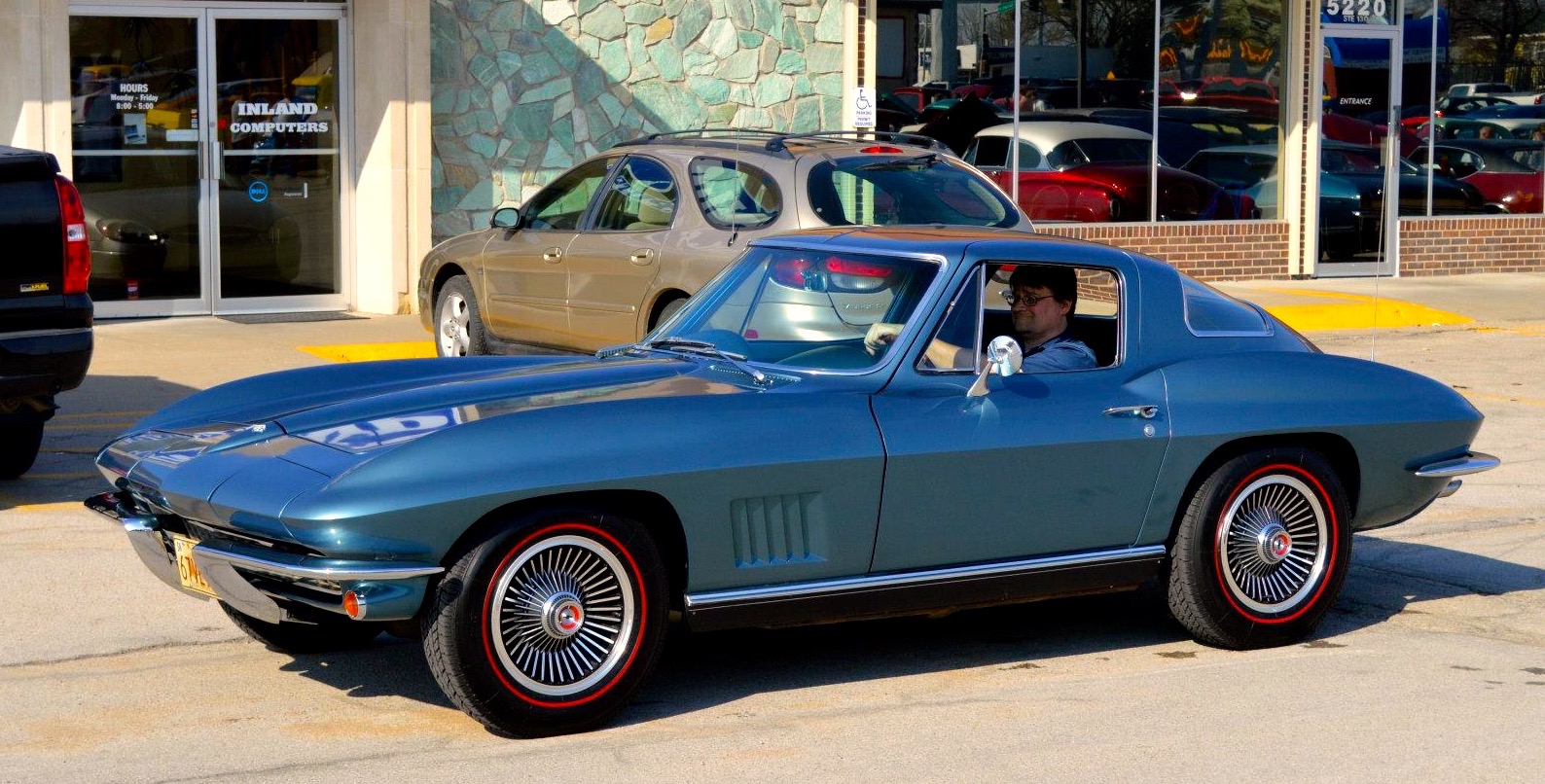

Thanks guys. Here it is all cleaned up and in the sunlight.
My little collection is about 1/2 domestic cars and 1/2 German ones.
In my opinion, from around 1950 to 1970 was the peak of American car styling and desirability.

76-914   I agree with your view on the Turbo 4. The sound o...   Feb 13 2022, 11:42 PM
Alain V.   It’s a 67. Survivor car. Never been restored, o...   Feb 14 2022, 11:25 AM
