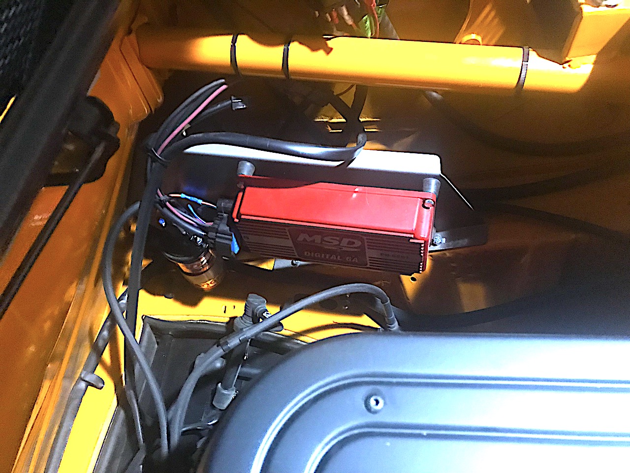

Has anyone here installed a twin plug into their car? I am having a 2.4 built and wanted to get some ideas on where to mount the msd's and coils. Any pictures of how you mounted and routed?

BillJ, mine is not a twin plug but just wanted to keep the engine as clean as possible. Fabricated a panel (note battery delete) into the battery area to hold the MSD and Coil.
Did have to get the longer coil wire. Worked great. Best, MarkAttached Image
