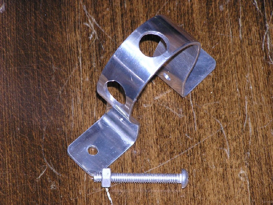

Here is a coil bracket we made from aluminum for weight... the tightening screw is also aluminum
we made 2 of these..
put the coils on the firewall
short coil wires to the dizzy
put the MSD units on the cockpit side of the fire wall...
passenger side, (behind the seat if we had one)
short run between the coils and MSD units.. (grommet in the firewall)
keeps the MSD out of as much water exposure...
also a race car with no windows.
