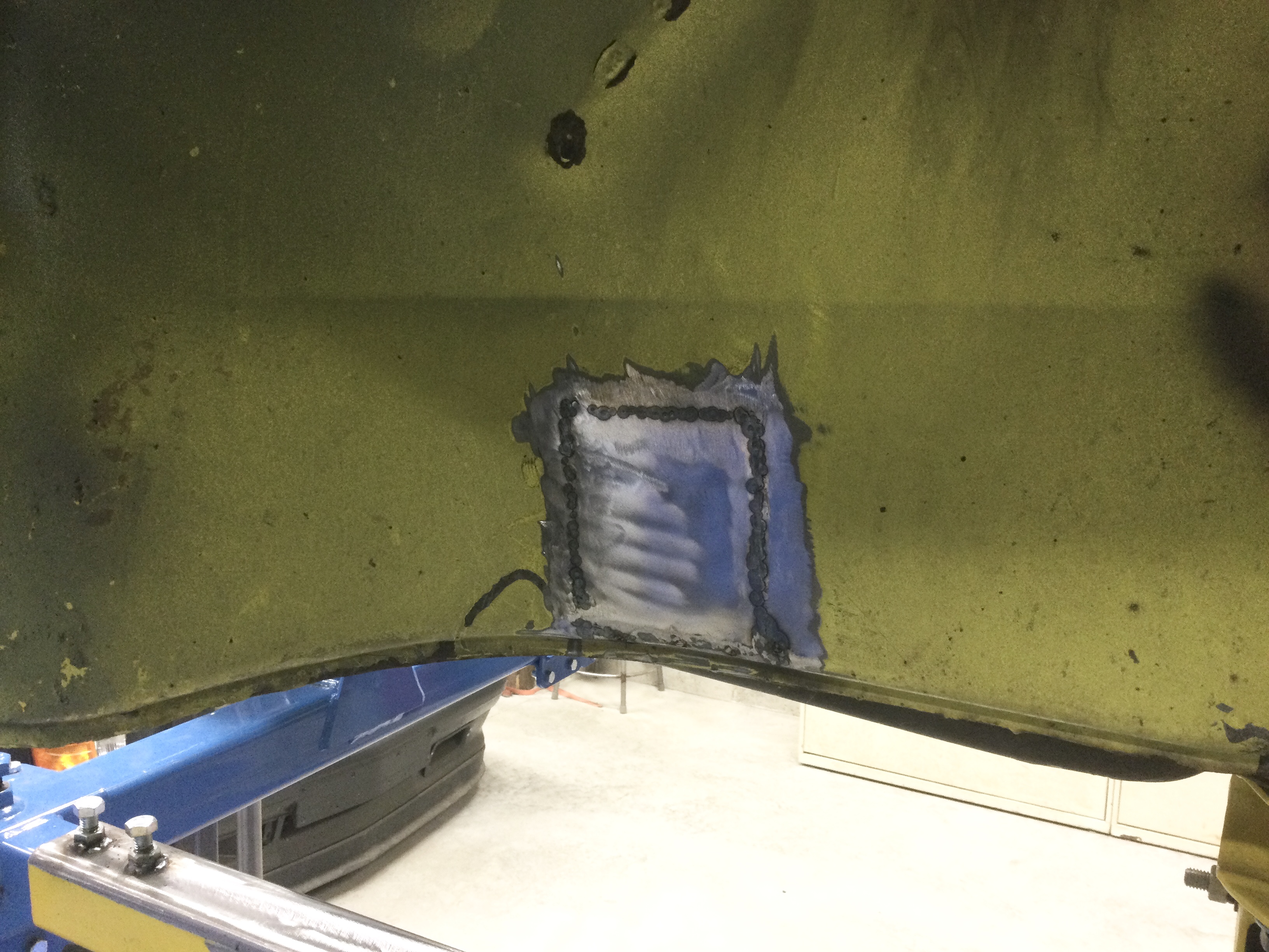

Well, back to the 914. Still making small steps forward.
I got the patch for the left front fender well done, filled the stock antenna hole in the fender, and patched the holes for the emblem in the tail panel.

Alain V.   Well, back to the 914. Still making small steps f...   Feb 20 2022, 05:20 PM
