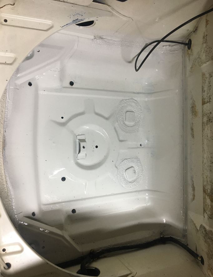

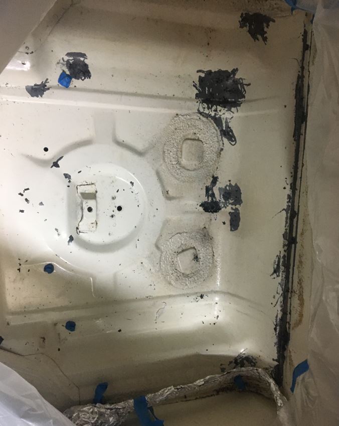

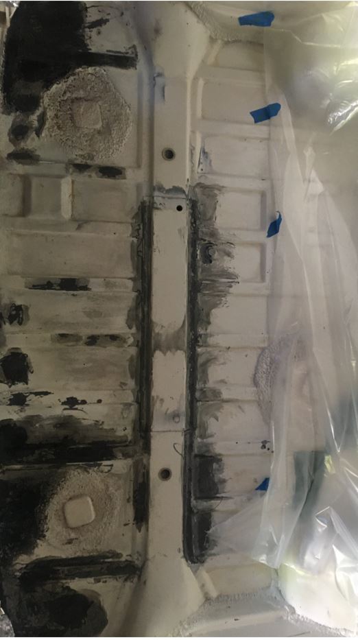

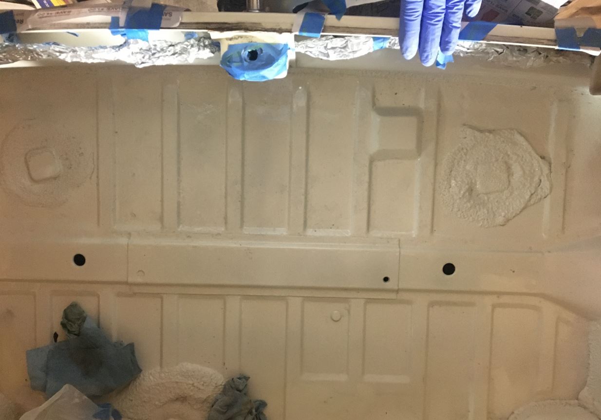

Have not posted in a while. I have made a some forward progress in cleaning up some areas and getting the interior cleaned as well. There was some mild surface rust in the front and rear. Rear was a little worse, I assume typical leaks (I am sure luggage rack doesn't help)
I decided not to leave the cleaned up areas in the front and rear trunk unpainted after wire brush.
I was able to get a paint sample scanned and matched. The paint matched really well in rear. Frunk paint was more yellowed (assume off gassing of spare over the years).
Cleaned up with wire wheel, Ospho and Por15
Painted:
Front wire wheel, Ospho
Painted
