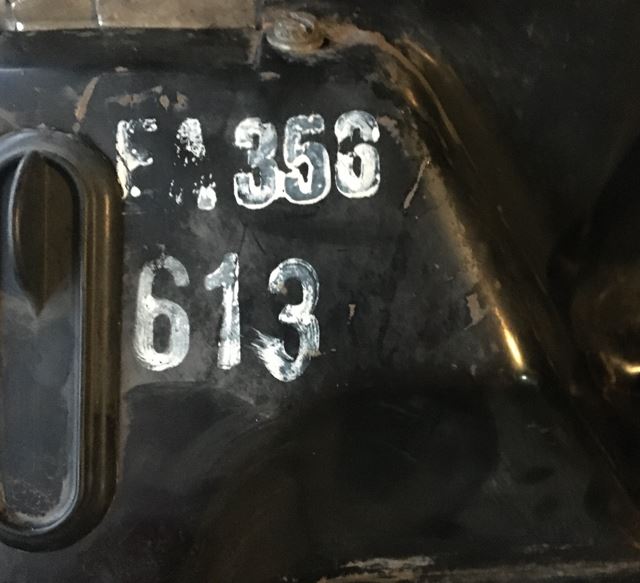

As you can tell from pics the engine and tranny were removed. Engine got decreased (very well marinated) and received all new gaskets , seals, engine mounts, etc.. Debated what to do with engine tin as there was some surface rust. I elected to just clean it as many of the factory markings were still in good condition.
Transmission was also de-greased and inspected. The transmission would not stay in 4th gear, this was the reason I was told the car was not driven much for 20+years. Inspected and then replaced most of the syncros (5th was good and reused), dog teeth and shift selectors. 1st was not good and 4th was very bad (part of the reason it would no stay in gear). Resealed and re-installed and adjusted shifter, as set up it would not go fully into 4th, probably reason 4th was damaged.. So far no leaks from engine or tranny and runs and shifts good.
I had one mess up in cleaning some of the heat exchanger ducting. The parts that were painted grey were in good shape but really layered in grease. I used to aggressive a cleaner and stripped the paint. Had to repaint grey.

doug_b_928   Mine is also an early 73. Interestingly, the rear...   Feb 21 2022, 04:03 PM

targa72e   Mine is also an early 73. Interestingly, the rea...   Feb 21 2022, 11:14 PM
