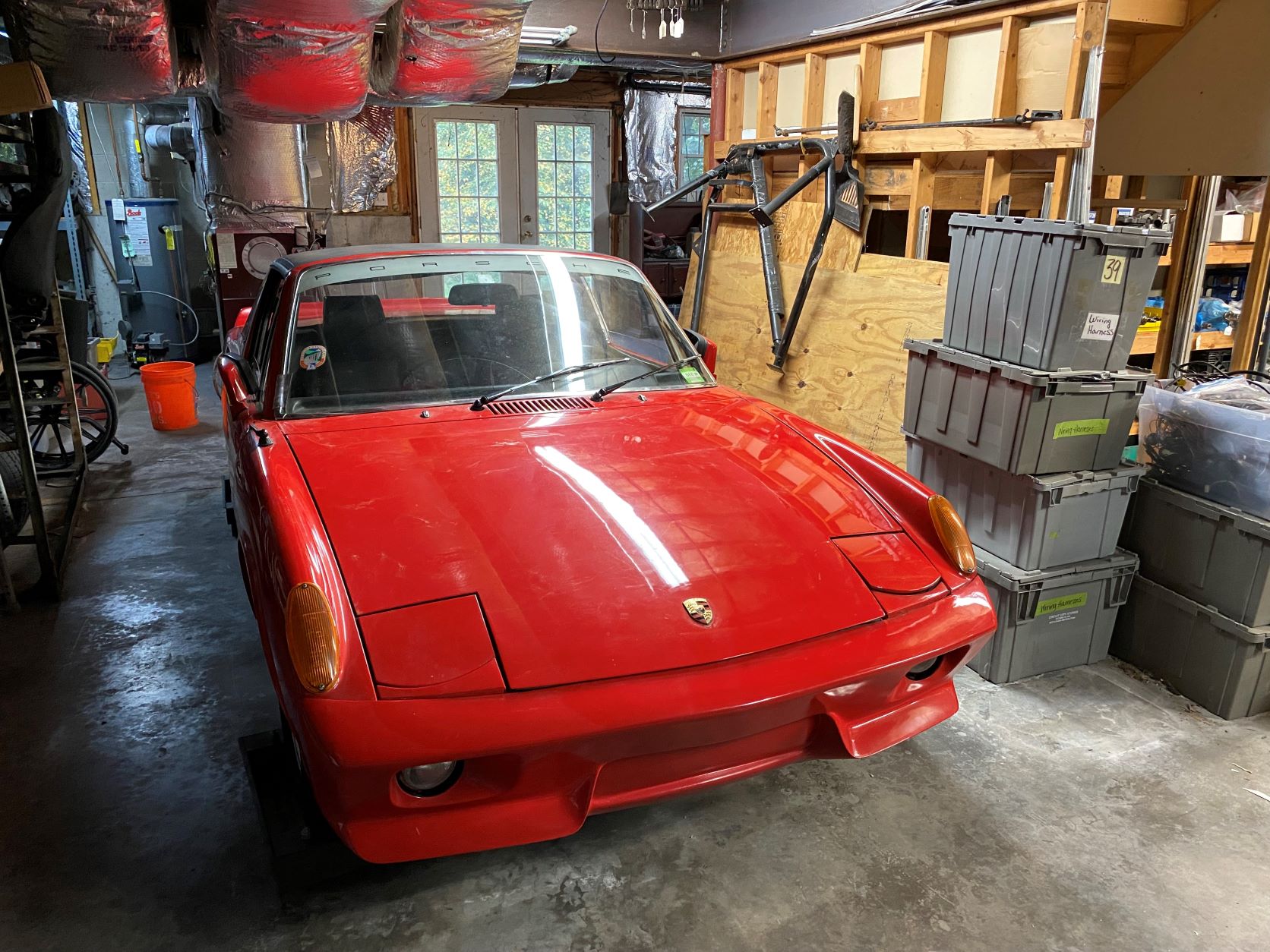

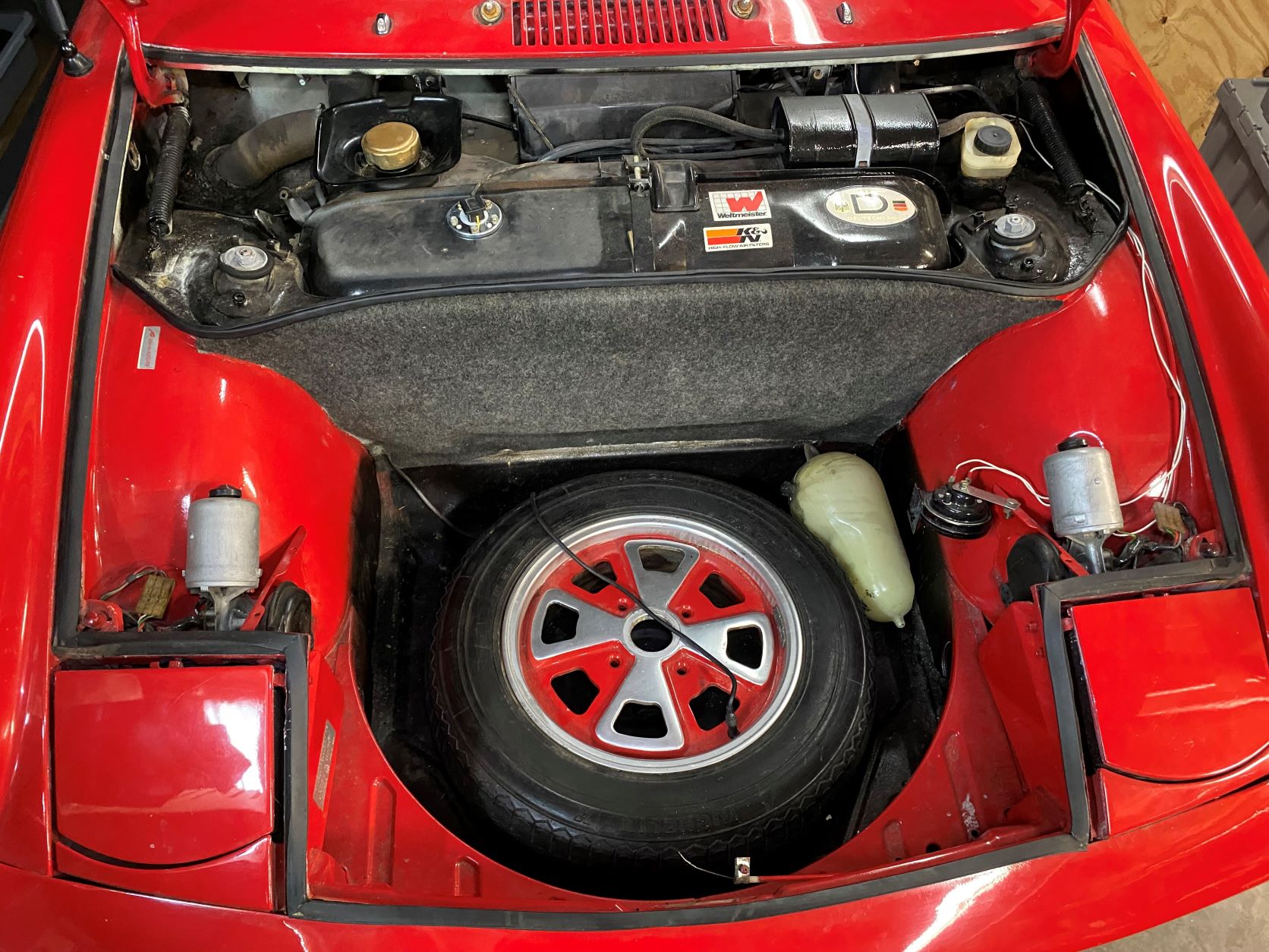

I had to put the car in the basement as my lift space is occupied by my '70E and my RSR tribute for winter storage and there is no extra room in the garage.
Attached Image Attached ImageAttached Image
All the take-off parts will be available for sale.

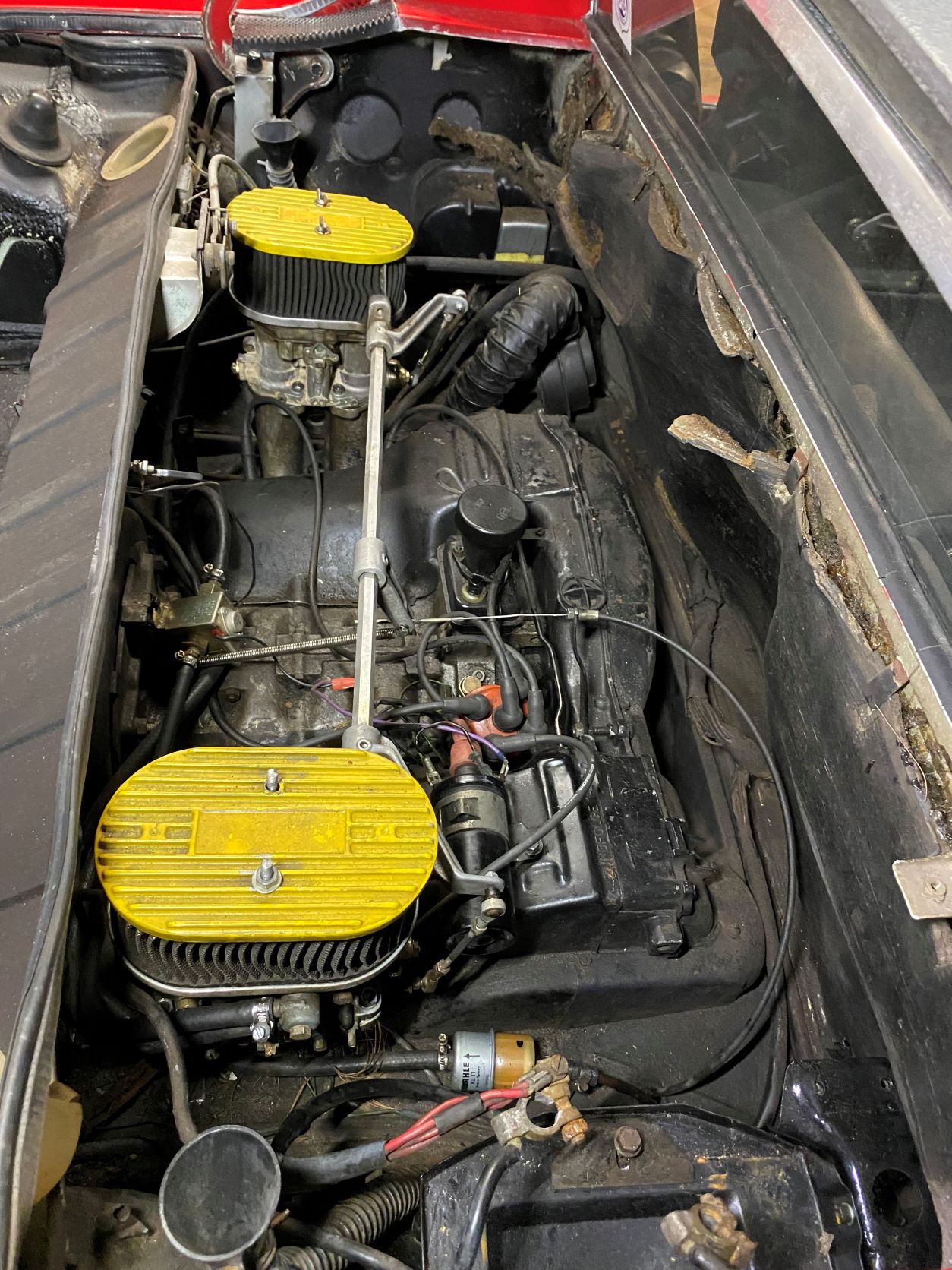

Tom1394racing   Over the past month, I have slowly been stripping ...   Feb 24 2022, 11:54 AM
Tom1394racing   More rust I think I have gone about as far as ...   Feb 24 2022, 01:27 PM
