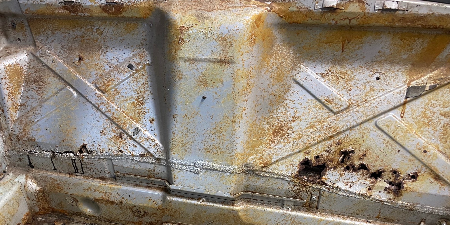

Over the past month, I have slowly been stripping the car down and discovering the rust.

Tom1394racing   More rust I think I have gone about as far as ...   Feb 24 2022, 01:27 PM
ChrisFoley   No surprises there. The CA car on my lift is worse...   Feb 24 2022, 03:37 PM
