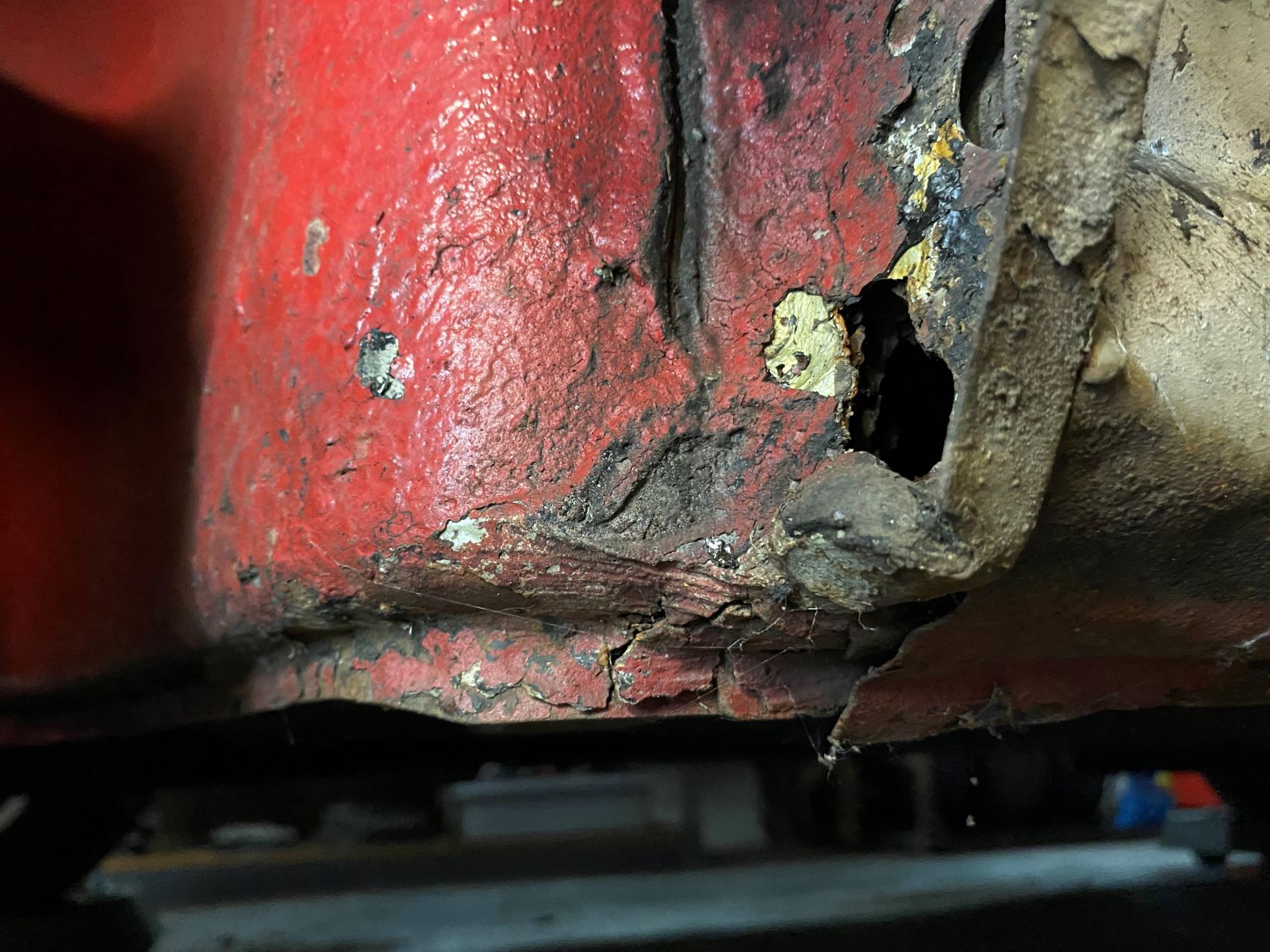

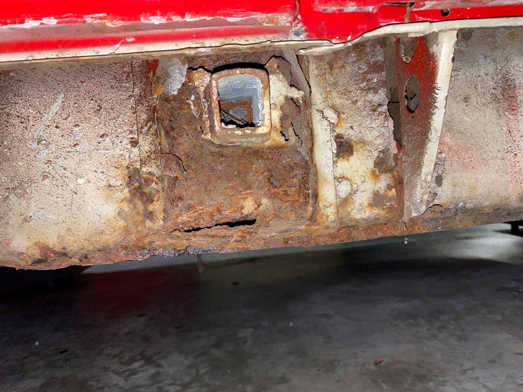

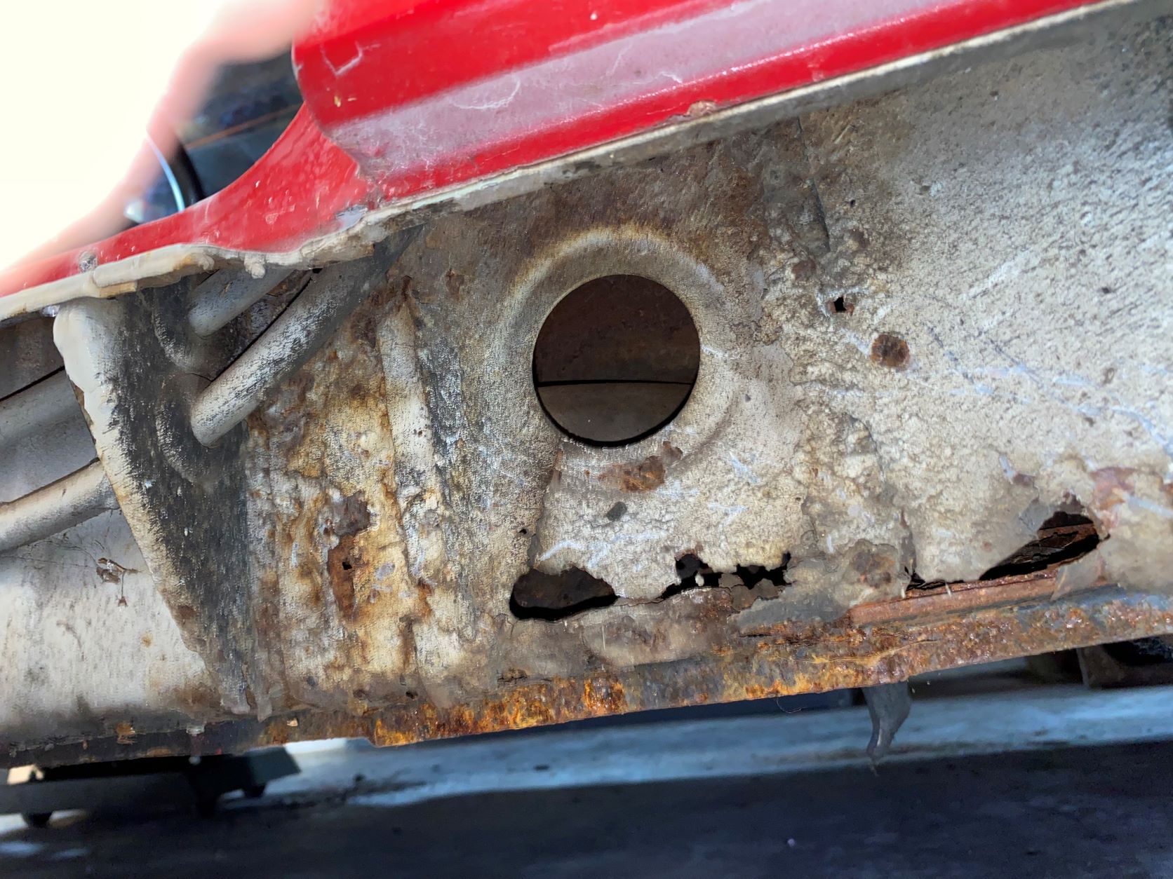

More rust
Attached Image Attached ImageAttached ImageAttached Image
I think I have gone about as far as I can with stripping the car until I move it into my garage and onto my lift. Then I can remove the engine & gearbox and the suspension and get a good look at the underside.
