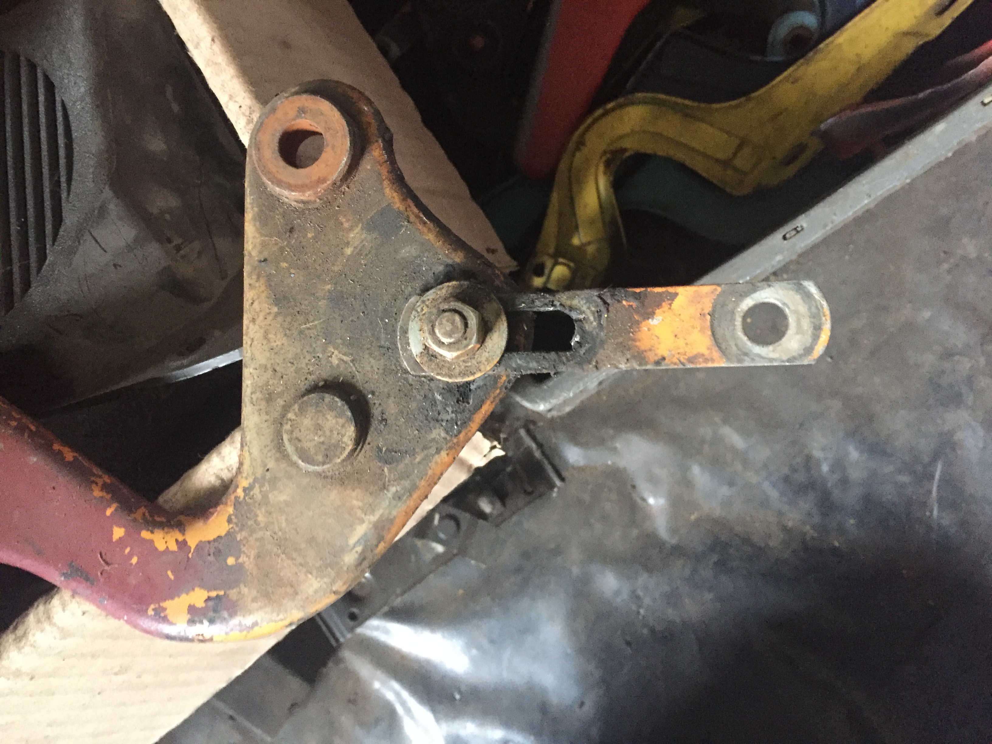

My trunk opens (& always has) into the small grill sections either side of the decklid.
rubber mark has some angled rubbers for a bracket in this area but i cannot find in google images any pictures with this bracket fitted.
Can someone show me this on their car?

Reviving an older thread. My rear trunk stops mostly before it hits the engine grill areas. I know both my stops are probably worn. I could take them off, weld a bit, grind and file and put back on.
Anyone making these? Would be nice to limit the up travel of the rear trunk. I'm worried my hand will slip just that one time.

Root_Werks   Posting an update to this thread. Pulled the limi...   May 10 2022, 11:58 AM
Root_Werks   If anyone embarks on making the strap travel short...   May 12 2022, 11:30 AM
